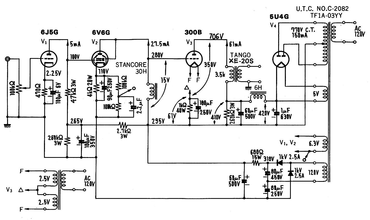

Here the bloc diagram for the mono 300B SE amplifier.
Tom: the heathers needs not more then 3A. The LiFePO4 3.3V@40Ah are garantee for 2000 cycle of charge, and discharge at 0.3C, and are developped in the USA for automotive usage!
I will calculate and simulate the HV SMPS, more to come...
  • 300B-AMP.pdf

I suggest grounding one side of the 300B filament and taking the inter-stage tranny off of ground. Feed -85 (ish) volt to the interstage trafo, thus, biasing the 300B. This would allow you to skip the cathode cap.
If you insist on having the cathode cap, I suggest running it from the cathode to the B+ supply a la Loftin-White as it shortens up the signal path considerably on the primary side of the OPT. You'll get measurably better performance.
Generating the bias tap would be trivial on your flyback trafo.
I don't see a point of battery powering the filaments. You can get very clean power with one of National's LMZ12xxx SimpleSwitchers. Been there, done that, have the T-shirt (and the good results). The thermal mass of the filaments is more than enough to ensure that any minute variation in the output voltage are averaged out.
~Tom

As you're focusing on a DC heater supply, here's an idea for testing one:
I propose that you build a basic SE using a 45 triode. A good 45 will yield very low output noise with AC driving the filament, which is usually preferred. You can get better than 80dB s/n referenced to 1-watt output with a good 45 and proper circuit. Once you have an idea on how it sounds, you can switch over to your proposed DC heater supply and do some testing to see if you hear any difference (and then determine if the difference is good or bad).
The (WE)300B requires a DC supply as it uses a center-tapped filament and is pretty much impossible to obtain output noise at an acceptable level with AC. The fact that it is a center-tapped filament, you should (as noted earlier) think about using one end of the filament as the cathode connection and letting the other end float. For biasing points, you may want to consult the original Western Electric documentation here:
Western Electric
For driving the 300B, consider an interstage transformer topology as I think you will get the best results with a properly designed circuit. You can also take a look at these links for numerous SE amplifiers including many 300B designs:

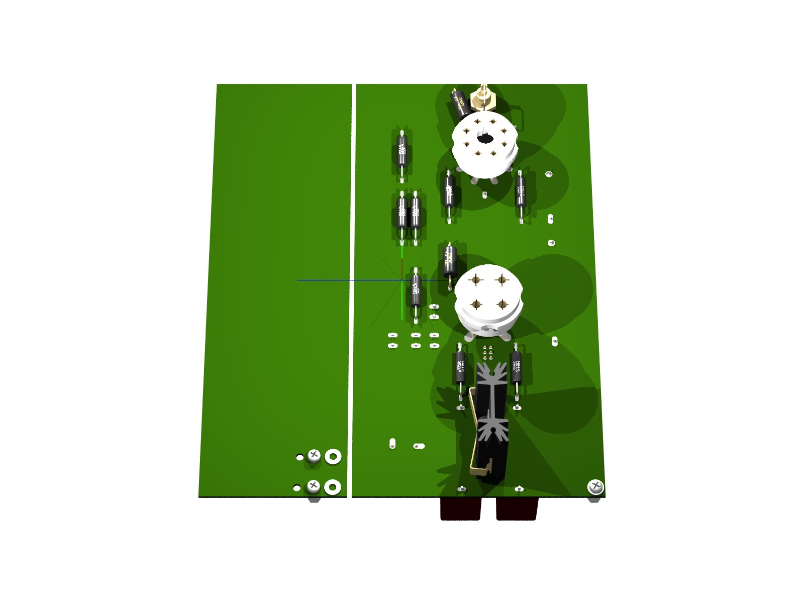

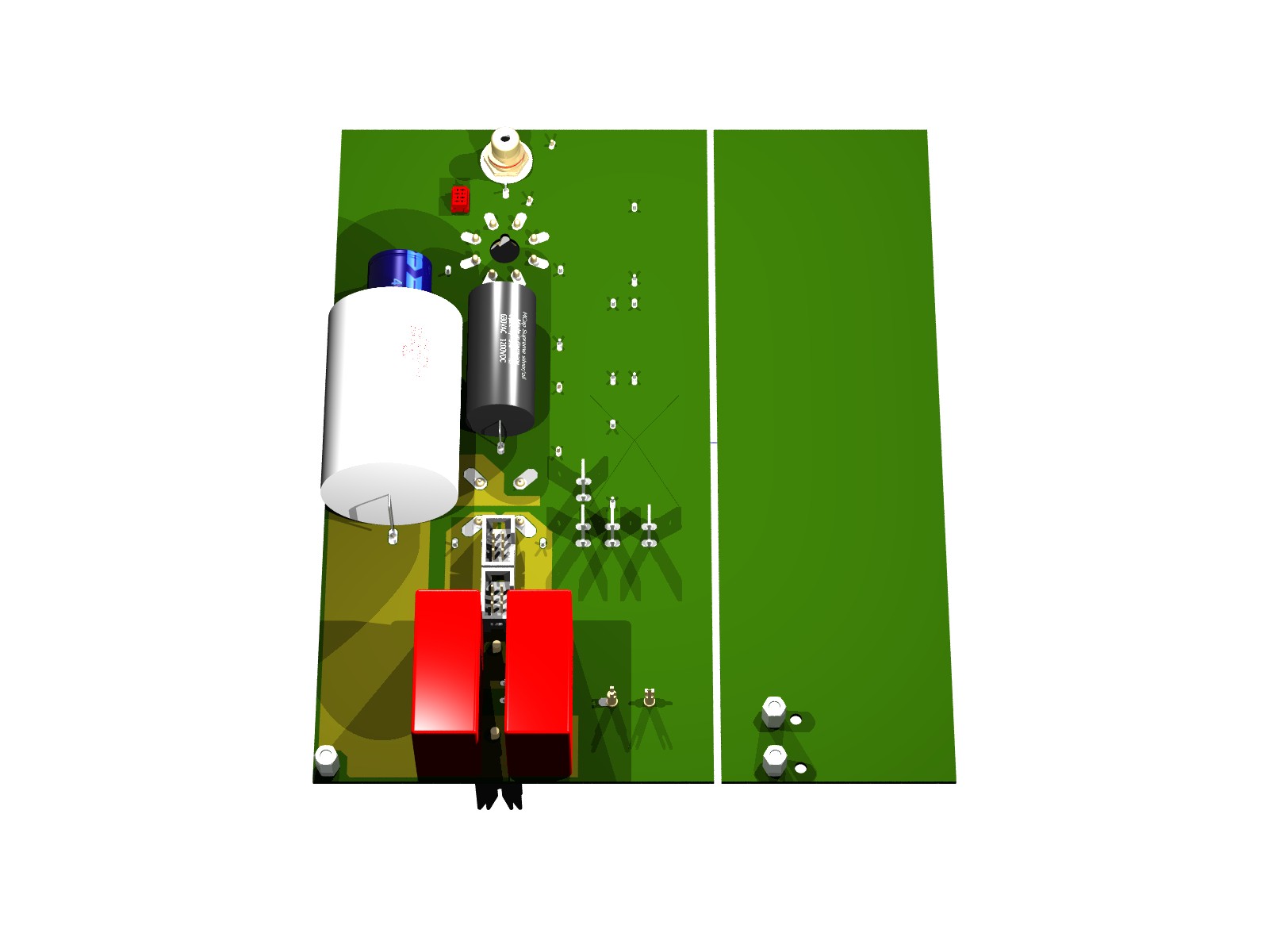

Attached, the first printed circuit board for the battery board...
... and the 300B testboards avancement.
