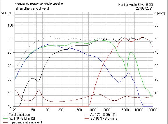

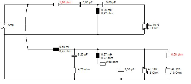

Is that a 2.5 way still, 3rd order on the tweeter, 2nd on upper woofer with zobel to tweeter, and 2nd to lower woofer no zobel? What are the crossover points?
FYI, I measured the tweeter's Fs and it's ~800hz, give or take 20

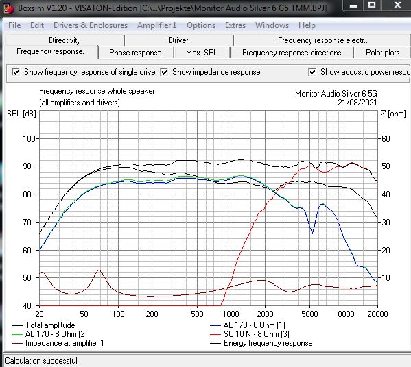

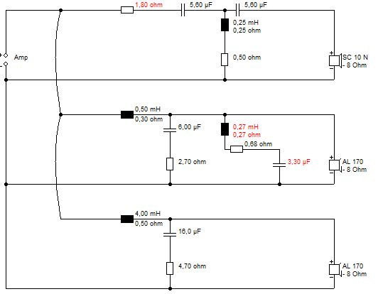

Here it is. Provided the midbasses are identical, we can convert the 2.5 way to TMM. No worse on impedance. In practice, it will work better than this, because my test metal AL170 drivers need a 6kHz notch, not 5kHz.
In 2.5 way form, there is a case to be made for notching the bass in the same way as the midbass. In TMM form, the notch should be 0.13mH/0.68R/6.6uF to get the right Q, but the original shouldn't be too bad. But not hard to unwind a coil. Notice I get positive polarity on the tweeter, unlike your PDF.
I make that a 4dB reduction in bass at one point. Might help.

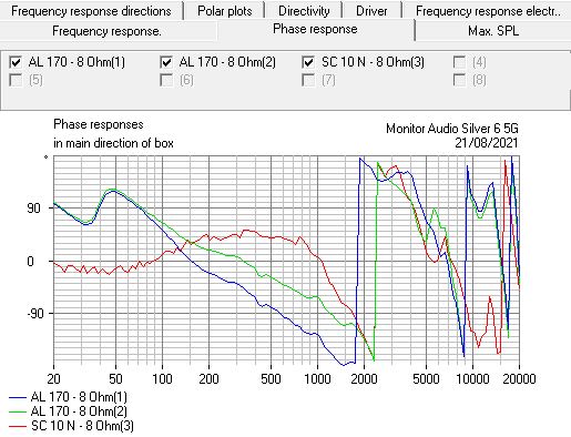

Ah, well done! Did you check for positive tweeter polarity, by the way? I found a discrepancy with the official circuit diagram... 😕

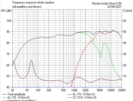

I ran a sim of your arrangement disconnecting the bass which you initially preferred. There is some risk in merely disconnecting a bass, it is better to disconnect before the crossover. Otherwise you get low impedance because the crossover becomes an undamped LCR shunt. The solid line versus the dotted impedance line. A commercial designer thinks about fault conditions leading to amp damage.
Bass in wrong polarity is dramatically wrong and lacking in bass. The second image. I would have heard that and the phasiness and diffuse imaging.

But what we have here is a biwireable input and a fairly competent 2.5 way:

If the two basses are in wrong polarity, it is the bass that suffers, not the midrange! A wrongly wired tweeter would impact the midrange. 😕
976831d1629627312-monitor-audio-silver-6-g5-monitor-audio-silver-6-bass-phase-fr-jpg
