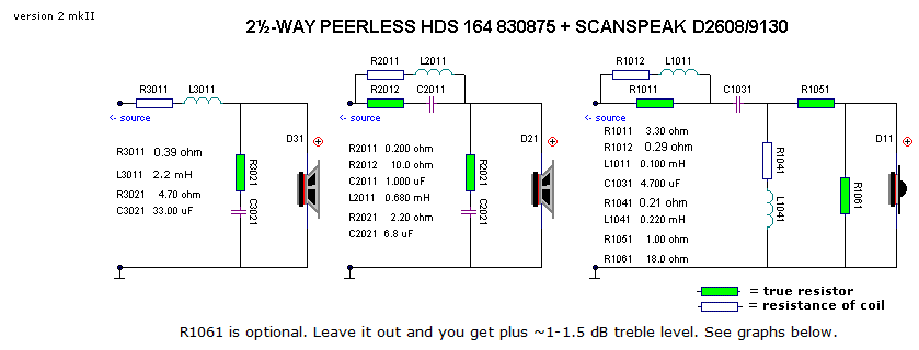

Is that a 2.5 way still, 3rd order on the tweeter, 2nd on upper woofer with zobel to tweeter, and 2nd to lower woofer no zobel? What are the crossover points?

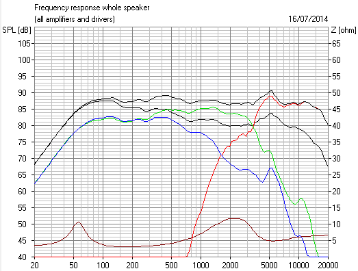

Here it is. Provided the midbasses are identical, we can convert the 2.5 way to TMM. No worse on impedance. In practice, it will work better than this, because my test metal AL170 drivers need a 6kHz notch, not 5kHz.
In 2.5 way form, there is a case to be made for notching the bass in the same way as the midbass. In TMM form, the notch should be 0.13mH/0.68R/6.6uF to get the right Q, but the original shouldn't be too bad. But not hard to unwind a coil. Notice I get positive polarity on the tweeter, unlike your PDF.
I make that a 4dB reduction in bass at one point. Might help.

I ran a sim of your arrangement disconnecting the bass which you initially preferred. There is some risk in merely disconnecting a bass, it is better to disconnect before the crossover. Otherwise you get low impedance because the crossover becomes an undamped LCR shunt. The solid line versus the dotted impedance line. A commercial designer thinks about fault conditions leading to amp damage.
Bass in wrong polarity is dramatically wrong and lacking in bass. The second image. I would have heard that and the phasiness and diffuse imaging.

I had a look at your crossover and find little wrong with it. No need for snake-oil resistors or exotic capacitors here. Ferrite coils are OK too, unless you want to spend big bucks on aircoils. In fact ferrites are the only crossover components that are measureably worse than aircoils. The rest is snake-oil! 😀

But what we have here is a biwireable input and a fairly competent 2.5 way:
That old 1.5V battery and paperclip can tell us about the relative polarity on the basses. They both should move forward on application of the battery +ve to +ve on the speaker input.
The tweeter polarity needs more thought. I would separate the tweeter input at the biwireable terminals and run a wire from the -ve to the tweeter. Now use your multimeter between that wire and either of the two tweeter terminals.
The earthy side of the tweeter will measure near zero ohms. The live side will be near 3-6 ohms. You will be hoping the live side is the red or positive marks on the tweeter, if my modelling is right.
