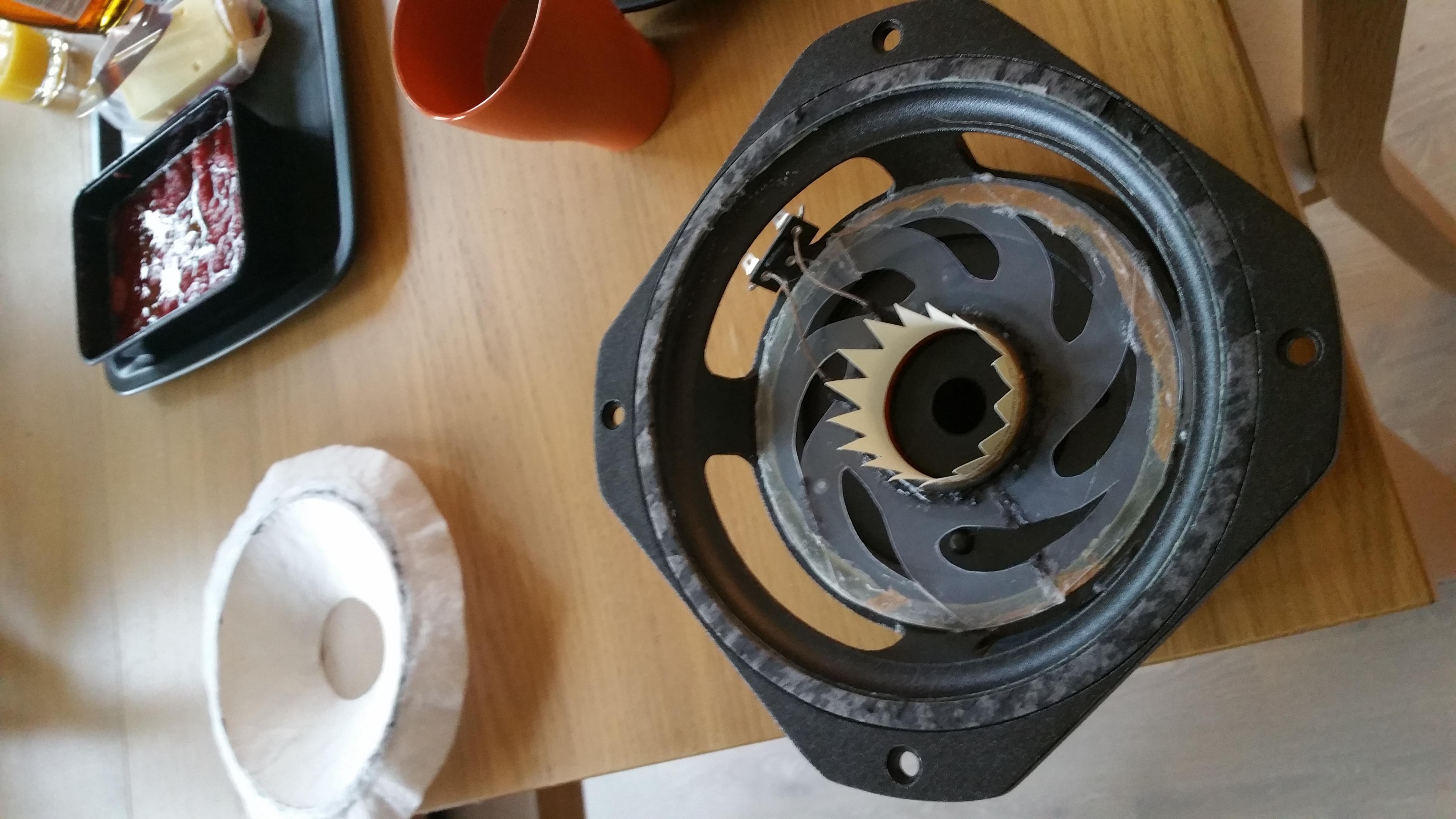

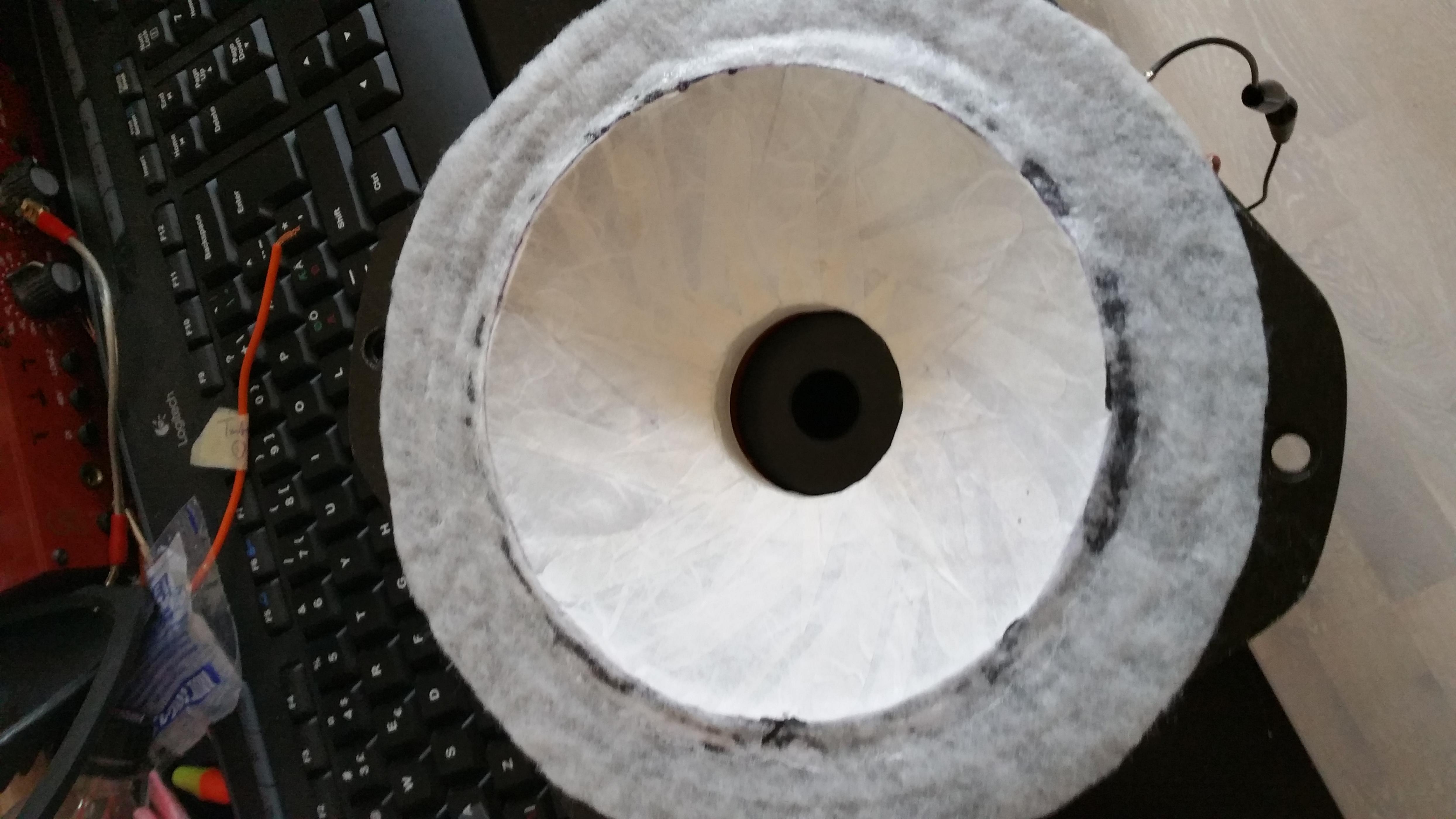

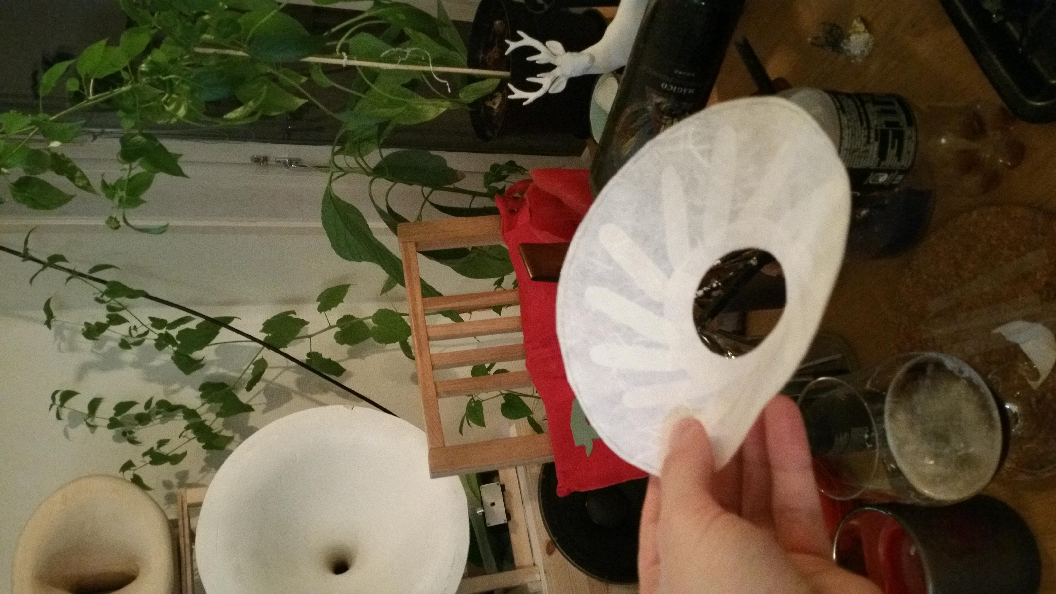

I am currently trying to make my own cone for a midrange speaker. I am using the Eminence Delta 8A that had a rather dull sound from its cardboard-looking cone. I replaced the cone yesterday with a cone made of very thin paper with long fibers of 25 gram per 10 sheets of A4. The paper is almost transparent and even if it sounded better with more detail in the midrange, the cone was to fragile. I tried to glue ribbons of the paper and it improved but it still sounds a bit frizzy, especially when highpassed below 200Hz. I don't think gluing more paper ribbons on top of an existing cone is a good approach, so I am now trying to use the same type of paper to mold my own cone against a cone mold. The Eminence has a 14 Tesla-Meters BL and does play pretty good deep midbass for PA 8" mid driver. I am cincerned that the voice coil is a bit too heavy to be used as a widerange, almost fullrange. Goal is to make a midrange that is super clear between 200Hz-2500Hz, with a nicer tone than from the usual cardboard paper.

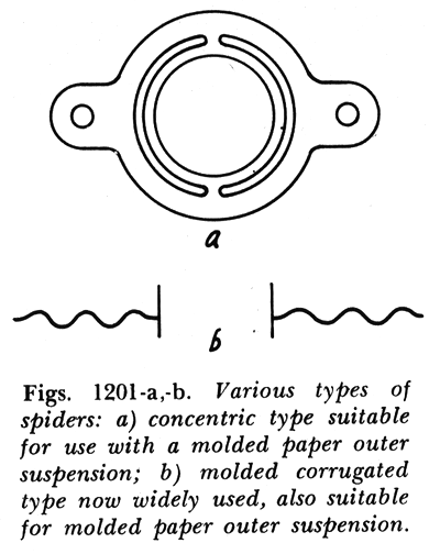

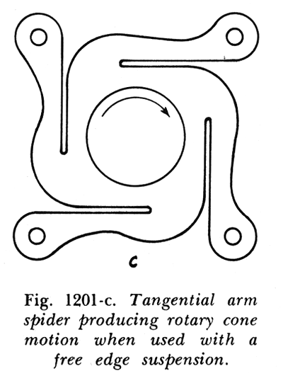

Also, you can make spider, something like these:
