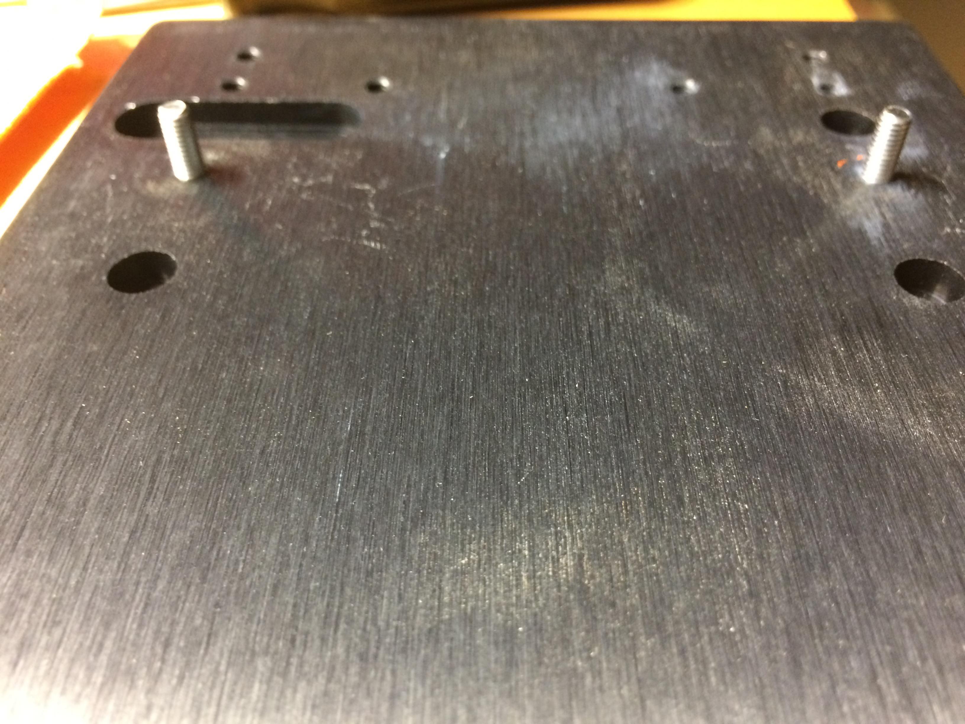

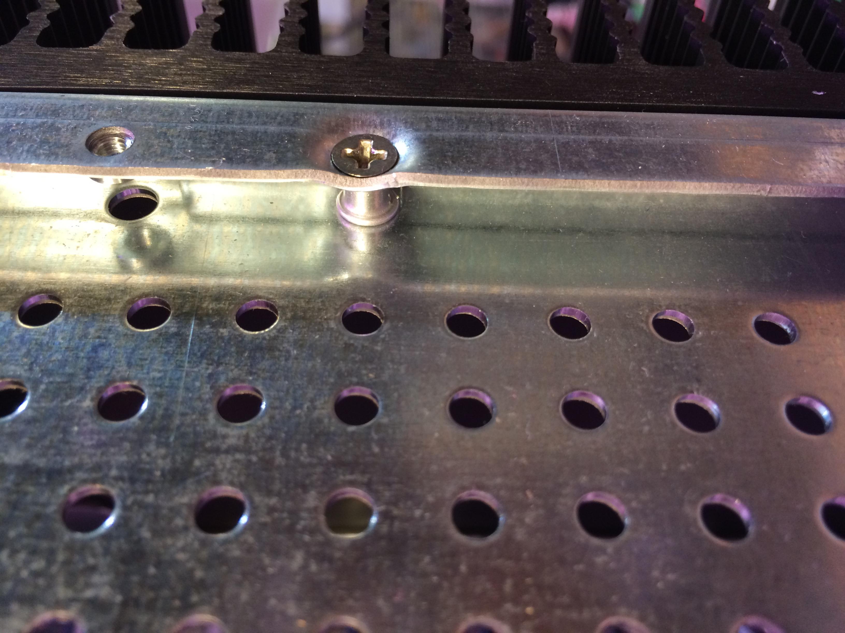

I have a 3ux300mm dissipante and ran into similar issues with attaching the pierced base plate/pan to the heatsink brackets and the front panel.
My solution was
1) to use a 6-32 riv-nut on the pan since that is all I had
2) to use a threaded stud ( cut the head off a long M4 screw) inserted into the front panel. Use a flat washer and nut to attach to the HS bracket.

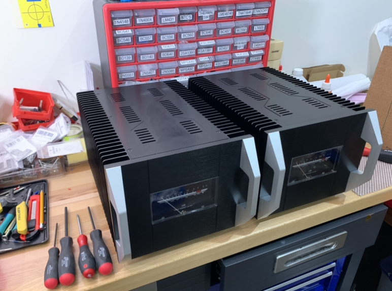

Another option is to use fully CNC’d aluminum cases from AliExpress. They fit together perfectly and many use exposed front socket hex cap screws. I have had excellent results with several cases from different vendors. The last one I got used a clever side access socket cap screws from the heatsink to attach the front panel. It lets you fully assemble or disassemble the chassis without needing access to any internal screws or nuts.
These are monoblocks for my next 100W Class A amp.

A couple of pics showing my simple mods.
In my case since I am using the chassis for a new design I was assembling and pulling apart a few times so I had enough and did a simple mod to make my life at least easier and not require flexible shaft drivers etc.
Image that, they used a PEM right beside my Aluminum riv-nut 🙂
Also not much on those top and bottom plate mm hex head screws. I wonder how many folks from the US need to go out and buy mm hex allen keys etc?
Other than that, I am content to specify the chassis for construction of a power amp. Although I still have to finish off with the bits that attach to the front and back, details details ...
