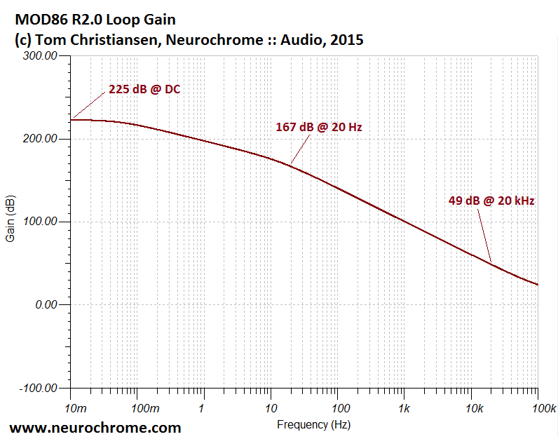

Note that the Mod-86 is a composite. There is 150dB of open loop gain and that output stage is in the feedback loop. You have to bear this in mind. For normal chip amp discussions there are other threads....
Yep. The LM3886 sees an additional 95 dB of loop gain due to its local loop, so the total loop gain applied to error-correct the LM3886 is approaching 250 dB.

at what range of frequencies?......................the total loop gain applied to error-correct the LM3886 is approaching 250 dB............
DC to 1Hz ?
or 0.1Hz to 1kHz?
or at 20kHz?
Andrew, it is quite easy to calculate for yourself. Specsheets are freely available on the interwebs. Just multiply the open loop gain at the frequency of interest of both devices. For example, this would give you 120 dB @ 20KHz. Divide this gain by the closed loop gain and you know how much is available for error correction.
If the feedback is single pole, then it is indeed fairly easy to model the open loop gain response.
But I doubt this composite is a single pole roll-off.
BTW, "fairly easy" starts by identifying the zero dB gain crossover frequency and working back via the 6dB/octave or 20dB/decade.
Do we know the gain crossover frequency?

Post 734 " At DC, the loop gain of the Modulus-86 is about 250 dB. At 20 kHz, the loop gain is 47 dB, rolling off at -20 dB/dec." But you have argued this point with Tom at least once before. Any chance you can state your issue with the numbers clearly enough that we can put this one to bed? Is it just the number of poles in the roll off you want to know?
Andrew, this is so elementary that I don't know where to begin. Both LM4562 and LM3886 have gain phase graphs in their specsheets. Because of their importance, they are typically placed towards the end, fig. 106 here http://www.ti.com/lit/ds/symlink/lm4562.pdf. It has about 70 dB gain @ 20 Khz. Do the same for the LM3886, multiply the gains (since I don't know where to begin: dB is logarithmic so addition of the dB figures is multiplication of the gain). Presto.
I would assume Tom placed a pole in the feedback loop to limit gain above some sensible frequency. It is not relevant to any point you might wish to make, since the nature of such pole is that it will increase feedback and thereby limit gain. In other words, above this sensible frequency, the decline of feedback with frequency is halted or minimized.
Yep. That's exactly how a composite amp works. Then you take the feedback gain into account to arrive at the total loop gain.
Several, actually... I tossed in a zero for good measure as well. 🙂 In the MOD86 R2.0, I use three types of compensation to maximize the loop gain while keeping the amplifier stable. Ensuring that the overall amplifier would be stable across varying load conditions was not an easy task. It's simple in theory, but man... there're a lot of gotchas in the process. I got to know the LM3886 rather intimately in the process.

Now I come to WHY I asked the question:
The stated value that "loop gain approaching 250dB" implies that the errors are being reduced by approaching 250dB. That's the way global negative feedback works. It reduces noise and distortion and changes effective impedances in proportion to the amount of loop gain.
If the loop gain is that high at 0.1Hz, then the error at 0.1Hz would potentially be reduced by approaching 250dB.
What would be the error reducing effect at 20Hz, for a DC gain of nearly 250dB. There is little correlation.
At 1000Hz the potential error correcting effect is again very different from what is available at 0.1Hz.
I don't know what error reducing potential is available at any of the audio frequencies.
That is why I felt the need to ask.

When has a loop gain nearing 250 dB at DC ever meant that errors are being reduced by 250 dB? That might be the case down at 5-10 dB of loop gain, but that ship sailed a long, long, long time ago at 250 dB (DC). Especially when we're talking about crossover errors (gain drops). Noise and other pernicious non-linearities will dominate down at the level of THD+N that Tom is measuring.
As far as useful loop gain, we can, to a first order look at figure 49 in the LM3886 datasheet (having been pouring over the TDA7293, TI/National's datasheets are incredible!), and figure 107 of LME49720 (curiously missing from the 710 datasheet), you can see the loop gain vs frequency (100 hz on up). Add said gains together, subtract 20 (closed loop gain of 10), and you have, to a rough degree at audio frequencies, the amount of loop gain.
Hopefully, we can put this one to bed now... The results of the loop gain simulation attached.
It turns out the 250 dB that I had in my head was incorrect. The actual number is 225 dB. Sorry about that. I simply misremembered.
The plot shows the total loop gain applied to the LM3886 as function of frequency. The compensation schemes kick in above 100 kHz ensuring a phase margin above 80 º.
Tom
Composite amps like this do hell reduce error, similar to adding an integrator in a control system. The whole discussion around the data sheets are getting confusing. But so far what have been covered in the design seem good. What have not been covered probably will not happen in a short time.
