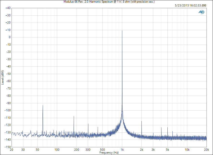

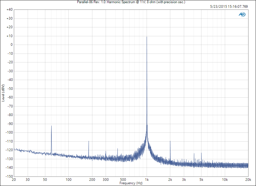

As suggested quite a while ago, I measured the THD using an oscillator that's even better than that of the APx525. The harmonics of the oscillator are a good 140-145 dB down, which makes it possible to get a true THD measurement for the Parallel-86.
The THD at 1 W, 8 Ω, 1 kHz measures 0.00012 % (-119 dB). Note that the oscillator adds a bit of mains hum, hence, the mains components (60, 180, 300, 420 Hz) are a good 10-20 dB higher than the residual mains hum of the amp itself.
Tom

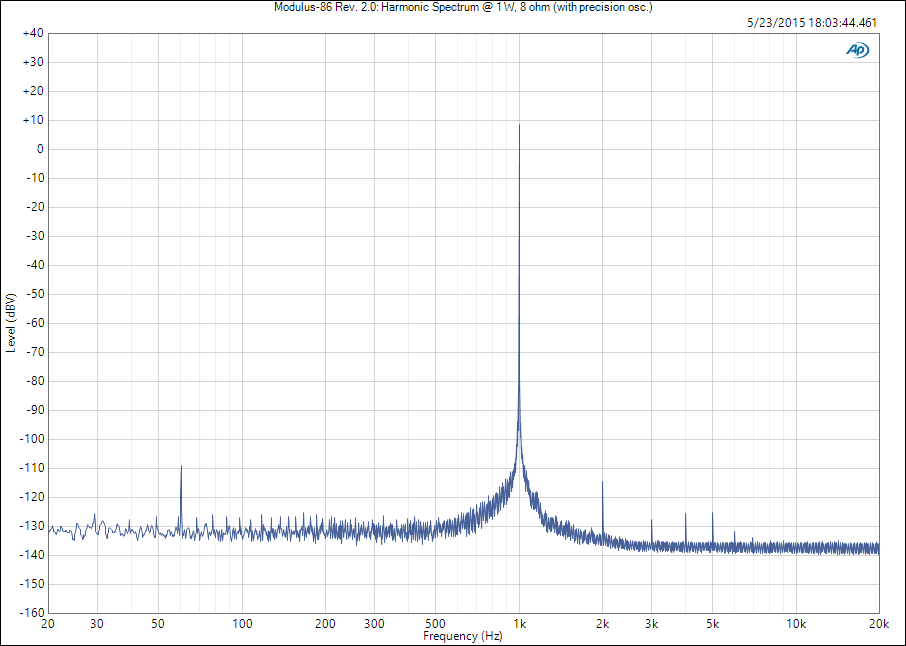

...and now battery powered. Same 0.000067 % THD.
I suspect the remaining 60 Hz is a ground loop. The grounding of that oscillator could be better. The hash in the noise floor below 1 kHz and the slightly higher noise floor below 1 kHz are caused by the oscillator as well.
Tom

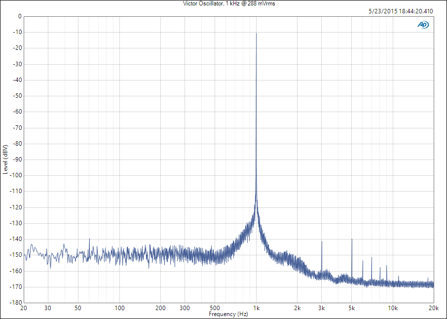

Here's the precision oscillator I used. I think it's from a DIY Audio member, actually. I found it on eBay (following the recommendations of a DIYA member).
The THD in this measurement is limited by the THD of the ADC of the APx525 (-130 dB THD). To measure the THD of the oscillator itself, a precision notch filter is needed to reduce the 1 kHz fundamental. I've seen measurements done this way that back up Victor's claims of harmonics below -145 dBc.
Tom
