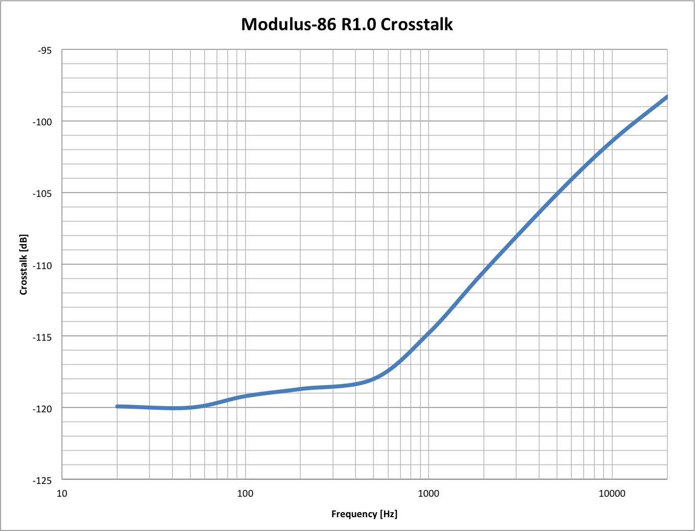

The Modulus-86 once again pushes the limits of the APx525. It turns out the crosstalk is measured by measuring the RMS voltage on the two channels and computing the ratio. This works well if the crosstalk is significantly above the noise floor. For the MOD86, that is not the case. The crosstalk components are only about 10-15 dB above the noise floor, hence, the AP reports a pessimistic figure for the crosstalk.
I performed FFTs with input signals of 20, 50, 100, 200, 500, 1k, 2k, 5k, 10k, and 20k Hz and measured the crosstalk manually from the FFT. Result attached.
