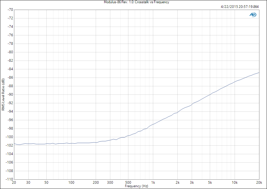

The long-awaited crosstalk measurement attached. I decided to use the prototype setup I've had running in my living room for the past couple of months for this measurement. I did absolutely nothing to tidy the layout. It's just two MOD86 R1.0 boards on a 0.4 K/W heat sink with a Power-86 off to the side.
The crosstalk measurement for MOD86 R2.0 and PAR86 R1.0 will need to wait until I get more channels built.
Nearly -102 dB crosstalk below 200 Hz. -97 dB @ 1 kHz, -85 dB @ 20 kHz. Pretty impressive if I may say so.
