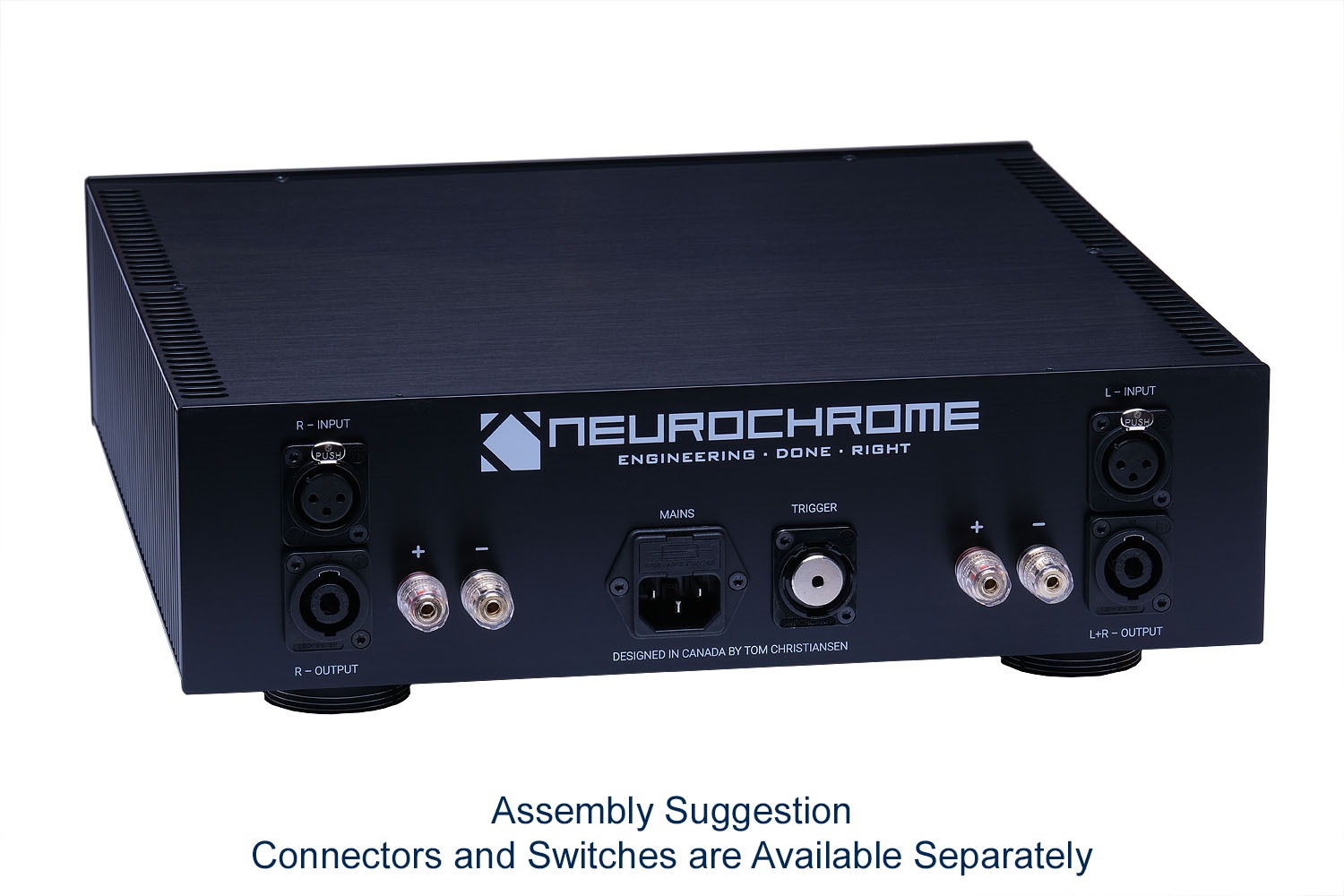

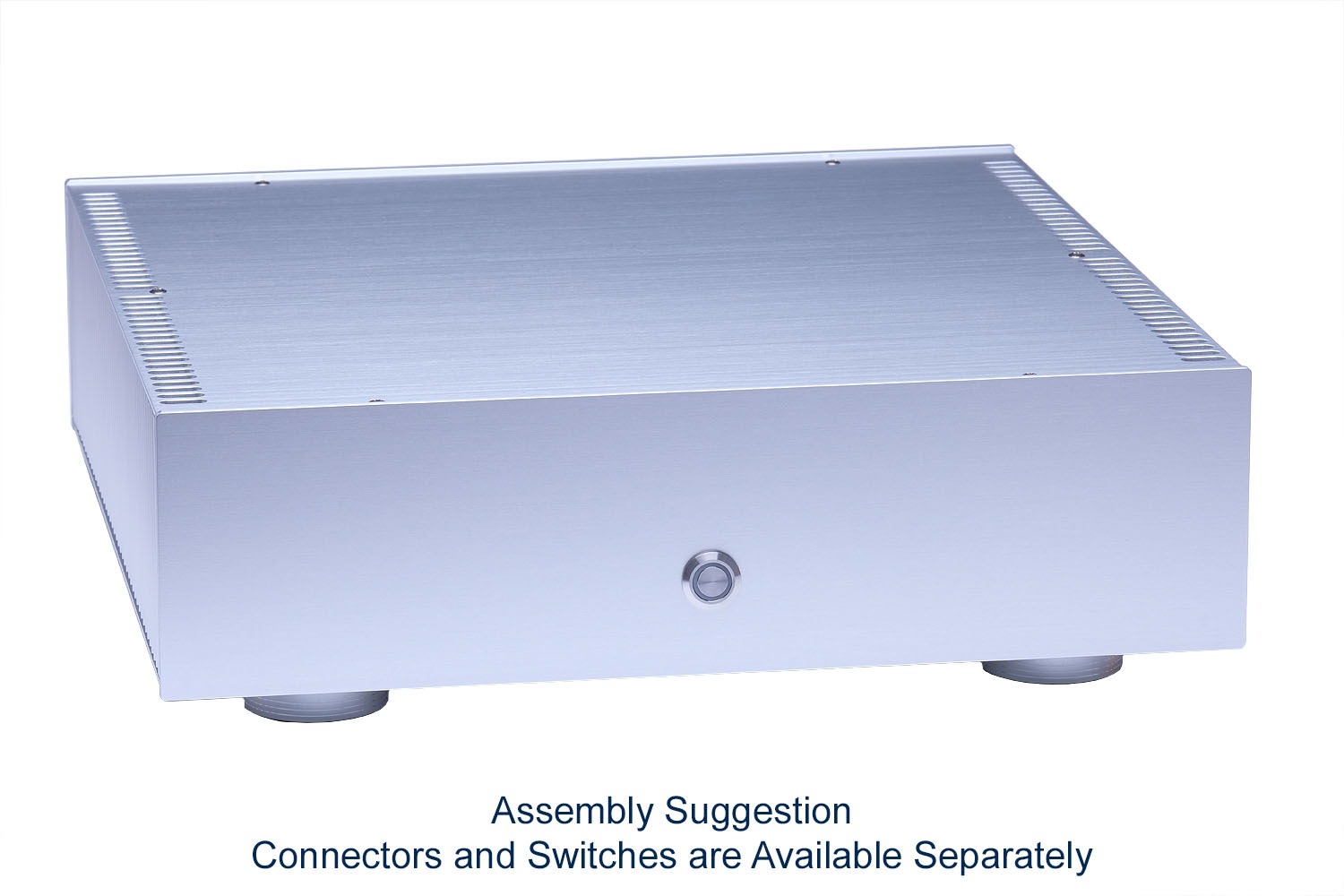

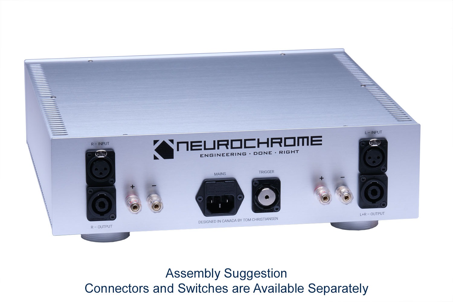

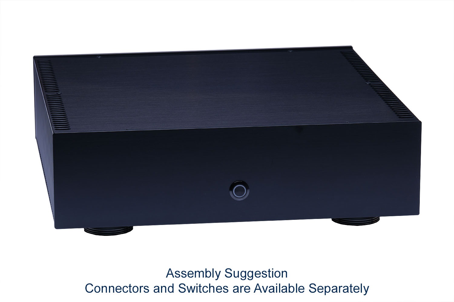

I will definitely order more chassis. In fact, I just heard back from the manufacturer that they'll provide a quote for the design I submitted on Saturday night. The new revision will have mounting holes for the Guardian-86 Rev. 2.0 and will also have holes in the bottom panel for the Connex SMPS300REh. Those changes aside, it'll be identical to the one currently shown on my website: https://neurochrome.com/collections/connectors-parts/products/modulus-chassis It'll be available in both black and "silver" (i.e., clear anodized aluminum).
The Modulus Chassis supports a stereo build of the Modulus-86, 186, or 286 powered by a Power-86, Power-686, or Connex SMPS300REh with (optional) speaker protection by the Guardian-86 Rev. 2.0 and the mains power controlled by an Intelligent Soft Start. Unfortunately the heat sinks are not efficient enough for the Modulus-686.
The only unknowns regarding the chassis at this point are the price and the delivery date. I expect to have those within the next few days and will update my website with this information. You're more than welcome to place a backorder before then. I'll honour the old pricing until I know the new price (which given what's going on in the world will likely be higher). My best guess is that I'll be able to ship the chassis in early/mid December, so if you want one in time for the holidays I suggest choosing FedEx or UPS for the shipping option.

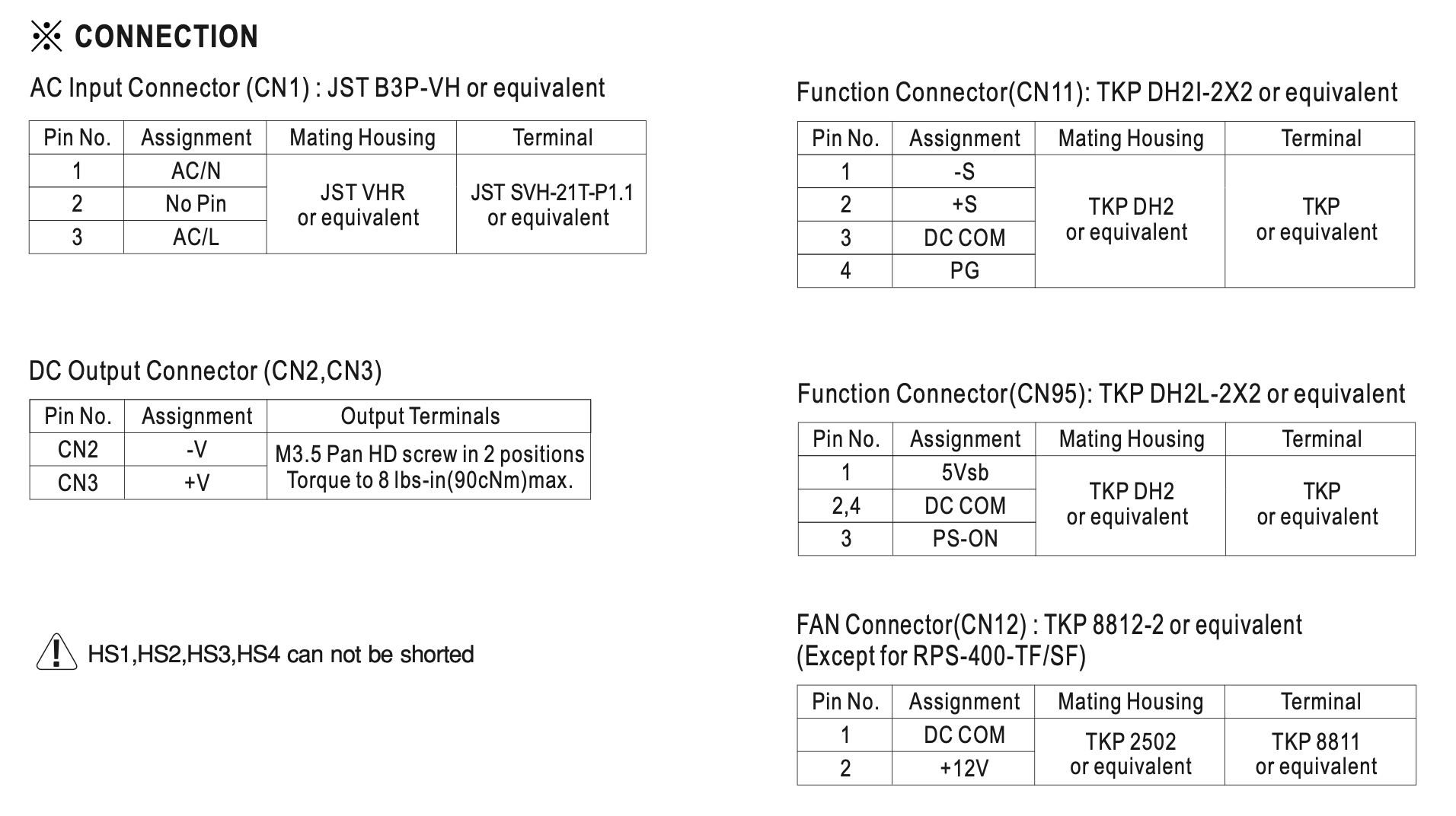

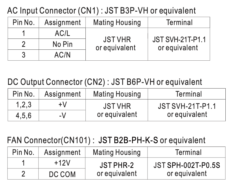

Hello All,
I received here a pair of mean well RPS-200-27-C power supplies.
Will someone help identify the brand and part numbers for the push on connectors for the AC power input and the push on muiti pin connector for the DC output? It could be Molex or what ever brand?
Thanks DT

From the last page of the RPS-200 data sheet:
And for those who use the RPS-400-27(-C), here are the connectors:
If I recall correctly, the Hirose DF11 works for the 4-pin connectors as well.
Digikey carries the JST connectors. There's an equivalent by TE that's available at Mouser. Both Mouser and Digikey carry the Hirose connectors, though I seem to recall that they're being obsoleted.
