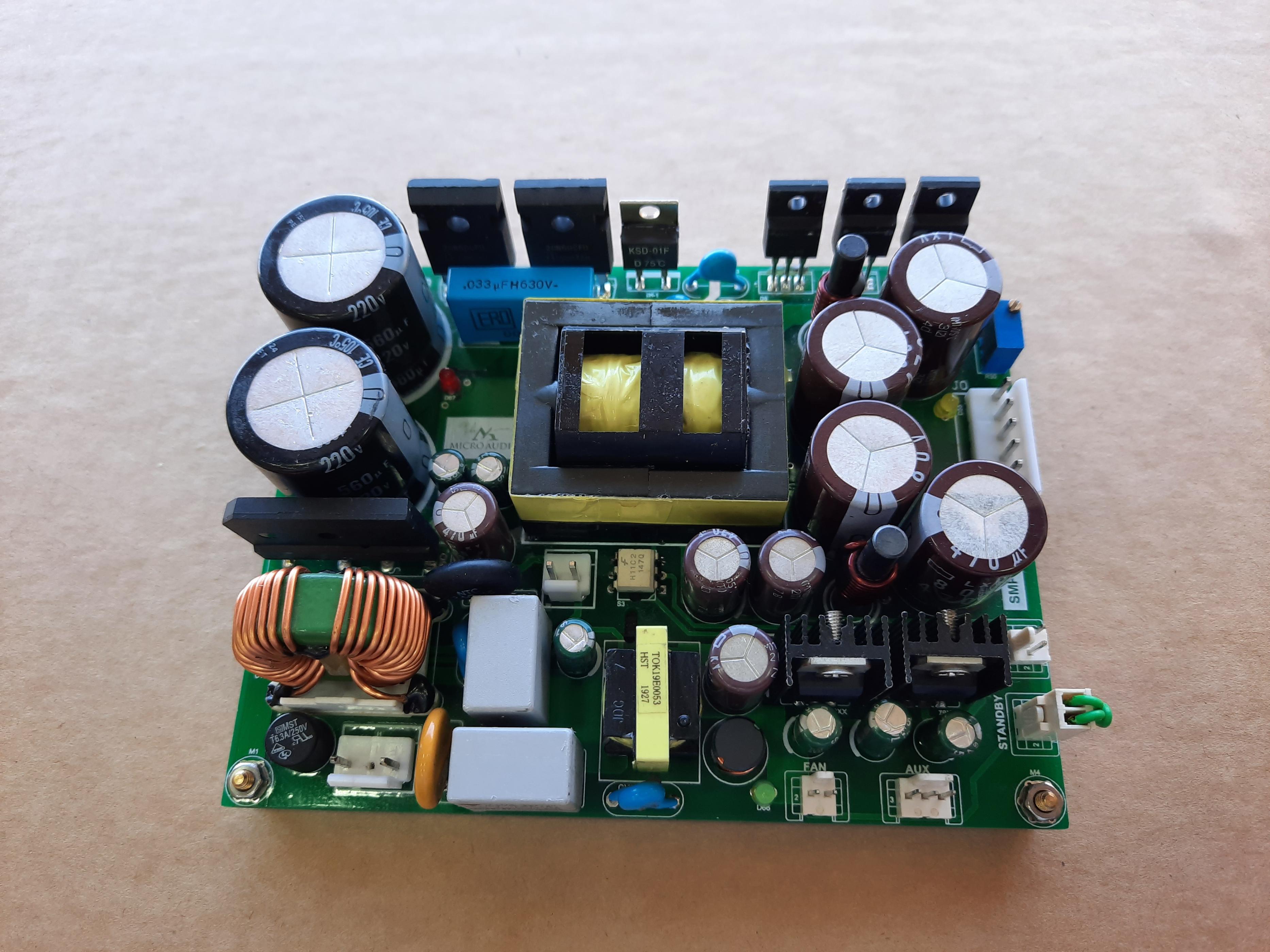

If you are not in a rush, I might be able to deliver your order on time, with express shipping to Canada (4 Days) @ 55$ for two units.
Attached is what you will get, Still missing the L-Shape heatsink
The only available voltage is +-35VDC.
* Stand by SMPS
* Standby switch
* DC Error input
Thanks!
What is this supposed to mean?Buy one and you will find out.
Here's an idea: How about you start your own thread or website advertising these?
Another idea would be that you shipped me a free sample so I could test it with my amps. If I like it, I'll recommend it. Do note that I also take customer service into account when I make recommendations. "Buy one and find out" is not likely to get you high on my list of recommendations. Just saying...

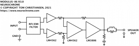

Since its inception in 2014 the Modulus-86 has set the bar for low distortion DIY power amplifiers. The circuit has remained largely unchanged since the introduction of Rev. 2.0 in February of 2015.
Modulus-86 Rev. 3.0 represents a major design update. The input stage of the amp has been completely redesigned and now uses an LM4562 for even lower noise and distortion. The composite power amplifier section is now a differential amplifier and the DC servo has been eliminated. Modulus-86 Rev. 3.0 achieves state-of-the-art DC performance by other means.
The build cost is also lower. The parts necessary to populate the Modulus-86 Rev. 3.0 circuit board will set you back $50 per board or about 16% less than Rev. 2.4.
The new PCB layout uses four copper layers for better performance and improved routing. The board is the same size as previous versions (90 × 70 mm) and is now easier to mount in a chassis thanks to the added mounting brackets. All wiring now exit along the longer board edge, which makes it easier to mount multiple Modulus-86 on the same heat sink.

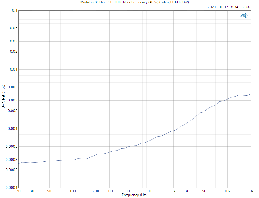

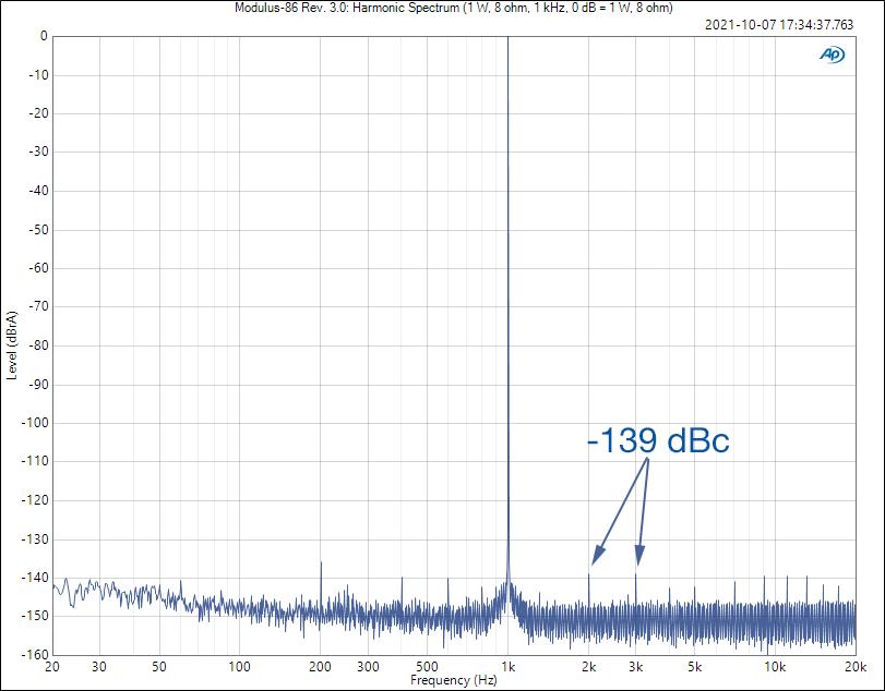

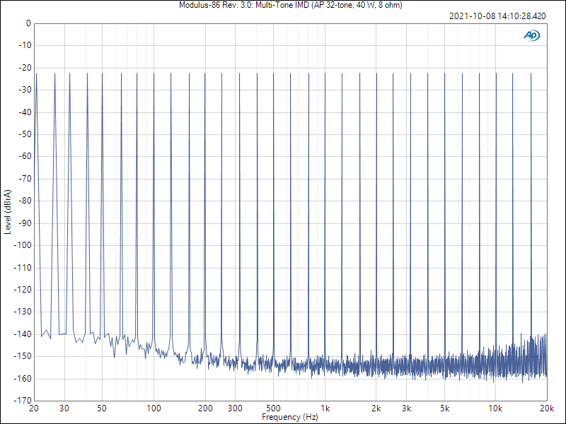

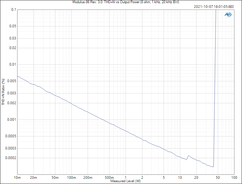

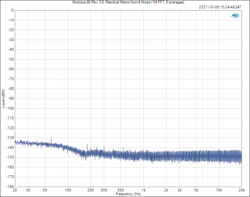

The Modulus-86 Rev. 3.0 is now shipping. You can buy yours here: Modulus-86: DIY 65W power amplifier achieving – Neurochrome
You will also find a comprehensive set of measurements in the Performance Graphs tab of that page.

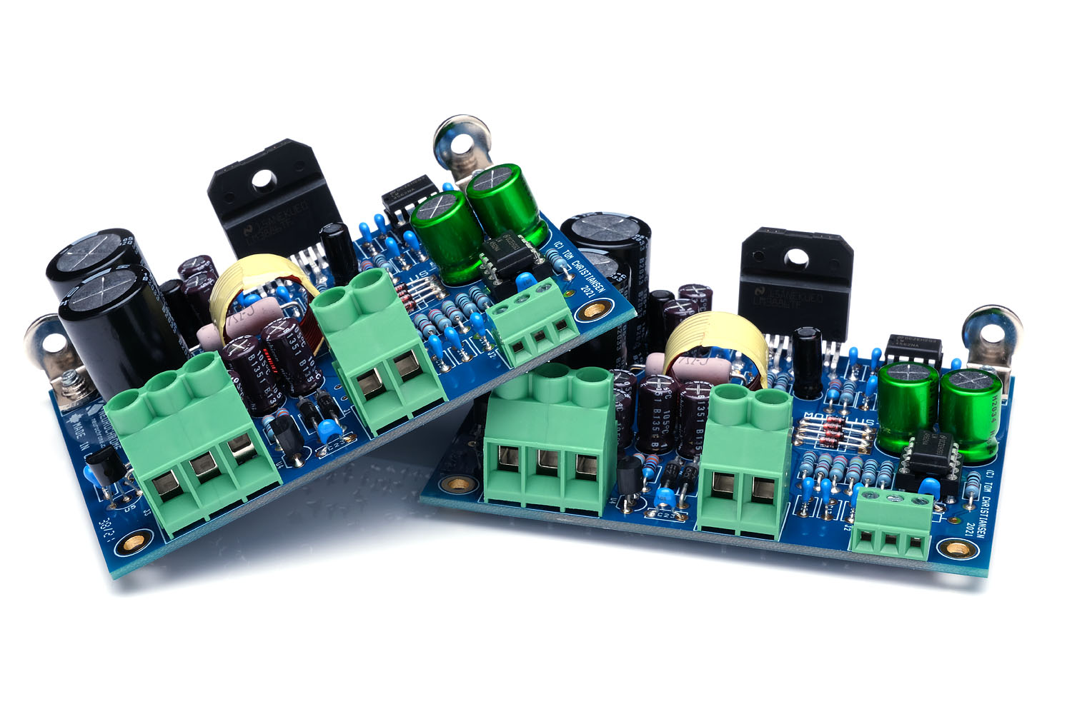

The boards are gold-plated, RoHS compatible, and made in Canada. All unpopulated Neurochrome PCBs are fully electrically tested by the manufacturer to ensure that they will work well in your hands.

A_Modulus-86 Rev. 3.0_ Harmonic Spectrum (1 W, 8 ohm, 1 kHz, 0 dB = 1 W, 8 ohm).png51.5 KB · Views: 616
Modulus-86 Rev. 3.0_ Multi-Tone IMD (AP 32-tone, 40 W, 8 ohm).png55.8 KB · Views: 514
Modulus-86 Rev. 3.0_ THD+N vs Output Power (8 ohm, 1 kHz, 20 kHz BW).PNG53.2 KB · Views: 484
Modulus-86 Rev. 3.0_ THD+N vs Frequency (40 W, 8 ohm, 60 kHz BW).PNG38.5 KB · Views: 365
Modulus-86 Rev. 3.0_ Residual Mains Hum & Noise (1M FFT, 8 averages).png41.2 KB · Views: 413
