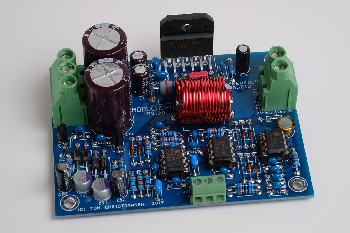

Just letting everyone know that the Modulus-86 Rev. 2.2 (hot off the press) is on summer sale through August. As are a bunch of my other products. Time to stock up for the winter builds.
Tom
