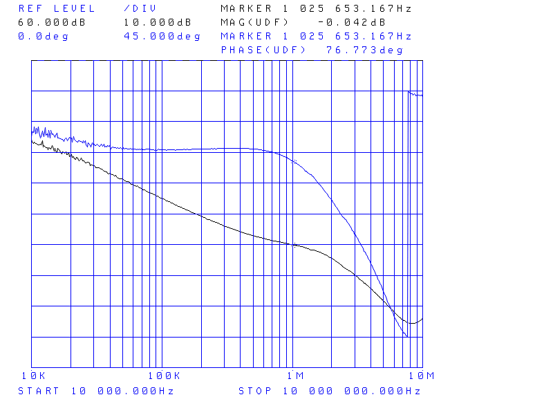

These measurements on first sight look nice, but how about a frequency plot out to 10MHz? My boards (R1.01) have a very nasty oscillation at ~1MHz and clip recovery is pretty nasty, this is simply due to the loop not being stable.
Perhaps you fixed this with a later revision?
Oscillation near clipping is an issue for the LM3886. I addressed this in Modulus-86 Rev. 2.0. You can make the fix in the Rev. 1.0 as well.
For better stability near clipping in the Modulus-86 Rev. 1.0 and 1.01, make the following additions:
- Connect 180 pF from Pin 9 to Pin 10 on the LM3886.
- Change R14 to 20k 1 %.
- Add 33 pF NP0 across R14.
These changes apply to Rev. 1.0 and Rev. 1.01 only. These changes have been implemented in Rev. 2.0 and beyond.
I looked at the gain margin and phase margin out to 50 MHz and it looked clean to me. I've looked at the performance of MOD86 Rev. 2.0 and 2.1 extensively both in the frequency domain and the time domain (using an oscilloscope). As far as I can tell, it's rock solid even with reactive loads up to 1 uF || 8 Ω.
The phase margin of Modulus-86 Rev. 1.0 with 8 Ω || 10 nF load measured 76.8 degrees. The gain margin being about 24 dB. I've attached the loop gain/phase measurement of Rev. 1.0. The phase margin is marked and you can read the gain margin from the point where the phase wraps around 180 º. The vertical axis starts at -40 dB and is 10 dB/div.
I have personally built 15 or 16 of the MOD86 Rev. 2.0 boards. They've all performed to spec.
If you are having any issues with your MOD86 boards, in particular if you are seeing instability, please email me immediately via the Contact Us page on my website. I will be happy to work with you in solving any issue you may have with any of the circuits I sell.

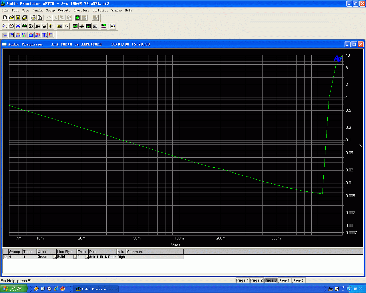

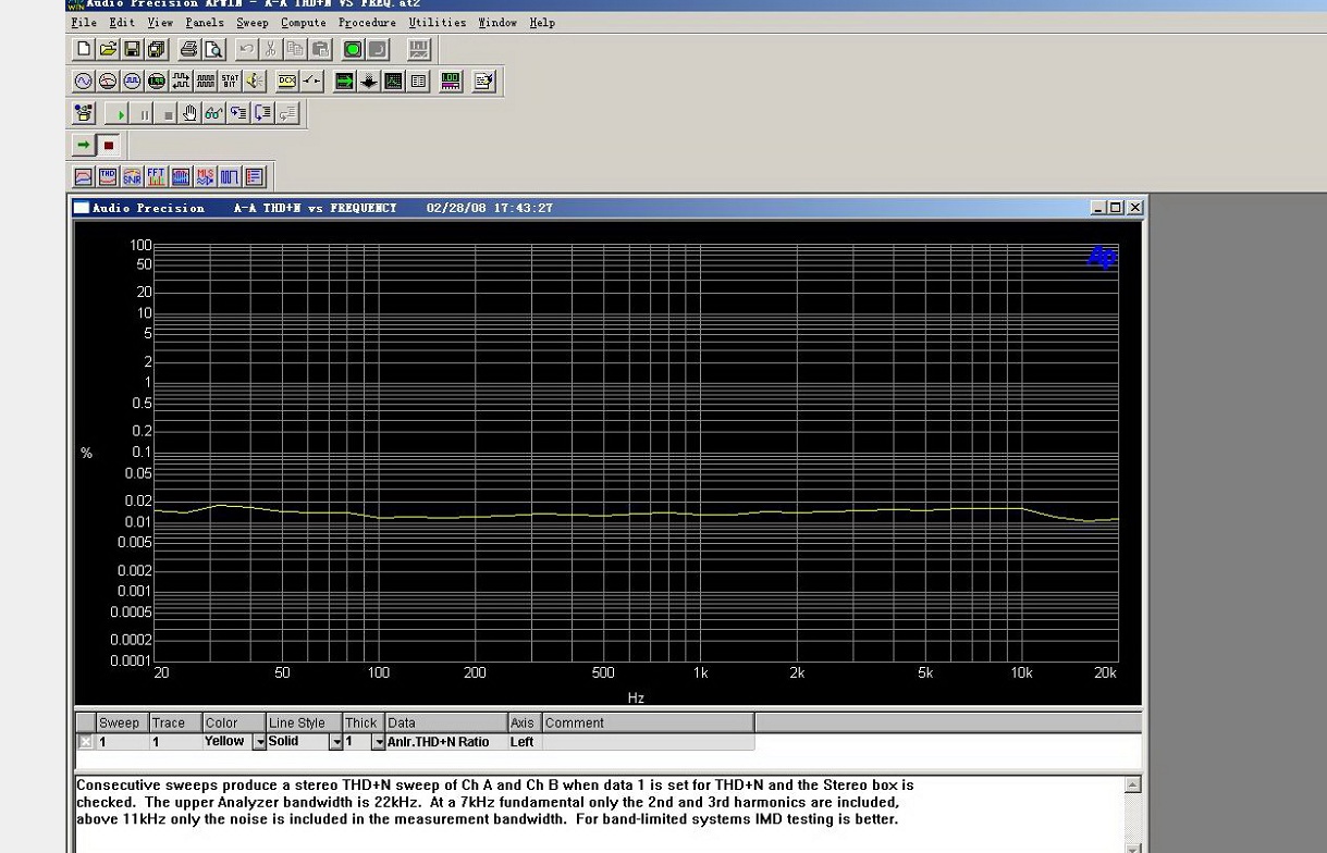

The boards are available for purchase on my website: Modulus-86 Rev. 2.1.
I measured their performance using an Audio Precision APx525.
Tom
Tom

You'll find the full specs here: Neurochrome Modulus-86 Rev. 2.1.
Well if we have no more than incredible distortion figures and some vague open loop plots we have to check ourselves.
"No more than..."? Really? You mean you get more measurements from other vendors? You can see the full set of measurements on MOD86 Rev. 2.1 here: Modulus-86 Rev. 2.1: Composite amplifier achieving 0.000067 % THD. In the support section of my website, you can find links to the Rev. 2.0 and 1.0 pages which show the performance of those amps. If you have suggestions for other measurements that you would like to see on those pages which would be meaningful to a prospective customer, I'm certainly open to suggestions.
"Some vague open loop plots"? I posted an open-loop plot of the loop response near the crossover frequency. That's what was asked for. That's also what's relevant for stability. While these plots do require some skill and knowledge to interpret, I would not consider them to be vague at all. Would you care to elaborate?

Well, I just want to know the LM3886 TIM test.
And I want to see this LM3886 test screenshots.
Not print figure.
Such as like this.
Only need to use it
PRINT SCREEN 😉
