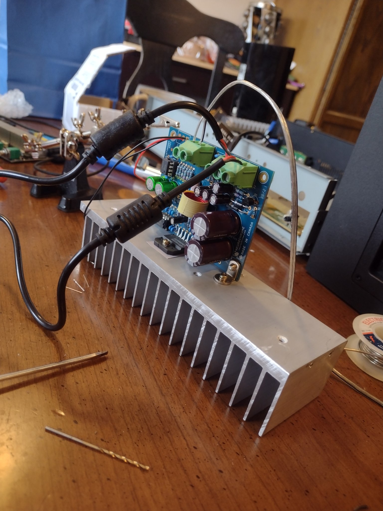

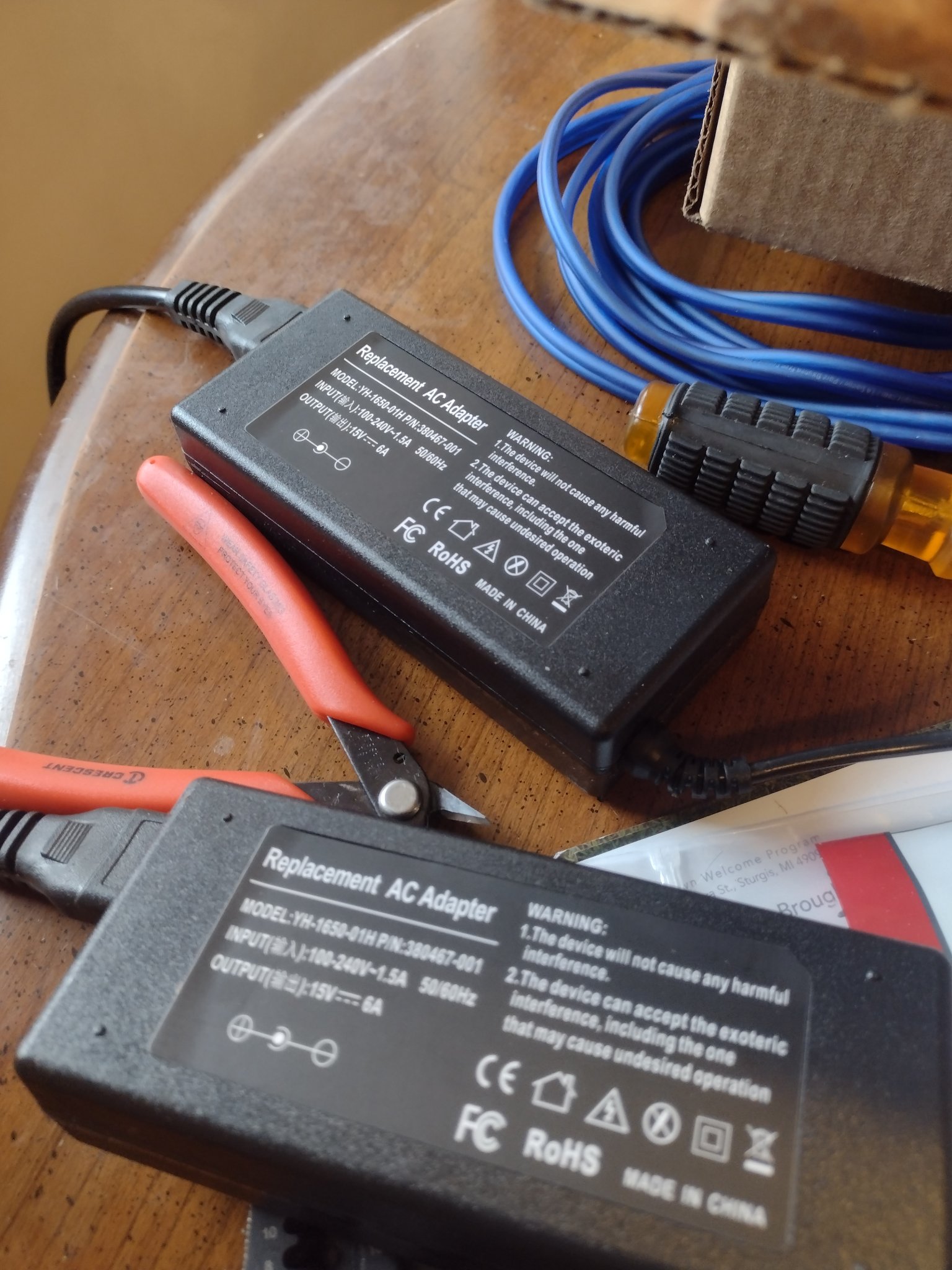

Im still waiting on the second power supply, but i got one board completed and decided to set up a test station. I have a pile of these 15v laptop chargers, so i went ahead and hooked 2 together. Im listening to it right now 🙂. It sounds nice at low volumes so far. Even with this terrible rigged cable setup there is little to no discernable noise floor. Fantastic! Now im itching to have the rest of the parts i need to put this together

Yup, I have many of those laptop power supplies for the same reasons. Works great to throw together a dual rail power supply in a pinch...but always be sure the ground on DC outlet and the ground at AC mains plug are not connected, as you will likely short and destroy one of your power supplies.
[...]but always be sure the ground on DC outlet and the ground at AC mains plug are not connected, as you will likely short and destroy one of your power supplies.
Usually one power supply just goes into current-limiting hiccup mode. Not surprisingly this results in some rather rude noises emitted from the speaker (and could probably damage the speaker).
I'm glad it worked in this case. Note, however, that ±15 V is below the required minimum for the Modulus-86 (±20 V). No harm done. You're just browning out the on-board regulators so you're not getting the full performance yet.

Good to know about keeping the grounds separate. And yes, on the +-15v supply i started getting distortion at around .6v of music input. Sounded nice until that point. Its also worth noting that without even shorting the input one of the modules dc output didnt even register on my multimeter. These things are clean.

The Second power supply came in today, and i got the boards cleaned up and everything wired in. Some of the wiring is temporary until the rest of the wire i ordered comes in. The second power supply wouldnt stay stable at max voltage, so i backed down the power supplies to +-28v where they are both happy. Both amp channels test at the exact same output voltage playing a test tone. I let them both play under 1w for a while, to make sure they were both stable and power supply voltages were stable. Everything was good. Then i went ahead and upped the volume to about .8v of max input, or approx 15w of max output. Thats where the issues started. First I noticed the right channel starting to distort after a couple of songs. I touched the transistor chips and the right channel was hotter than the left. I verified the screws holding to the heatsink were snug, but it seems like they arent really transferring much heat to the heatsinks. I used the thermal tape offered on neurochromes website, but no thermal paste. Am I supposed to run those in conjunction with thermal paste? Or is there potentially another issue at play here? The sound quality was fine until they started to get hot.
I loosened all the mounting screws for each amp board, then snugged down the screws on the chips until right where the lock washer is fully compressed, and then retightened the other mounting screws. That seems to have helped quite a bit, we will see if they can stay thermally stable now
If, by 'thermal tape', you mean the Keratherm insulators, then you DON'T want to use thermal paste. Traditionally people used Belleville washers chosen for the amount of force to be placed on the IC/heatsink interface based on the needs of the thermal interface device. The other appropriate washer is a standard split ring washer. Star washers are not appropriate. It does sound like your initial attempt did not provide compressive force.
Yes, its keratherm tape, and split washers on the fasteners. After readjusting the amp seemed stable enough to button up and install in the main system. So far ive had it cranked for an hour or so this morning with no issues.

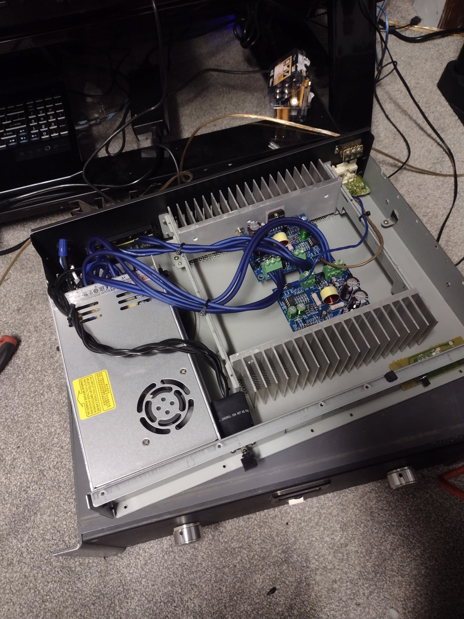

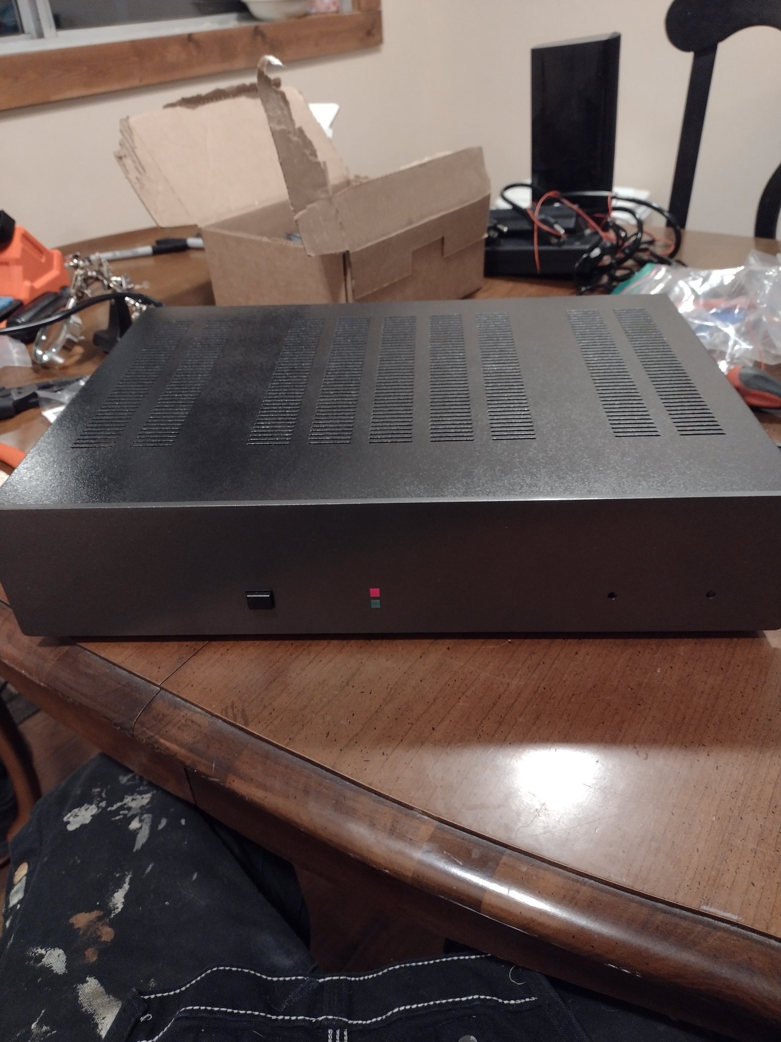

Heres what it looks like all said and done. Im very happy with how well the paint turned out. The krylon crinkle and metallic paints are both quite nice. This isnt a very handsome amp, so i wanted to stay neutral with the colors and let it just disappear. I also went ahead and removed the power led from one of the lrs's and soldered in the red one on the case. It lights up pretty dimly, which is perfect for me. You can just barely tell the amp is on.
So far I havent done any a/b sound testing, however i was pretty familiar with the way my system sounded with the niles si-275. To be honest, im actually surprised at how much difference i hear with the modulus amplifier. The sibilance issues i had in some songs (think joan jett) are gone. Another thing i noticed is that while sometimes the speakers would disappear (jbl a130) before, with this amp theyre just gone. Youre listening to instruments floating in space. Poor recordings also stand out even more now than they did before. Heathens, by simply three is a good example. I love that song, but the noise floor really stands out when your background is pitch black.
I also think this amp will do well with hard to drive speakers. I have a junk pair of onkyo surround speakers from a thrift store that i use for amplifier testing, discharging caps, whatever i need a load for. They sound like absolute junk on cheap amps, and i was surprised at the sound that came out of them during the initial bench testing.
I was slightly concerned that the modulus 86 could be low on power, but it is plenty for a single pair of bookshelf speakers. Im at about 1/4 power and that is plenty for what I like. I think it would even run a pair of towers just fine.
Overall, first impressions say the modulus 86 is an impressive product. Im probably 40 hours into this whole project and dont feel like it was a waste at all.

Yeah. Don't use thermal paste with the silicone based thermal pads.
However, you're using the insulated version of the LM3886 (the LM3886TF). That's intended for use with thermal paste. You can use the Keratherm pads instead. They're certainly less messy than the thermal goop.
Did you mount the boards to the heat sink and then solder the LM3886? Or did you mount the LM3886 to the board first and then mounted the boards onto the heat sink? If the latter you could have the LM3886 mounted at a slight angle. In that case it might not make good thermal contact across the entire back of the IC.

To answer your question Tom, yes, i mounted the board and chip to the heatsink before soldering. I think the problem arose somewhere during final reassembly. I didnt pay close enough attention to making sure the chip was mounted flat.
Ive got the overheating issue sorted out now, and Ive been abusing this amp pretty hard since then. On one occasion in particular I really let it loose, about 1v input volume and let it play hard rock for several hours while I did work around the house. The heatsinks got nice and warm, this amp seems to put out a fair bit of heat. however, it was rock solid the entire time. Not a single hint of SPIKE kicking in. Im very pleased with the performance of this amplifier.

Another note, I have no regrets about the amp I gutted for this project. The sonamp 260 is about as good a setup as I could ask for for the modulus. Heatsinks seem to be big enough, and I like the fact that the boards are able to be placed so far from the power supply. If you dont have an input source that will feed the full 1.6v needed to reach maximum output you could even change the resistors in the gain control circuit and implement them into the modulus boards.
