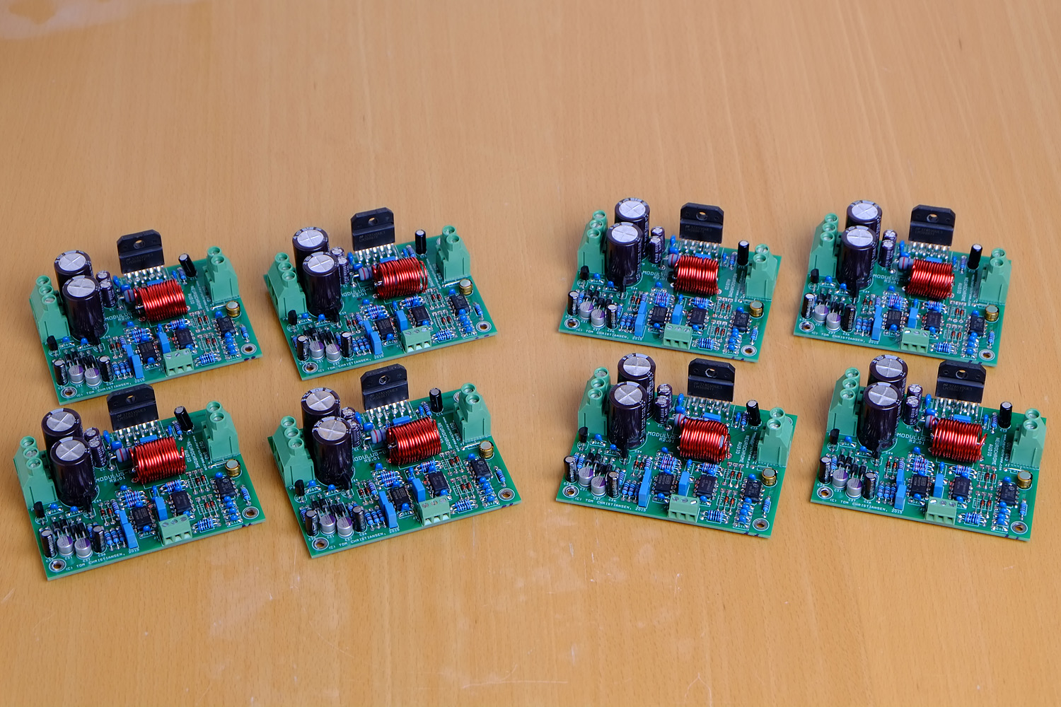

A hard day's night...
Spent the day soldering up eight Modulus-86 Rev. 2.0 boards. I average a little over an hour per board in assembly time.
The four on the left have a gain of 23x (27.3 dB) and are for use with a MiniDSP. The four on the right are built with the default gain of 10x (20 dB) and I intend to drive those with a Focusrite Saffire PRO24 professional sound card.
I think I may just crack open a bottle of microbrew and call it a day.
