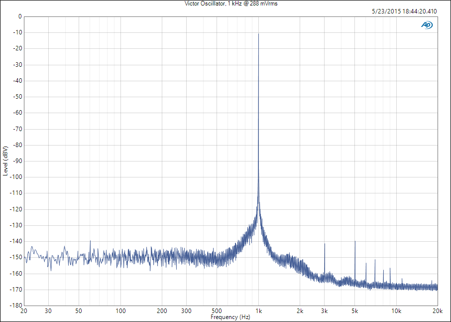

Victor Oscillator THD
Here's the precision oscillator I used. I think it's from a DIY Audio member, actually. I found it on eBay (following the recommendations of a DIYA member).
The THD in this measurement is limited by the THD of the ADC of the APx525 (-130 dB THD). To measure the THD of the oscillator itself, a precision notch filter is needed to reduce the 1 kHz fundamental. I've seen measurements done this way that back up Victor's claims of harmonics below -145 dBc.
Tom

Congrats, really impressive.
edit: can you provide a link to this oscillator you used?
Sure: Ultra Low Distortion 0 00001 1kHz Sine Generator Assembled and Tested PCB | eBay
Search for "Ultra Low Distortion 1kHz Sine Generator" on eBay. The seller's ID is michevich
Tom
