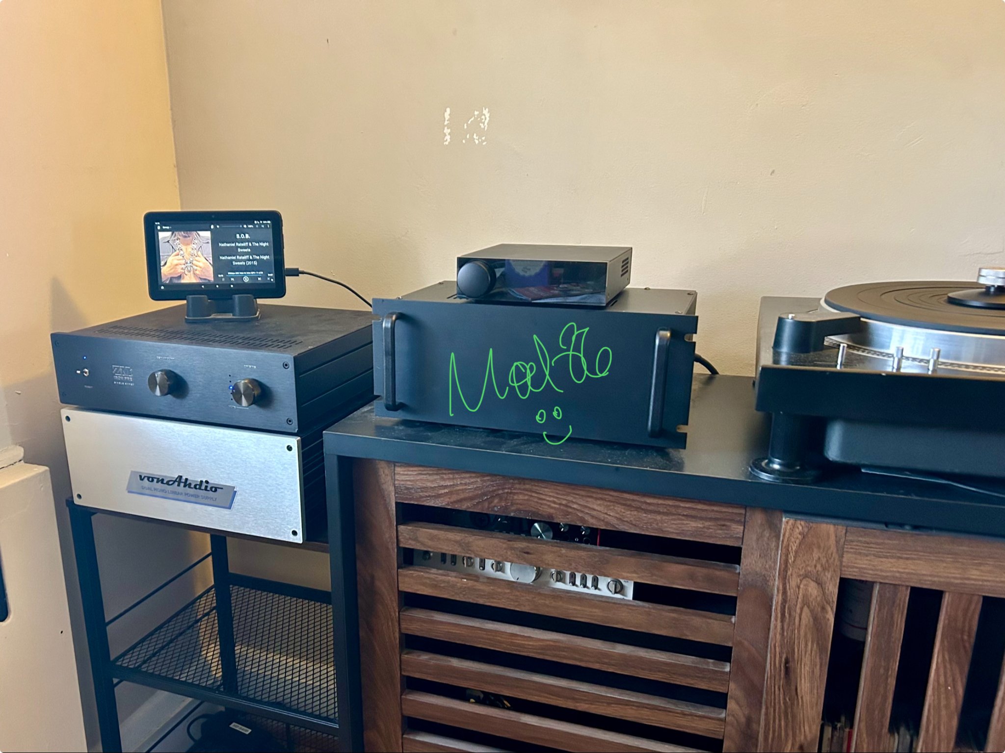

Because someone asked in a PM, I’ve had my Mod86 playing in my main system for a few days now.
In short, I love it!
There is absolutely no detriment to the use of this amplifier. It provides clarity and detail right up there with the best that I have heard (there have been moments of “I haven’t heard that before in this song”). I am convinced it meets the “wire with gain” philosophy. I confess I think I enjoy my favorite class A amps slightly better, overall, but not by much.
As others may have gathered in their audio experiences, it is very difficult to differentiate between amplifiers of such high quality. In my diyAudio journey, I‘m finding that I prefer just a bit of 2nd harmonic distortion, but not very much. However, the clean effortlessness of a vanishingly low distortion class AB amp like the Mod86 is damn near enough to keep me happy.
I try to not dwell on what the differences are and why. That’s a recipe for neurosis and I have enough of that already with this hobby. It’s more fun to build, switch out, enjoy, and futz. It’s ultimately for my enjoyment, so I’d like to keep it that way.
I will continue to be a stalwart champion for the Mod86 (and its higher-power brethren) because it is an impeccably engineered amplifier that also sounds exceptional. If you haven’t built and listened to an ultra-low THD amp and are curious about that sound, the Mod86 is a no-brainer. I highly recommend it.

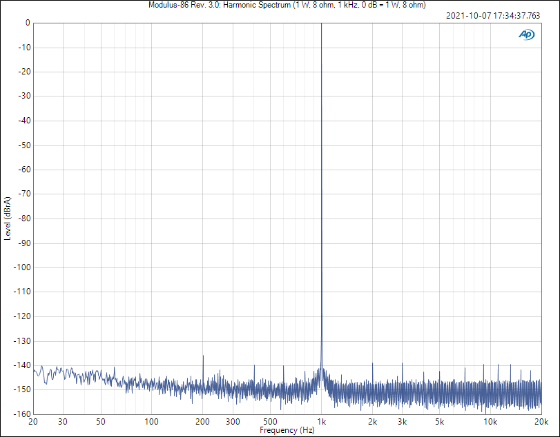

THD+N vs frequency at 0.1-1 W for the Modulus-86 would only show the noise floor of the Modulus-86 and the instrumentation. That's pretty clear from the THD+N vs output power graph. So I don't see a point of providing that measurement.
I do measure the THD (no +N) at 1 W. See below. You can also find the graph in the Performance Graphs tab on the Modulus-86 product page.
Tom
Tom
