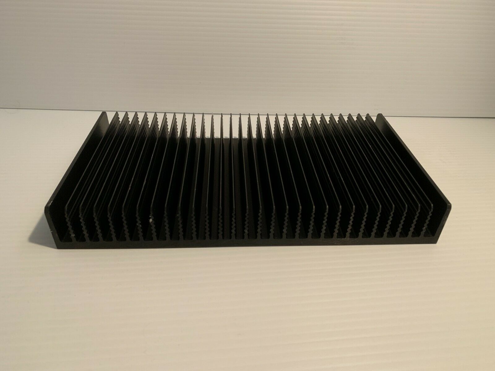

Yeah. It seems pretty solid. It would be nice if it could handle serrated fins

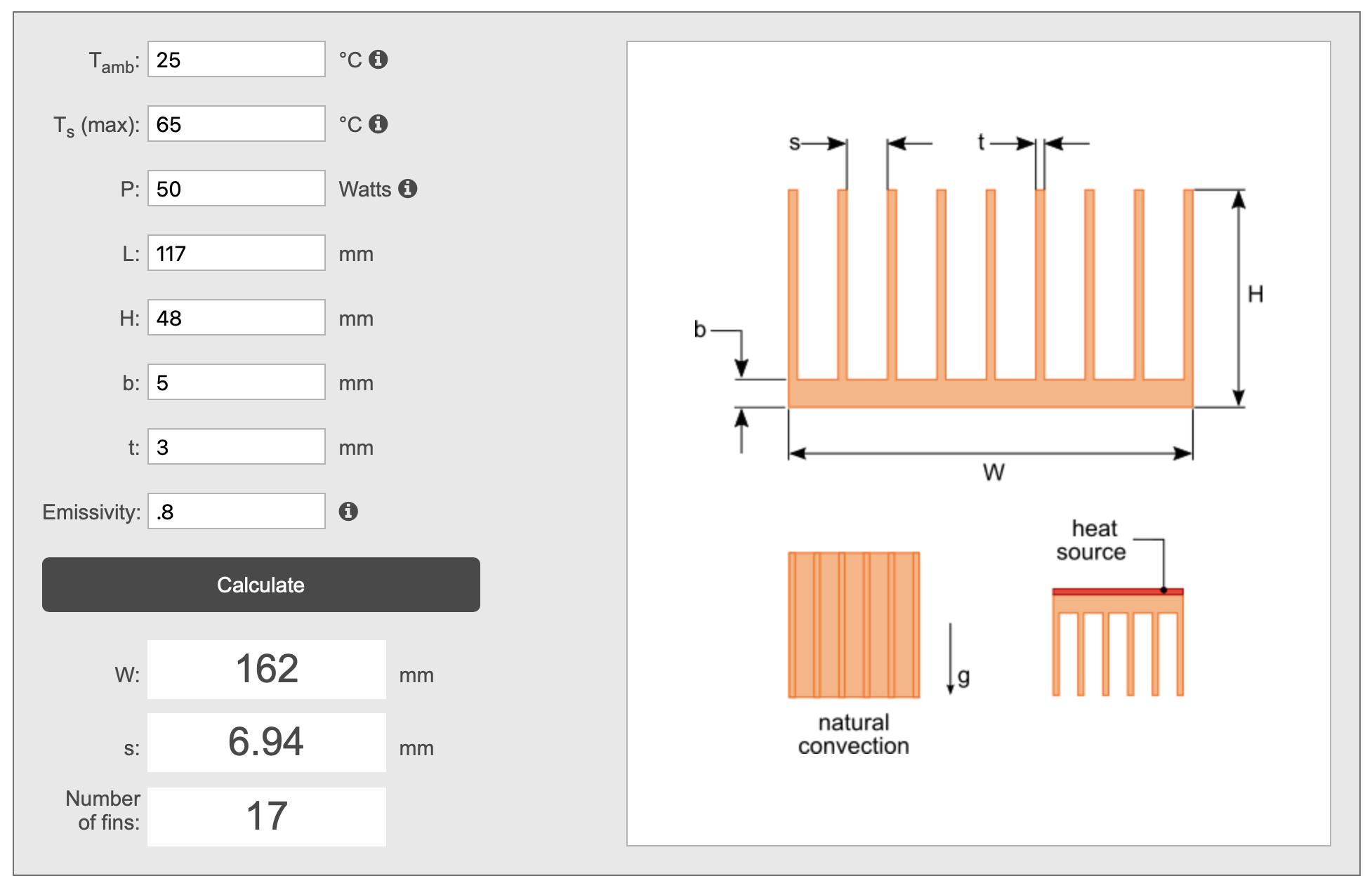

here is heat sink size calculator input and results:
Tamb:25 °C
Ts (max):65 °C
P:50 Watts
L:117 mm
H:48 mm
b:5 mm
t:3 mm
Emissivity:.86
Calculation results:
W: 162 mm
s: 6.94mm
Number of fins:17

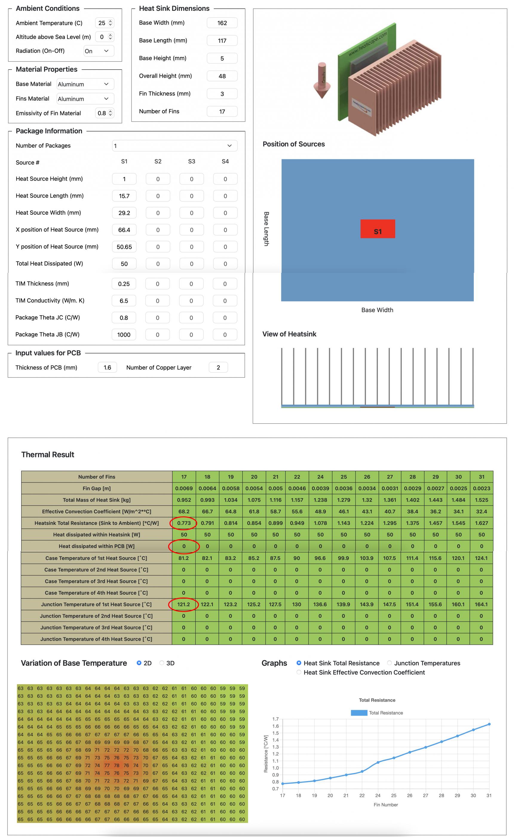

Here is Heatscape Calculator, Natural Convection results with the same inputs:
Case Temperature of 1st Heat Source ˚C101.4
Junction Temperature of 1st Heat Source ˚C141.4.
Is the thermal resistance, of this heat sink, to high to be used in the Parallel 86 amp.?

The calculator seems to take the heat sink dimensions, locations of the heat sources, dissipated power, and calculate the thermal resistance of the heat sinks from there. I'm not seeing a calculator that allowed for the heat sink dimensions to be calculated from the thermal resistance (or temperature, power specs). Would you share a link for that one?

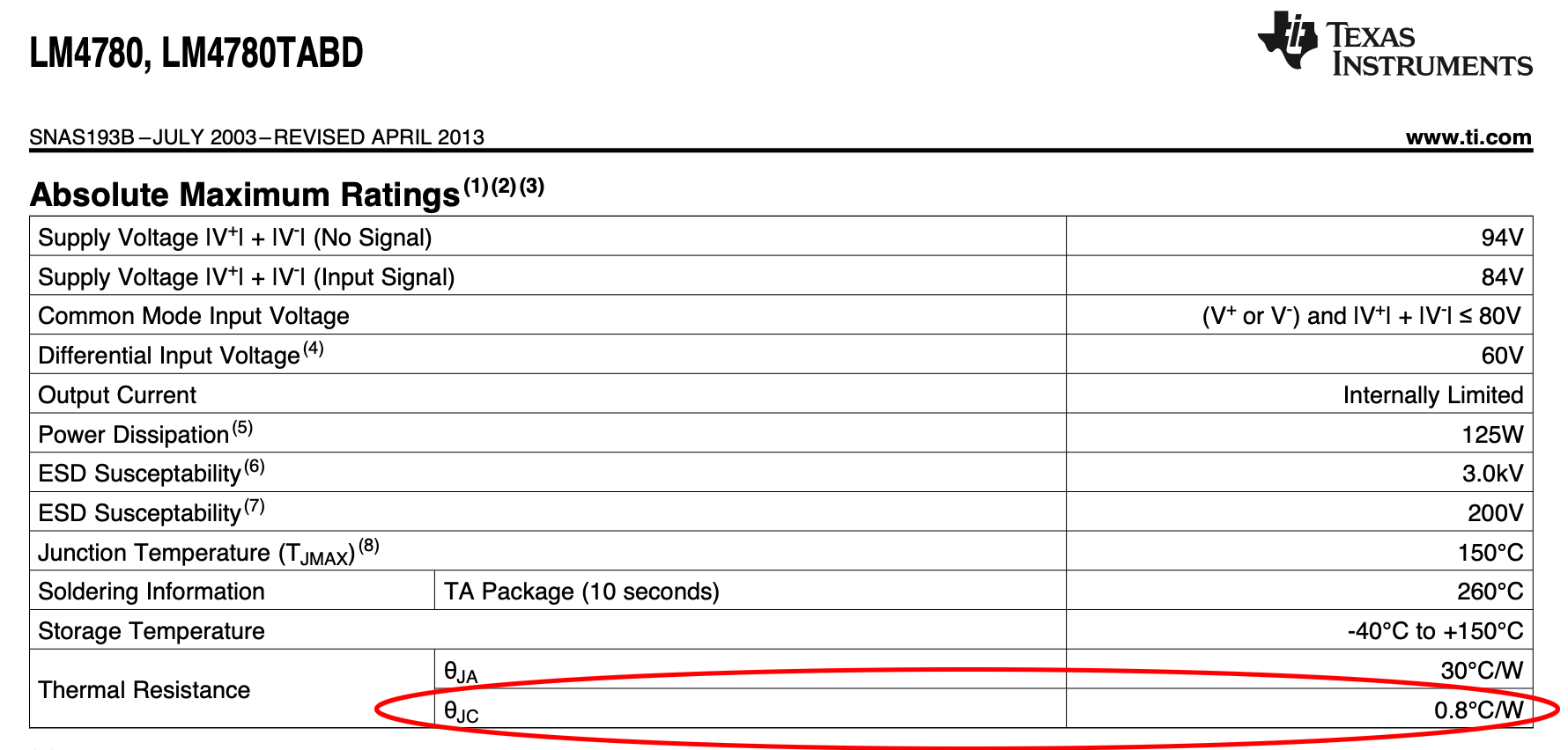

With the Parallel-86, you're looking at 50 W dissipated in the LM4780 for music signal at clipping with a 4 Ω load. 29 W for an 8 Ω load under the same conditions.

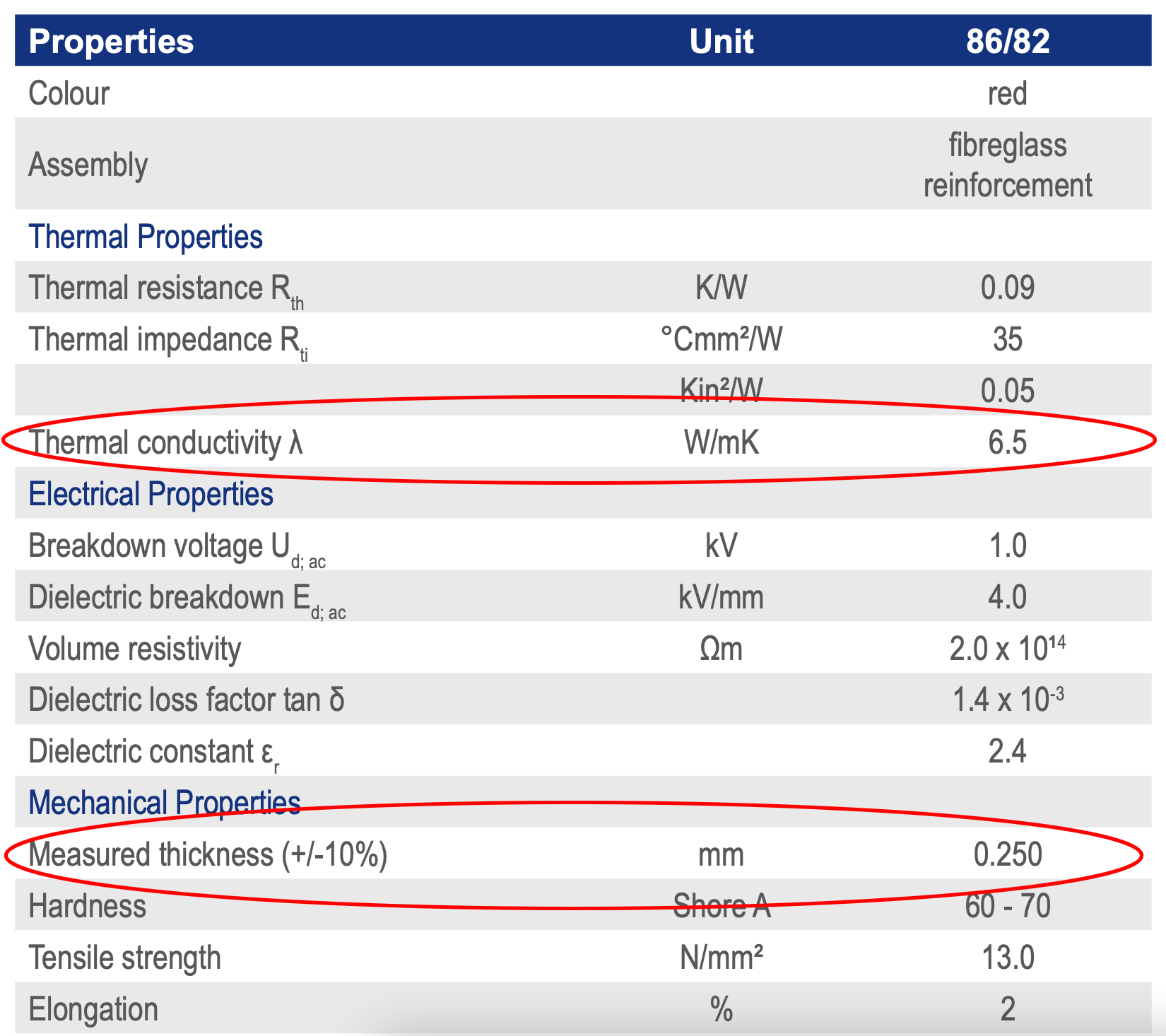

Which values did you use for the TIM (Thermal Interface Material) thickness and thermal resistance? Did you use the correct values for the thermal resistance of the LM4780 package? I would set Theta JB to a large value (say 100) as you're not conducting heat through the package to the PCB.

TIM inputs
I entered .02mm for TIM thickness and 0.2 for thermal resistance. And since a PCB is not applicable I entered 0 for all the PCB inputs. I'll run it again entering 100.
Running heatscape as before, except for inputting 100 for JB, returned junction temp. of 133.2. the previous run inputting 0 for JB returned junction temp. of 141.4. Am I not understanding something? Does the other heat sink calculator that accepts a max junction temp, where I enter 65, actually base results on the junction temp.not exceeding 65˚C
Heat Sink Size Calculator should get you to the calculator that accepts T amb, Ts max, length, height, base thickness and fin thickness and returns total width, fin spacing and number of fins that would keep the maximum heat source temperature from exceeding 65˚C.

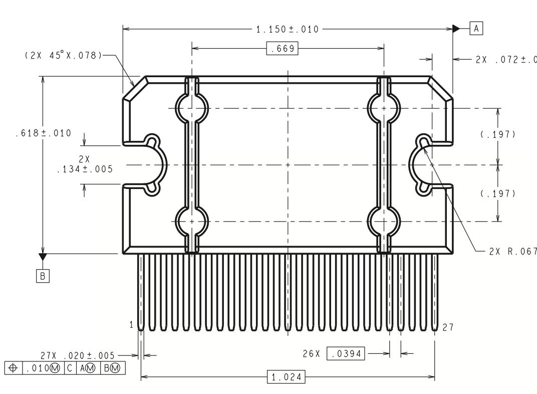

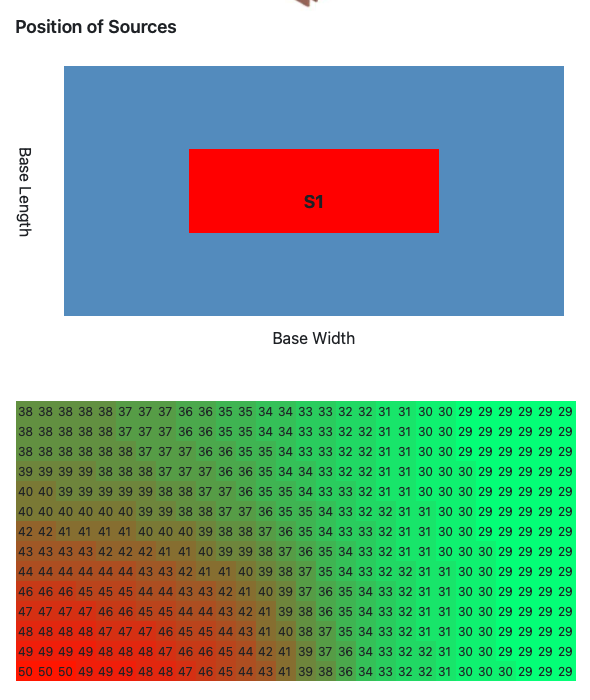

I plugged in your numbers. I used the dimensions of the LM4780 as the heat source size and placed it centred on the heat sink. I used the properties of the Keratherm Red thermal interface material for the TIM parameters. I had to increase the Theta-JB to 1000 to eliminate the power dissipated into the PCB.
The results are spot on with the design requirements. At 25 ºC ambient the heat sink reaches 65 ºC with 50 W dissipated in it.
The junction temperature of the LM4780 comes out to 121 ºC. The chip is rated for operation up to 150 ºC. You may have to right click the last image and select "open in new tab" to be able to read the numbers.
I don't see the problem.
The only issue I see is that the heat sink calculator assumes all the power dissipated by the heat source is dissipated at its lower left corner. That's annoying. That's why the left and right sides of the heat sink are at different temperatures. They should be identical. But ya know... For a free tool I think you get *a lot* of value.

Thanks Tom. The TIM inputs I used are based on a thermal grease.
To bad the calculator doesn't allow turning off the PCB section. I would never have thought to put in such a large number.

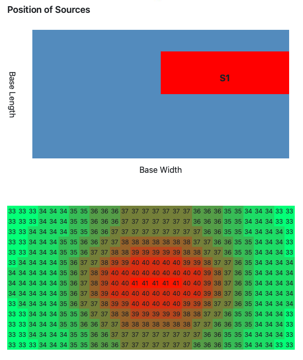

In the package section of the calculator the X and Y location can be entered. It has worked well in the many runs I've done.

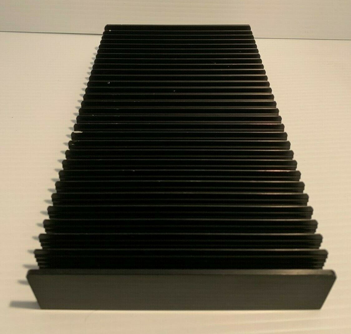

And based on results I finally bought a heat sink. The junction temp will be 114.3 and the hot spot temp will be 71ºC. The heat sink C/W will probably be lower based on the wavy fins. The length is 6.375 but I entered 80mm for length because I will be cutting it in half to result in two usable heat sinks.
Ah. That makes sense. Note that the back of the LM4780 is connected to VEE, so you do need a thermal pad there.
Yeah. On the other hand, it's a free tool.
I know. But the calculator assumes all the heat is dissipated at the lower left corner of the heat source, even if the heat source is the same size as the heat sink. I would rather that it assumed the heat source was isothermal.
I'm willing to work with the shortcomings given the cost of the tool. Ultimately I don't care if the edge of the heat sink is 63 ºC or 65 ºC. I can't guarantee that my living room is 25.000000000 ºC either. 🙂

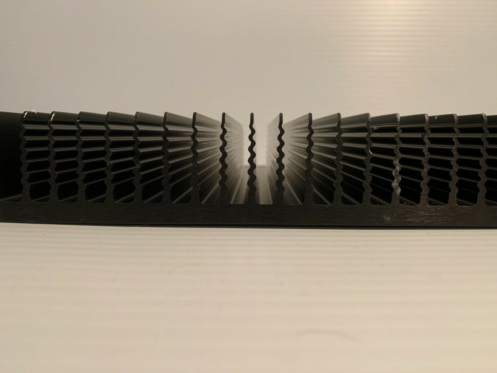

Guaranteed! It's all about air flow and surface area.

So the heatsink calculator returns a graphic representation of the temps on the heat sink. When I center the package the graphic displays red in the center. When I position the package at the lower left corner the graphic displays red at that location. When I position the package at lower right the red shows up there. How did you determine the calculator assumes the heat is dissipated at the lower left corner of the heat source.
Per my previous post, I did three test runs and the red moved to where I positioned the package.
Weird. I just tried on Chrome to see if it was a browser issue. Same result.
Oh, well. I'll discuss with HeatScape. Bug or no bug, whatever the difference is inconsequential for a Parallel-86 build. It's not like we're building a space shuttle here... 🙂 There's no reason to continue beating this particular dead horse in this thread.
