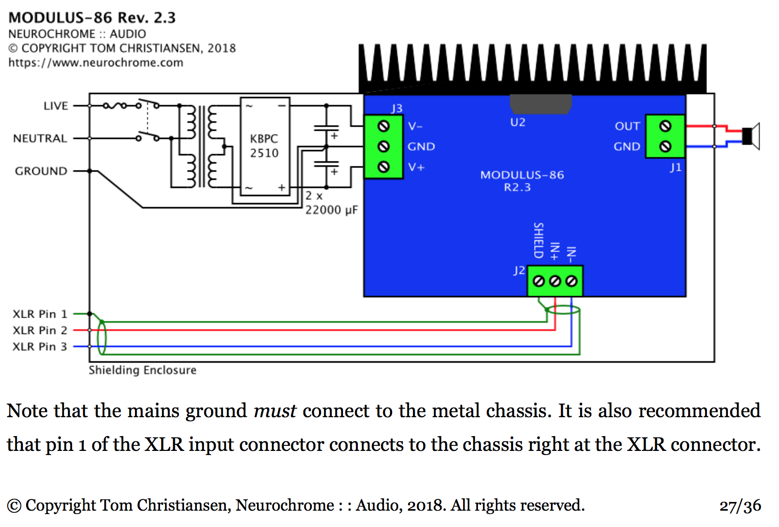

I measure 2.9 dc volt between + and ground and - and ground.
Do i need to connect ground???
With transformers i only connect the + and - , not the ground.
Directly from the design documentation. Notice the filled solder dots on the ground connections to the chassis. That means you have a connection there. This is also described in the text.

Ok i understand that but i don t have chassis. I have all the boards on a wood base.
In that case what is the best way to do?
Right now i connected the ground from analog dac ps to modulus 86 xlr ground by wire....
In that case the DAC supply ground should go to the MOD86 supply ground. DAC signal ground should go to pin 1 of the MOD86 input. Signal+ should go to MOD86 input pin 2 and Signal- to pin 3. If the DAC does not have differential out, take the DAC signal ground to MOD86 input pin 3.

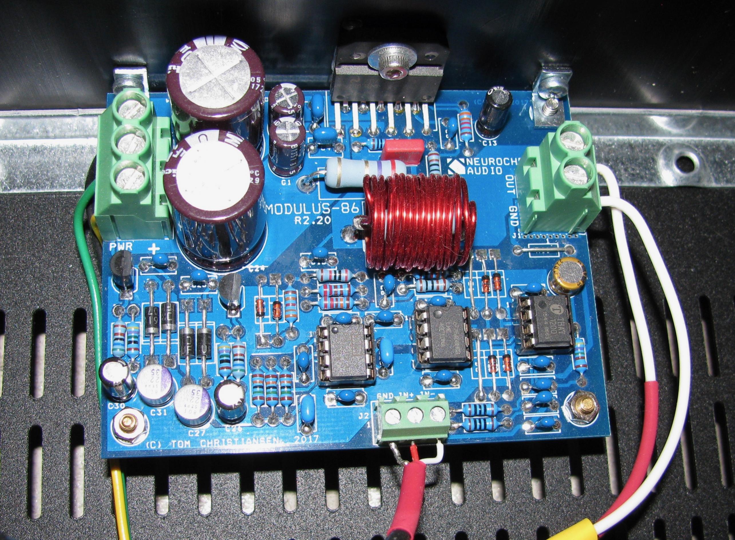

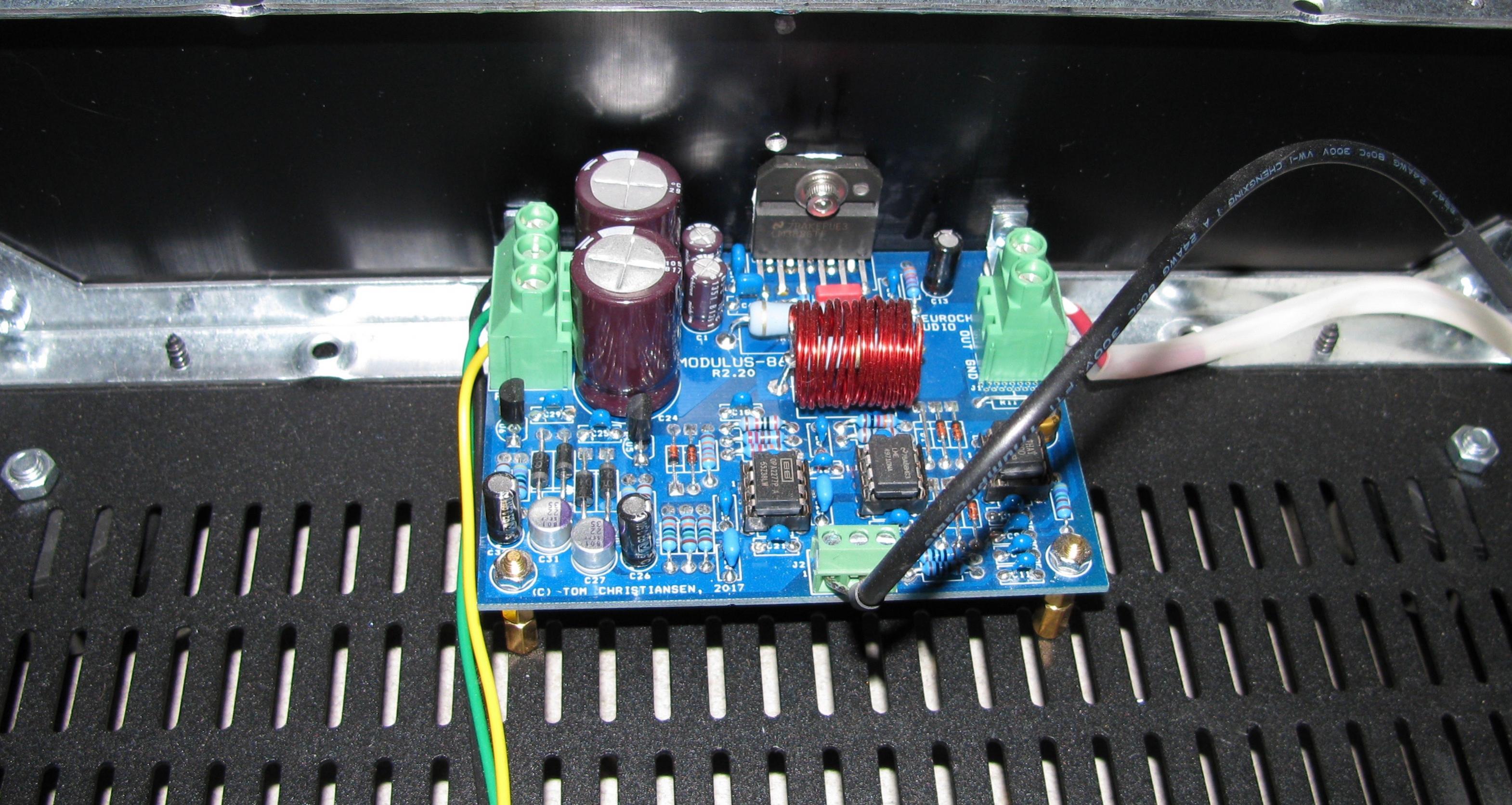

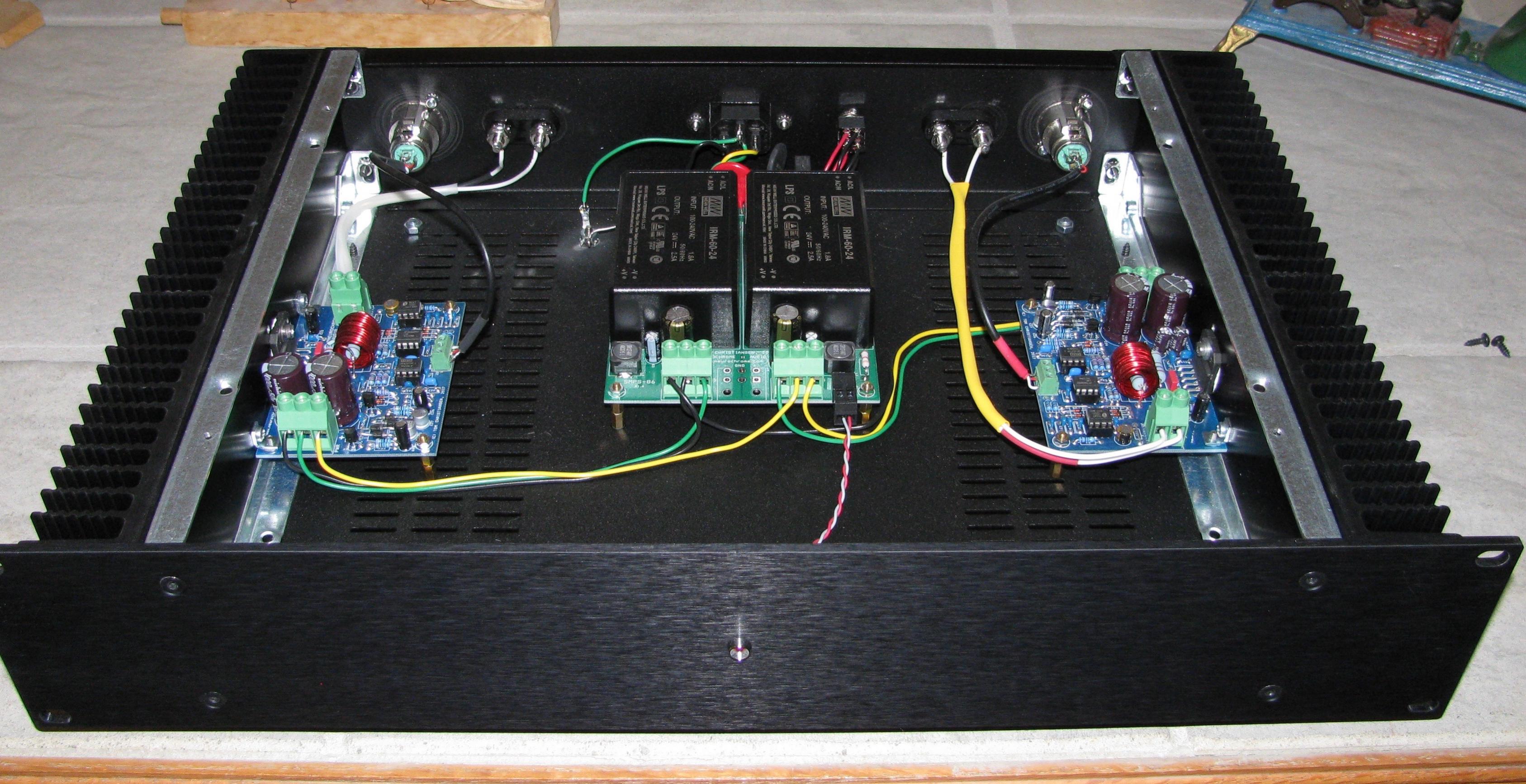

photos of my Modulus 86 build
I had forgotten to show my build, ran across the pictures today, so here it is.
I am still very very happy with the amp. Certainly the cleanest, crispest sound i have had in audio amps.
2U X 300 Dissipante chassis.
My old ears are very sensitive to system distortion, so these low distortion amps have made my listening more enjoyable.

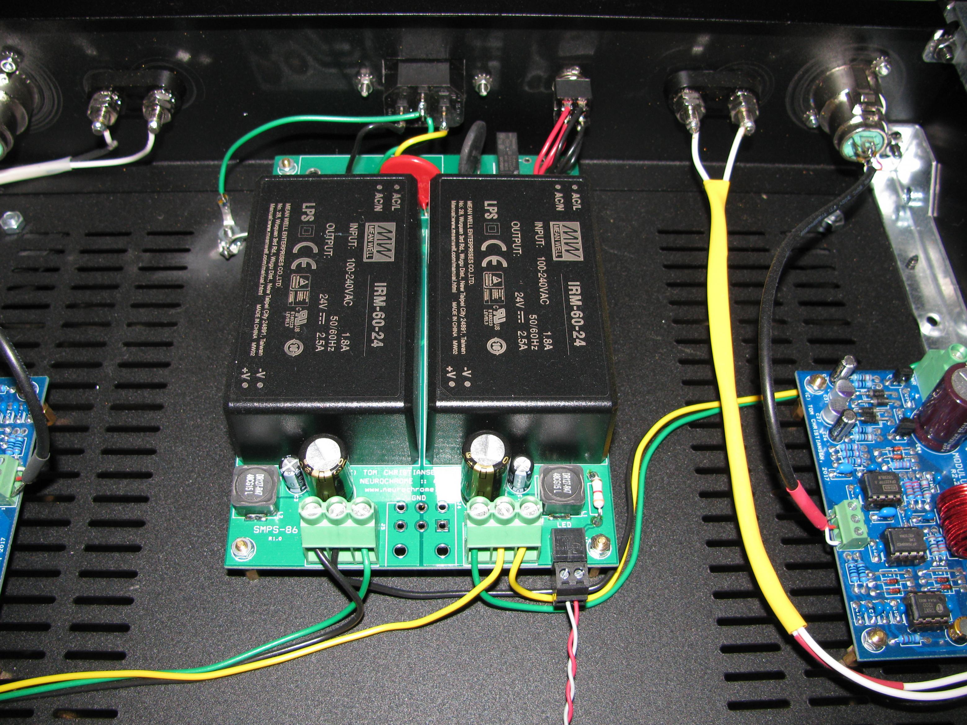

Power supply is the SMPS-86 with Meanwell 24v bricks.
Standard build of the Mod 86 boards, my own hand-wound inductors, obviously.
It has functioned flawlessly with 95db sensitive 8 ohm speakers, providing all the power ever needed.
