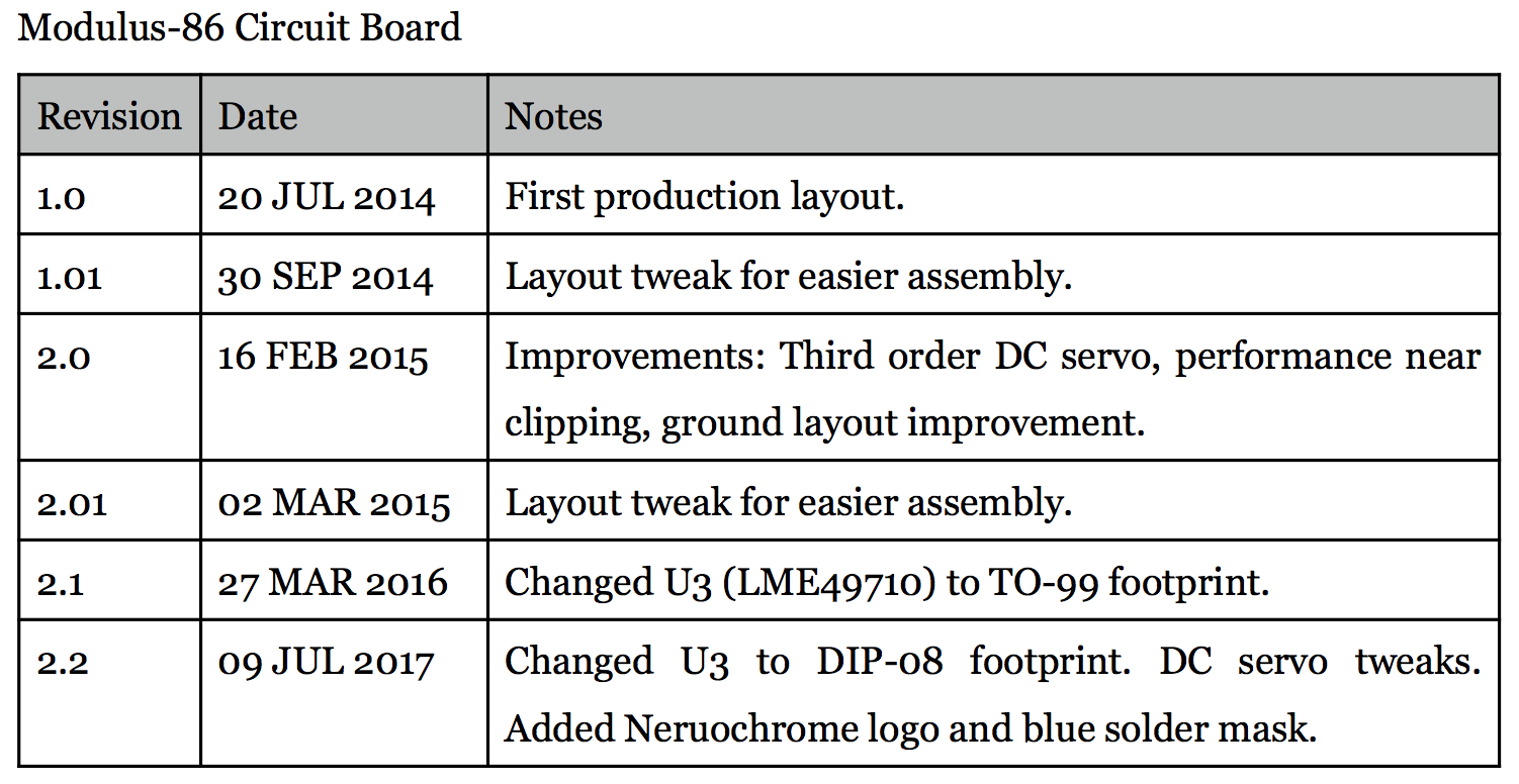

Hi Tom, long time procrastinator. Been sitting on 4 Modulus-86 boards since Aug 2015 when you stopped by my house in Edmonds to demo your friends LXMinis. Still remember that visit well.
It's been a long time away from audio. And now planing to make build a priority. Still going with your amps to drive he Linkwitz LXMinis. And likely add the (2) subs later as well.
Questions I have are:
1. Should I proceed with the 4-Modulus 86 v2.01 boards? Sell them and go with the newer version 2.2 or the Modulus-286?
2. If I go with the boards I have, can I get the LME49710 op-amps from you?
Glad to see you are doing well!
Al
I remember that visit. Good times! And fantastic timing too. I'm glad you got to hear the MOD86 + LXmini combination.
Rev. 2.0, 2.01, 2.1, and 2.2 are schematically identical. You can see the full revision history in attached image.
I would build what you have. I'll be happy to get you hooked up with LME49710s. Just toss me an email (tomchr@neuro...).
Rev. 2.1 changed to the TO-99 metal can version of the LME49710 as TI discontinued the DIP version for a few months back in early 2016. Then TI had a change of heart and brought back the DIP version after about six months.
Rev. 2.2 changed back to the DIP version as quite a few builders got caught by the little quirk of the TO-99 package: The TO-99 has Pin 8 marked by a tab on the can. All other packages (that I know of anyway) have Pin 1 marked. So quite a few powered up their MOD86 Rev. 2.1 with the LME49710 mounted 45º off. This blows the LME49710. The rest of the circuit is fine and will perform to spec once you replace the LME49710. Rev. 2.2 also had some BOM changes in the DC servo.
The DC servo tweaks in Rev. 2.2 meant getting rid of the expensive foil caps and replacing them with ceramic caps. Rev. 2.1 and 2.2 measure exactly the same, but Rev. 2.2 is about $1 lower BOM cost due to the use of ceramic caps.
Rev. 2.2 is also blue and Neurochrome branded. :)
