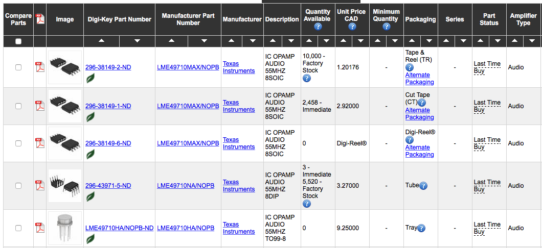

Sorry to be the bearer of sad news. TI has once again decided to discontinue the LME49710. This time in all package options. You can see the official PCN here: https://media.digikey.com/pdf/PCNs/Texas Instruments/PCN20170721000.pdf This is rather unfortunate for the Modulus-86 as the LME49710 is the only opamp suitable for that project. The suggested replacement, the OPA1611, is SMD only and will require the redesign of the compensation circuit(s) in the Modulus-86.
The Modulus-286 and HP-1 are OK as the LME49720 gets to live on.
There's no reason to panic just yet. The last date to order the LME49710 from TI is sometime next summer, so I suspect Digikey/Mouser/etc. will have stock for some time to come. I will keep supporting the Modulus-86, even if it means I have to buy a couple of tubes of LME49710s and sell the ICs with the boards. That said, those of you looking for an all-leaded (i.e. no surface mounted parts) Modulus amplifier should probably consider ordering your boards relatively soon here.
Tom
