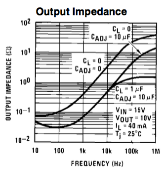

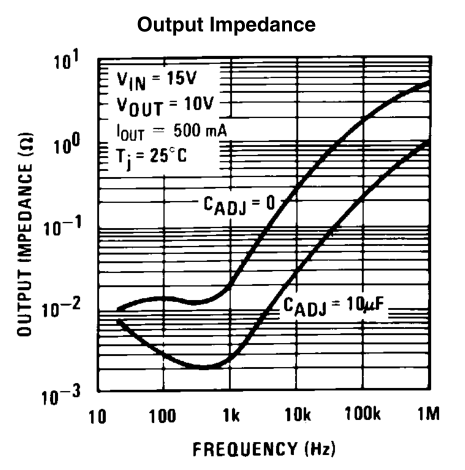

Regulator output impedance
Here are two relevant plots of regulator output impedance. The first is from the regular LM317T (TO220) by way of comparison, the second is the positive regulator used on the Mod-86, the LM317L (TO92).
Worthy of note is that the output impedances of these two differ markedly - the LM317T is at least an order of magnitude lower than the LM317L. The reason for the difference I put down to the difference in the load current - the -T is shown at 500mA and the -L is shown at 40mA. Since the output impedance is presumably a function of the gm of the output transistor, higher gm (from higher load current) gives rise to lower impedance. To me this seems a reasonable deduction to make, if anyone has a reason to doubt the assumption please do share it.
Note also that the relevant curve here for the LM317L is the one with the reference capacitor bypass in place. Also note that the load capacitance for the measurement is 1uF.

Paying attention to the curve at 20kHz for the LM317L (right plot) is instructive - this is roughly the point where the 1uF output capacitor takes over the output impedance determination. However my calculator tells me the Xc of 1uF @ 20kHz is about 8ohms so it rather looks as though that measurement was taken with 10uF rather than 1uF for the load capacitance. The curve looks to be cap ESR limited around 2ohms at HF.

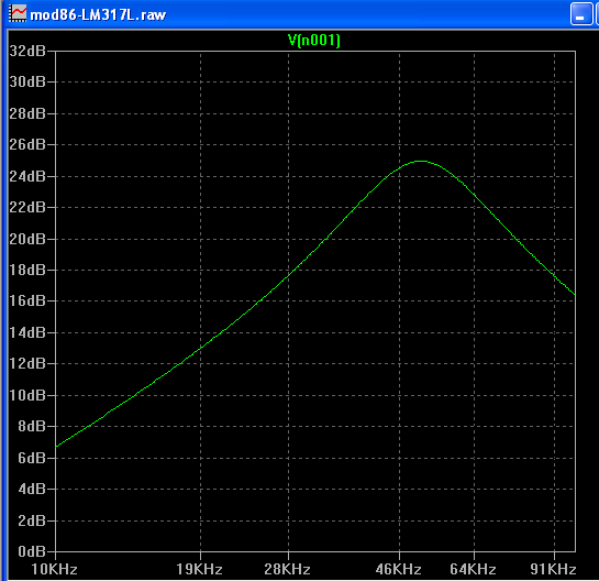

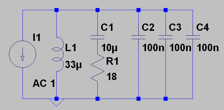

Time to fire up LTSpice for a quick look-see. I've modelled the LM317L as a 33uH inductor (matching the 4ohm Zout at 20kHz) but have no idea what damping it contributes to the circuit. So if anyone has an estimate for that, I'm all ears. I've put in 0.1R series resistance for now.
The vertical scale is in dB but since the current source is 1A, can be interpreted as dB-ohms. The peak at 50kHz at 25dB-ohms corresponds to the ESR I estimated for the 10uF/50V Panasonic EB output capacitor. The remaining 3 caps are 100nF placed at the pins of the three ICs powered by the LM317L. I've assumed their ESR is negligible.
<edit> My earlier post where I figured the output caps were going to determine the impedance above 20kHz looks to be wrong by more than an octave. I hadn't figured that the Pana EB's ESR was going to be as high as it is. So the regulator's inductive output impedance only gets ameliorated above 50kHz with the current decoupling configuration.

<edit> A quick and dirty non-linear LTSpice simulation shows about 100mV peak to peak on the supplies from a 20kHz full scale sinewave applied to a classAB output stage driving 10mA peak current (1330 ohm load). With your 0dB PSRR that'll go straight to the output of your THAT1200.

You can find the output impedance for the LM337T in the data sheet from National Semiconductor (available here). The output impedance is about 10 mΩ at 20 kHz (note: data sheet shows the curve for Cadj = 10 µF, I use Cadj = 22 µF), so the 10 mA load current pulses at 20 kHz (worst case) results in 100 µV of ripple on the ±15 V supply.
Assuming a 20 dB/dec slope from the 80 dB (60 Hz) PSRR of the THAT1200, the PSRR at 20 kHz is: 80-log(20000/60)*20 = 29.5 dB. 100 µV attenuated by 29.5 dB is 3.33 µV. So the load current induced ripple on the LM337 supply at 20 kHz results in an error voltage at the output of the THAT1200 of 3.33 µV.
The 3.33 µV error voltage gets amplified by the full gain of the Modulus-86, resulting in an error on the output of the Modulus-86 of 33.3 µV. The desired signal, meanwhile, will be at an amplitude of 35.5 V. 20*log(33.3E-6/35.5) = -141 dB.
CONCLUSION: The finite output impedance of the LM337T results in an error voltage that is 141 dB down from the desired signal; 6 dB below the noise floor of the amplifier.
Turns out the Zout for the LM317L is worse than for the LM337T. Of course you're free to cherry pick (substituting LM337T for LM337L) but here I'm doing conservative engineering. You also make the error of taking the Zout at 500mA output current, so re-do the math for 10mA.

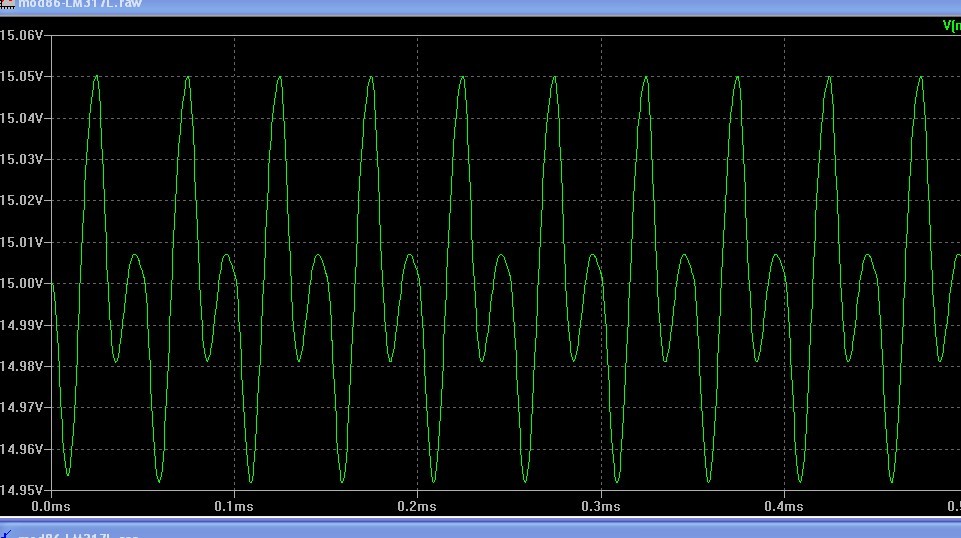

Quick-and-dirty LTSpice sim output attached. Its a bit pessimistic because presumably by the time the regulator's output current has increased to 20mA the Zout will be halved. But it gets us in the ballpark.

The sim I just posted shows the effect of the 10mA haversine current on the equivalent circuit I already posted up. That is showing 100mV peak to peak which I accept is perhaps pessimistic by up to 6dB. Going with the sim for now gives 50mV peak on the supply of your THAT1200. What does your PSRR estimate suggest now for what happens at the THAT1200 output?
At the full rated output power (38 W into 8 Ω*on ±28 V rails) at 20 kHz, I measure 3.0 mV RMS on the -15 V supply and 4.0 mV RMS on the +15 V supply. This measured using a true RMS bench top voltmeter with 800 kHz bandwidth.
Looking at the waveform on an oscilloscope, it looks nothing like your simulation. It looks more like a sine wave with a frequency of 20 kHz. Before you draw conclusions based on your simulation model, I suggest you correlate it with reality...
