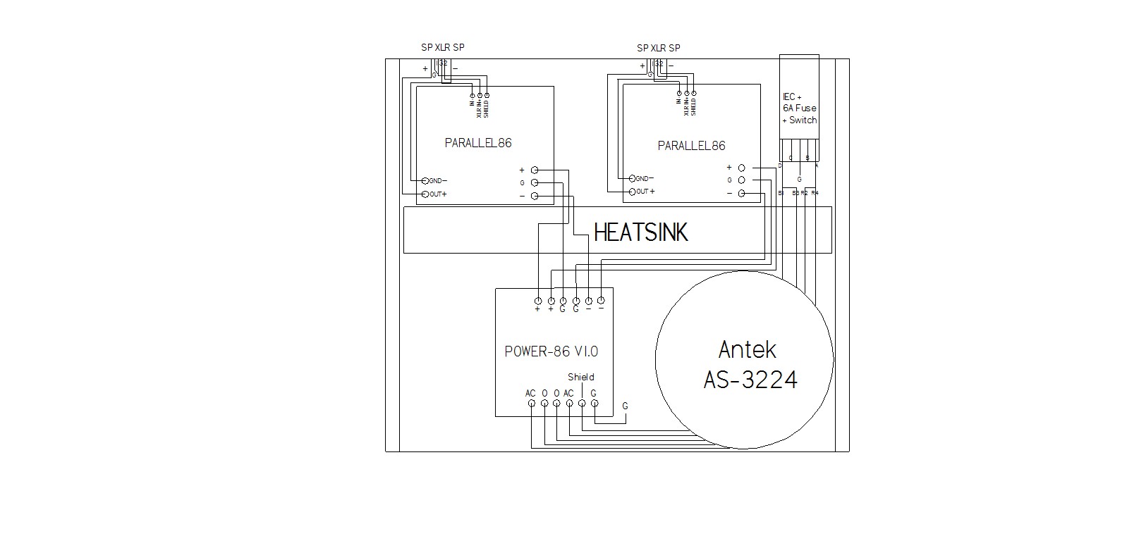

Attached is my latest layout for my Parallel86 build. It shows a Heatsinkusa 12" profile which will be 4.5" long. It's resistance will be .684 @ C/W/4.5".
I now that's overkill but it will also act as a brace for the aluminum base. I made a separate brace for my Mod86 but now I won't need to.
I am planning to run the wires over the top of the heatsink and can't imagine it would ever get hot enough to damage the wires. All thoughts will be appreciated.

Running the wires over the heat sink should be fine - at least from a temperature standpoint. I’d be a little concerned about chafing as the heat sinks tend to have sharp edges. One could easily address that by milling a channel or groove in the heat sinks, installing a Delrin or Teflon insert and running the wires through that.
You could also run the supply wiring around the heat sink on the right side in your drawing. Maybe move the transformer to the middle and the Power-86 board over to the right to shorten the wire runs.
I do like the idea of letting the heat sink brace the chassis.
Just make sure you have a good number of ventilation holes or slots in the top and bottom plate so you can get good airflow across the heat sink fins.
Tom
Each group of wires will be twisted or bundled and run through pieces of clear teflon tubing I have. Don't feel a need to mill channels or grooves.

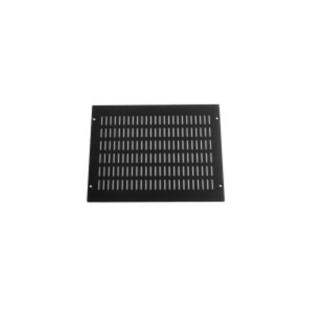

Ventilation is no problem. Modushop has the option to get fully ventilated top and bottom aluminum covers instead of almost solid covers. They can be bought as parts or ordered with a chassis. The price is very fair. They have more openings than aluminum. That's why I needed to make a brace for the Mod86 bottom cover and will need one for the Parallel86. See pic.

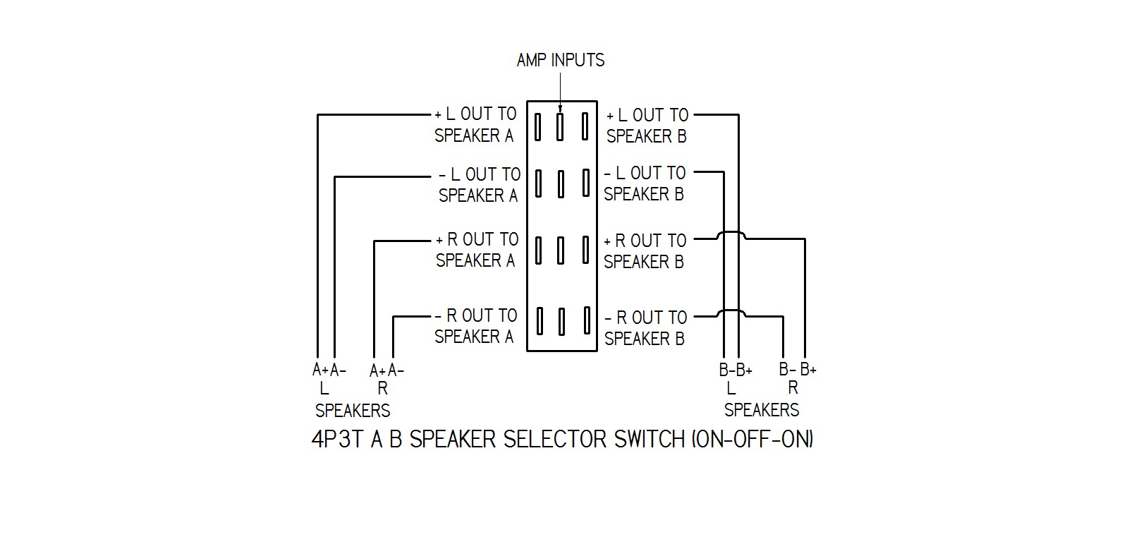

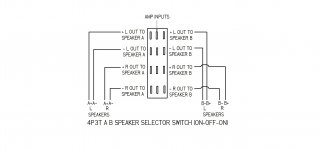

If ON-OFF-ON is what you want, then you have the right switch.
A 4P3T switch would be ON-ON-ON, so allow you to select between three sets of speakers.
In switch terminology, beware of brackets. As in ON-(ON), for example. (ON) means momentary. I.e. hold the switch in that position for ON. Let go of the switch and it returns to the other position. A doorbell switch is an SPST OFF-(ON) switch. A basic light switch is SPST OFF-ON.
