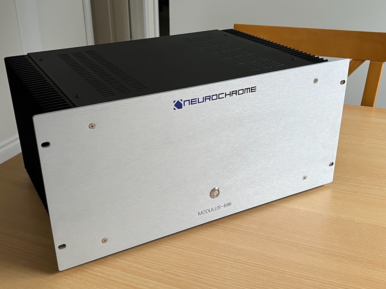

And pictures of the completed beast.

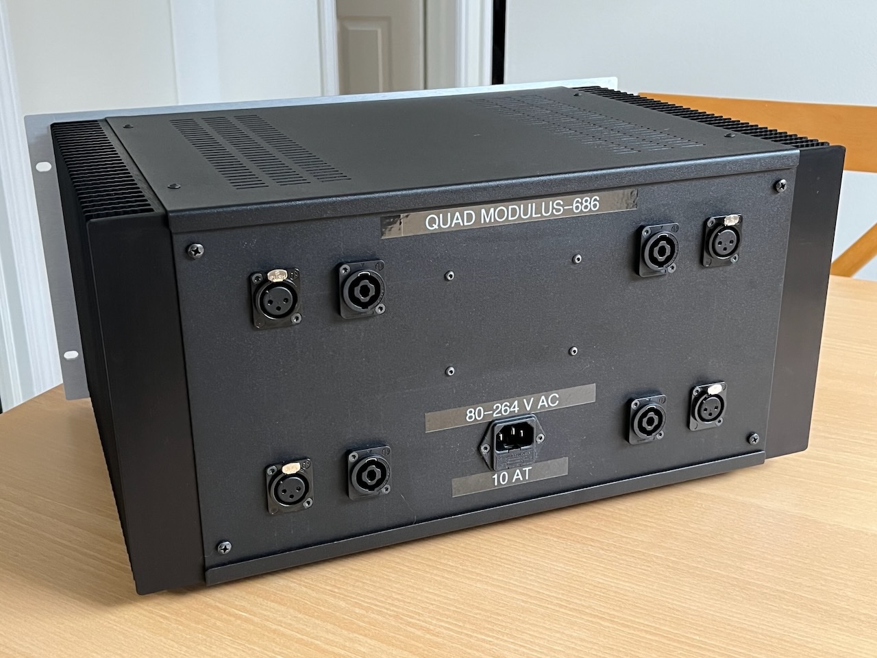

Hi Tom
Since you are using XLR connectors (locking) and Speakons (locking) did you not consider a Powercon mains connector?
IEC's drive me nuts - the various fancy distribution boards I use have them, and they often just pull out. I put Powercons on my amps, so at least with them there is zero chance of the mains pulling out of those.

I think Tom has mentioned that customers are all over the place on IEC versus Powercon, as well as on SpeakOn versus binding posts. As I recall, majority of customers use and want IEC, and I suspect that this is the case because of the ubiquity of IEC power cords.
With all that in mind, I've just bought four sets of powercons to replace the IEC's on the distribution boards.

Tom,
What do you use to make the stick-on labels I see on the back of your latest Mod-686 above? Looks like a nice, hopefully fairly inexpensive alternative to the methods you would use on the front.

My client did not request a PowerCon and I didn't ask. So it became an IEC. I think I'll ask next time. It's a heck of a lot easier to make a round hole in those steel panels than a rectangular one.Since you are using XLR connectors (locking) and Speakons (locking) did you not consider a Powercon mains connector?
ModuShop does not offer customization of the steel panels, sadly, so I machined those. I used a carbide tipped hole saw for the 24 mm holes for the Neutrik connectors. $10 from Bezos.
I use a label maker. Mine is a Brother P-Touch P600, but a less fancy model will work too. Just get one that uses the Brother TZe tape.What do you use to make the stick-on labels I see on the back of your latest Mod-686 above? Looks like a nice, hopefully fairly inexpensive alternative to the methods you would use on the front.
I de-greased the surface with 99% isopropyl alcohol before I applied the labels. I'm pretty confident they'll stay.

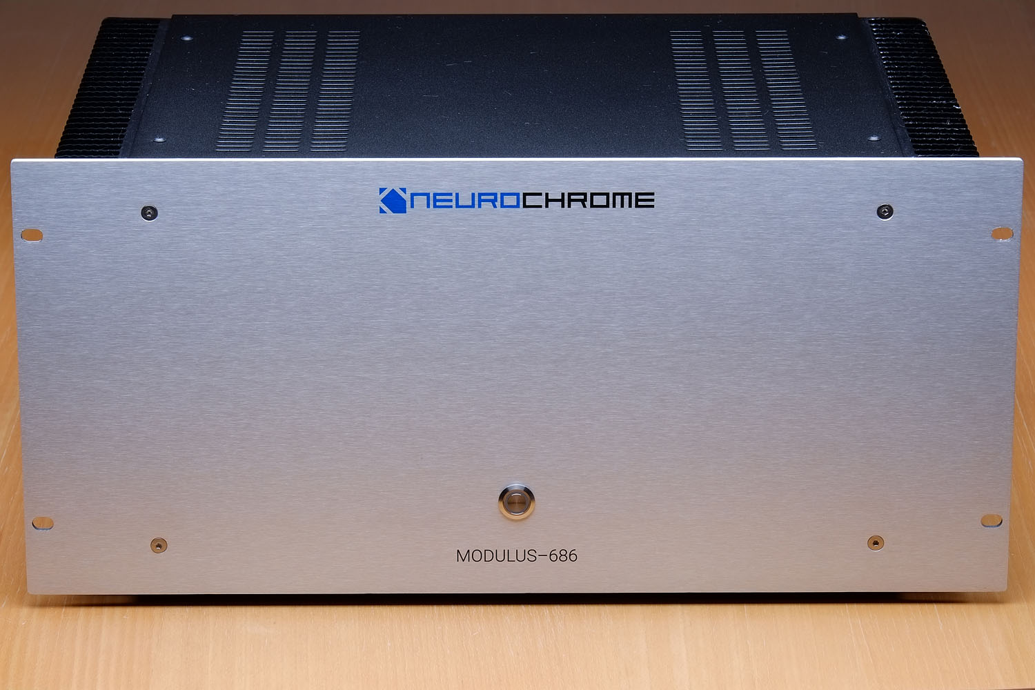

The front panel was digitally printed by ModuShop. The logo is in two colours. It's pretty obvious in person, but somehow the blue and black look nearly the same in the picture. Here's a better picture of the previous build:

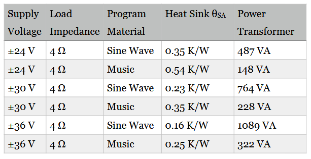

I'm making some drawings for a 5U 400mm chassis to run as cool as possible. There's a 500mm version too but the extra 10cm depth is a major inconvenience. I would take bigger finned heat sinks any day, but that would mess with a whole lot of typical hifi racks out there.
The 5U 400mm chassis should be pretty close to the thermal resistance required for ±36 V sine wave operation at 4 ohm. I can't tell for sure because I've never seen any exact figures for the thermal resistance of the different Modushop heat sinks.
Since I'm already close to the thermal requirements, why not approach the power requirements as well? It would be cool to have for making measurements, and maybe running the PSU's a little cooler during music reproduction too. I have a pair of Connex SMPS800RE ready to go, but they will run out of steam with sine waves eventually. Looking at the LOP-600-36, I find the idea of going dual mono with them very tempting somehow. It would be the opposite end of the 4-channel build; 2 channels with 4 PSU's. Another datapoint for the LOP's would be good to have for the community, it'll be fun to try, and maybe such an amp could be the beauty and the beast all rolled into one. If it doesn't work out, I can always swap an inner plate or bottom plate and insert the Connex PSU's or something else entirely.

You can find thermal info here: https://hifi2000.shop/site/user/pages/05.docs/PESANTE _ DISSIPANTE Thermal info.pdf
I don't know about the 5Ux400, but all the other 400 mm deep chassis have heat sinks made from two chunks that are 200 mm wide. I have heard from one customer who had a bit of an extrusion 'burp' on one of the heat sinks that prevented the heat sinks from coming together tightly. He filed off that burp and all was well, but it was annoying. So I'd stay with the 300 mm deep if you can. Then again, don't judge by a one-off experience.
With 5U in height there's no shortage of volume, so you can always have a vertical plate holding stuff or start stacking. The power supplies are easy to stack with long standoffs. You can also put circuitry on the rear panel. I put the ISS there in the 4-channel build. You could even put the power supplies on the heat sinks(!)
I don't see any issues with a dual mono build. I don't see a huge advantage, but no issues. The terminal blocks I used are called barrier terminal blocks. I forget the part number.
