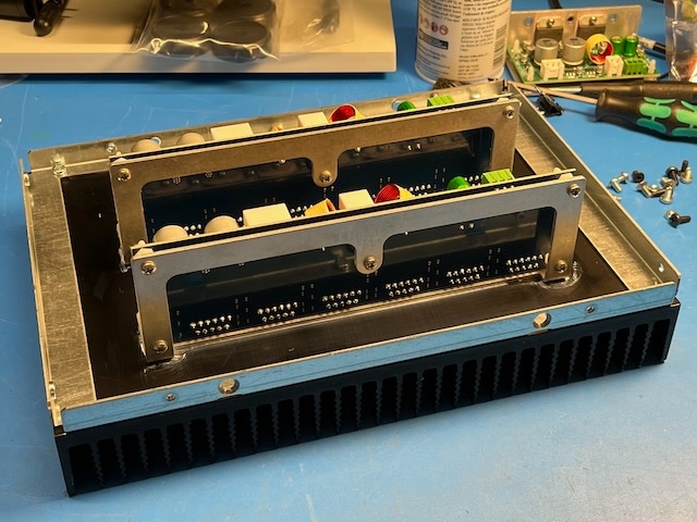

Gotta say that I love the 'new' side brackets from ModuShop. Granted, they're not exactly new. I think they started offering them about two years ago, but they're new to me. They're nicely made and the captive nuts make assembly a breeze. Nicely done @Gianluca.
This is the 5U x 300 mm Dissipante with steel panels. I'm building a rack mountable amp for a client. 4x Modulus-686 powered by two Mean Well LOP-600-36.

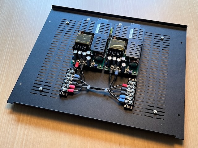

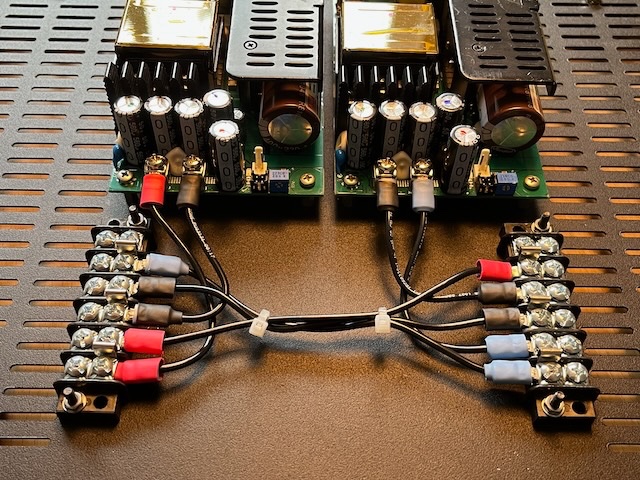

Power supply setup:

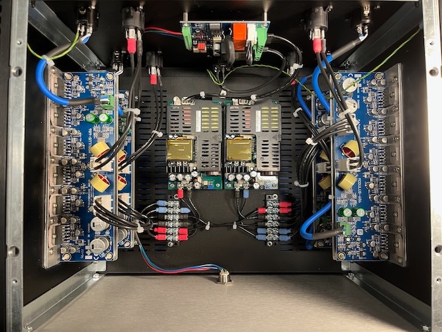

And inside view of the completed amp.
I've powered it up with two channels plugged in and with four channels plugged into the power supply. No whine that I can hear. So far, so good.
Tom
