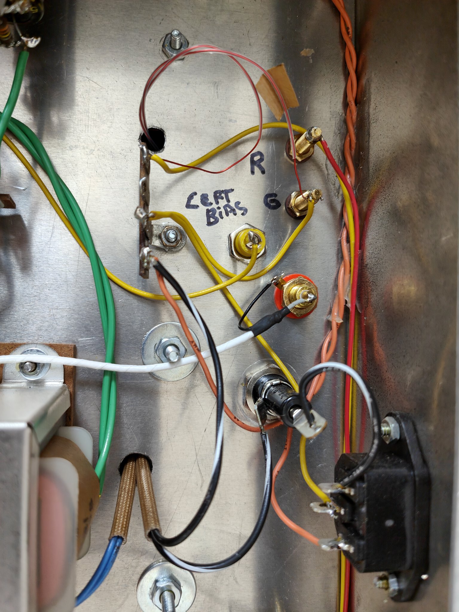

I've recently switched out a set of EL34 tubes in the attached circuit and find adjusting the bias a rather painful process as the adjustment is done on a net basis for both tubes and it is very hard to get the tubes matched to an acceptable level.
What would be the most efficient way to add in a second trimpot so each power tube could be adjusted separately?
Your amplifier has Single Ended Output tubes.

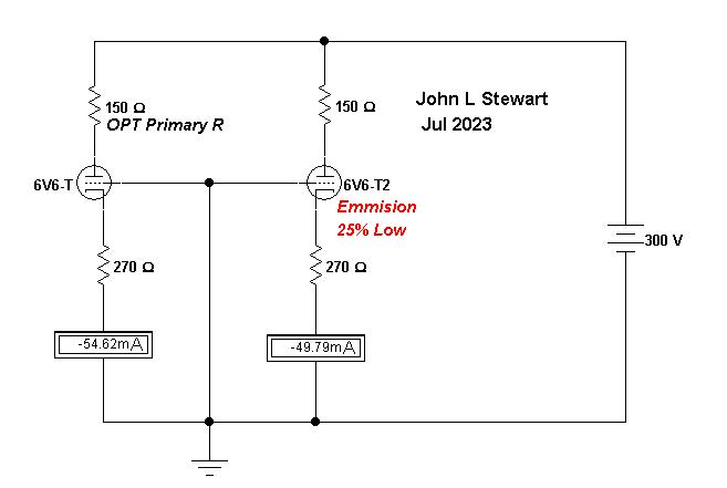

Just matching the cathode current (plate current + screen current) does not insure that the gain of the tubes is the same.
After getting the cathode currents the same, you need to Either use very well matched output tubes (or at least check channel 1 and channel 2 input to output gains).
Unless your B+ power supply is fairly stiff, and you add a 2nd bias pot, you might find that when you adjust one tube's current, the other channel tube's current varies slightly. That is because when current varies, B+ varies, so the other tube's current changes.
Your EL34 tubes are in Ultra Linear, so any change of B+ will affect both the plate voltage, and even more importantly the screen voltage.
The plate impedance, rp is very high, so a B+ voltage change results in very little plate current change (like in Pentode mode).
But, the plate current is very sensitive to Screen voltage changes, so a B+ voltage changes does affect the plate current after all.
Of course, the other solution costs extra. Purchase a Very Well Matched pair of EL34 tubes.
Plug in and Play.
I drive over to Eurotubes.com and pick up all the JJ tubes I need. They re-test the tubes, and do Excellent tube current matching, gain, check for grid current, noise, etc.

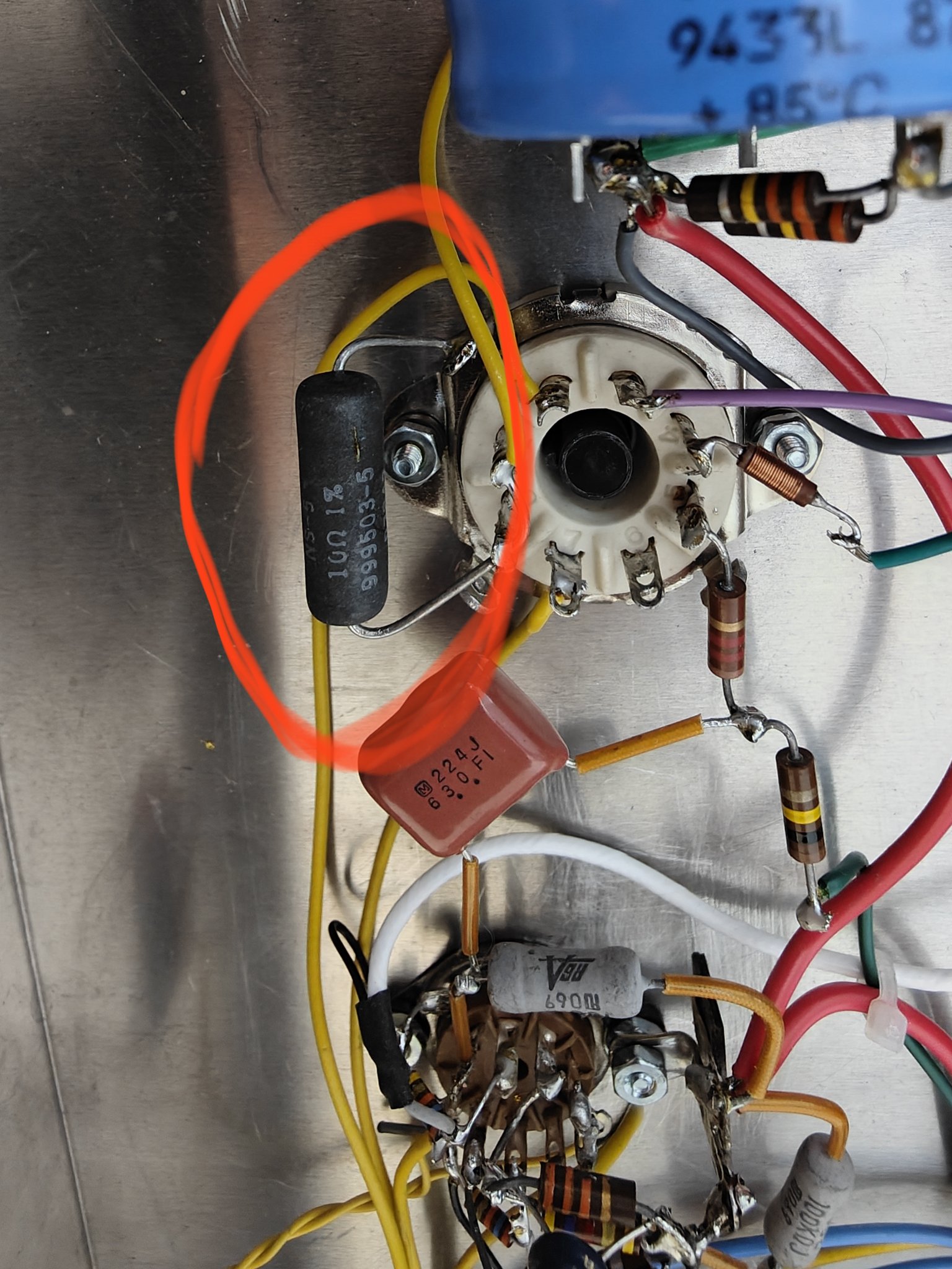

I am curious about the use of an RF Choke for the screen, all chokes are [self] resonant.
I would much rather see a 100 Ohm or 200 Ohm resistor there.
Push Pull amplifiers need to have very well matched output tubes, it is paramount.
But that is a completely different story, and a different Thread.
Keep us posted as you modify this amplifier.
Happy modifying, and happy listening!

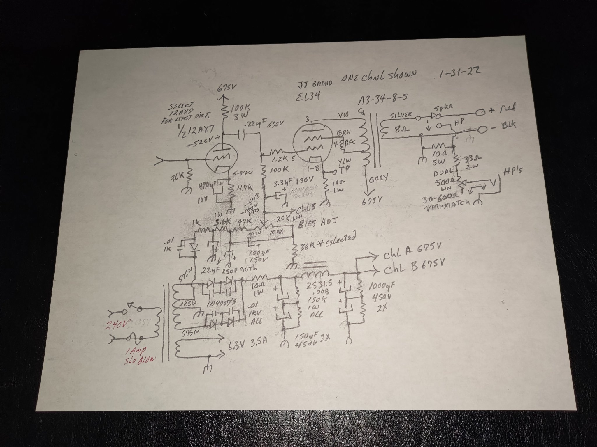

Fuling's suggestion is good, in addition I would place a 2.2 meg resistor from each pot wiper to the 47k end of the pot. The reason for this is if the pot goes noisy or the wiper goes open the will be a negative bias on the output tubes. Zero bias could damage the tubes and/or the output transformer.
Fixed Bias on SE amplifiers is not a good choice at all,
Cathode Biasing will solve 95% of your problems.
Where did this circuit come from, it is a loser, 👎
Individual Self Bias Resistors with individual bypass caps, makes it much easier.
And with 675V B+, those EL34 tubes will not miss the reduction of Plate to Cathode voltage because of the self bias voltage.
I wished I noticed the High Voltage B+ earlier.
A lot of parts can come out when the fixed bias circuit goes away, and all that is replaced by 1 resistor and 1 capacitor per EL34; self bias resistor and cap replaces the 10 Ohm cathode resistor.
If the tubes are reasonably matched, it is Plug and Play. No more bias adjustments!
The 100k g1 resistor connects to ground.
All the bias voltage circuit parts comes out.
The more I look at that circuit, the more I agree with jhstewart9.
The B+ secondary is 575V, that gives up to 805V B+.
That needs to be checked out.
The maximum screen voltage of an EL34 is 450V, Ouch!

If the tube characteristics are badly matched, the channel to channel performance will not be equal.
Getting tubes from overseas is expensive. But some local vendors do a good job of matching for just a little more $$$.
And, there are those Vendors, local or remote, that do a very poor job of matching.
caveat emptor
Have fun modifying the amplifier to use Self Bias.

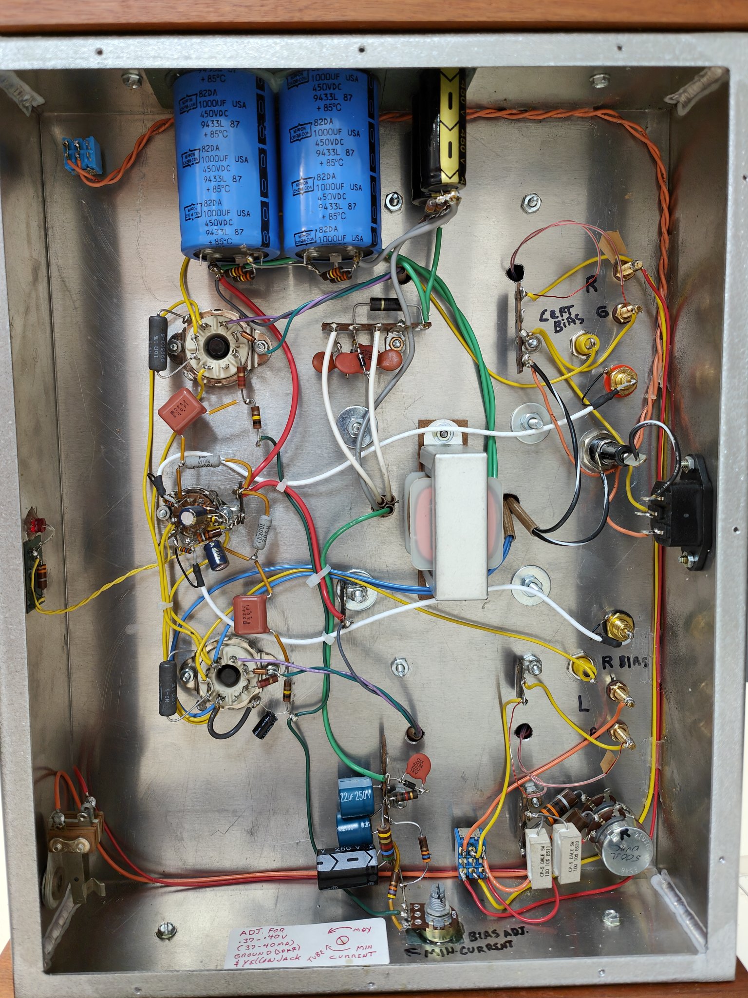

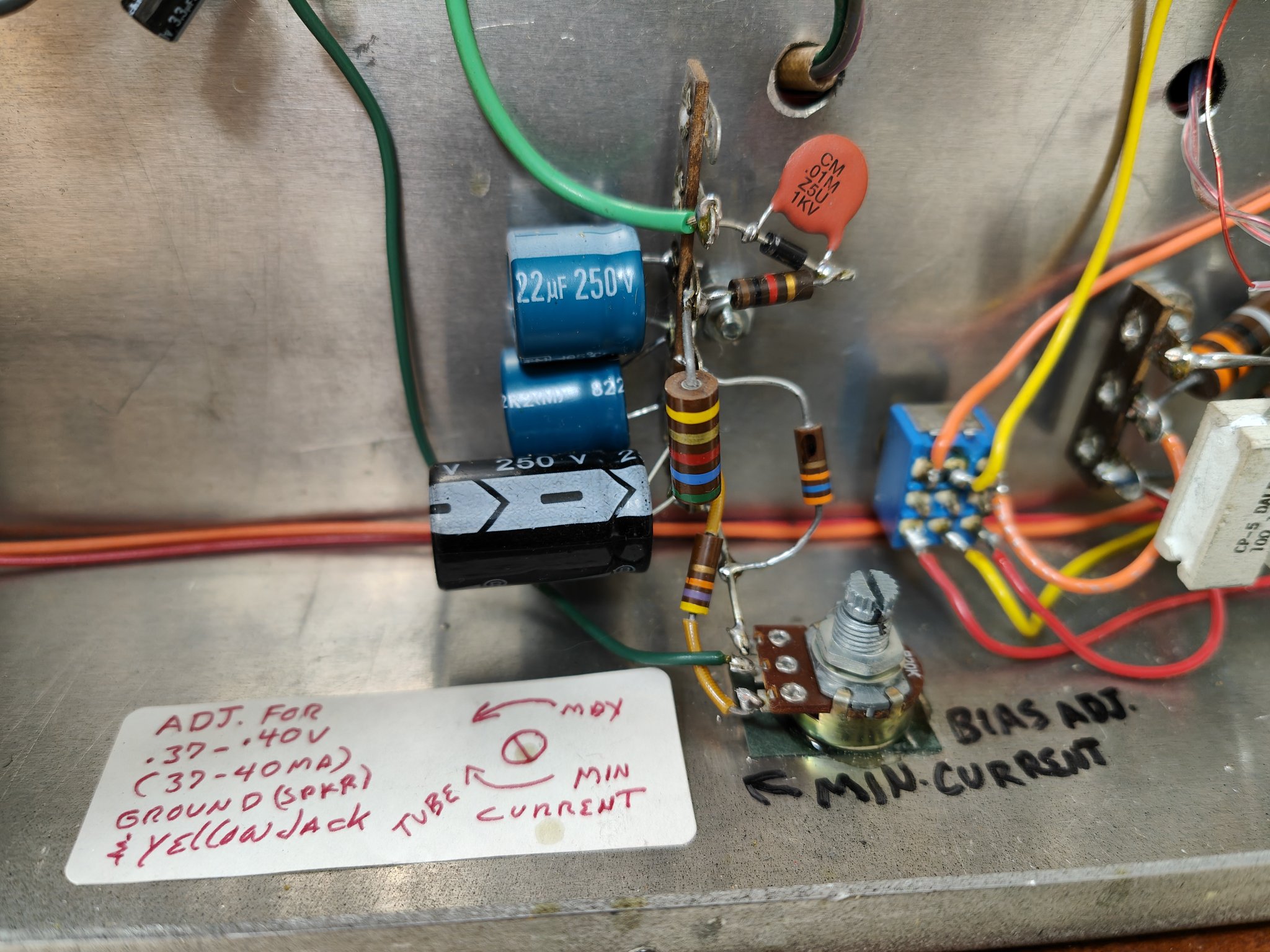

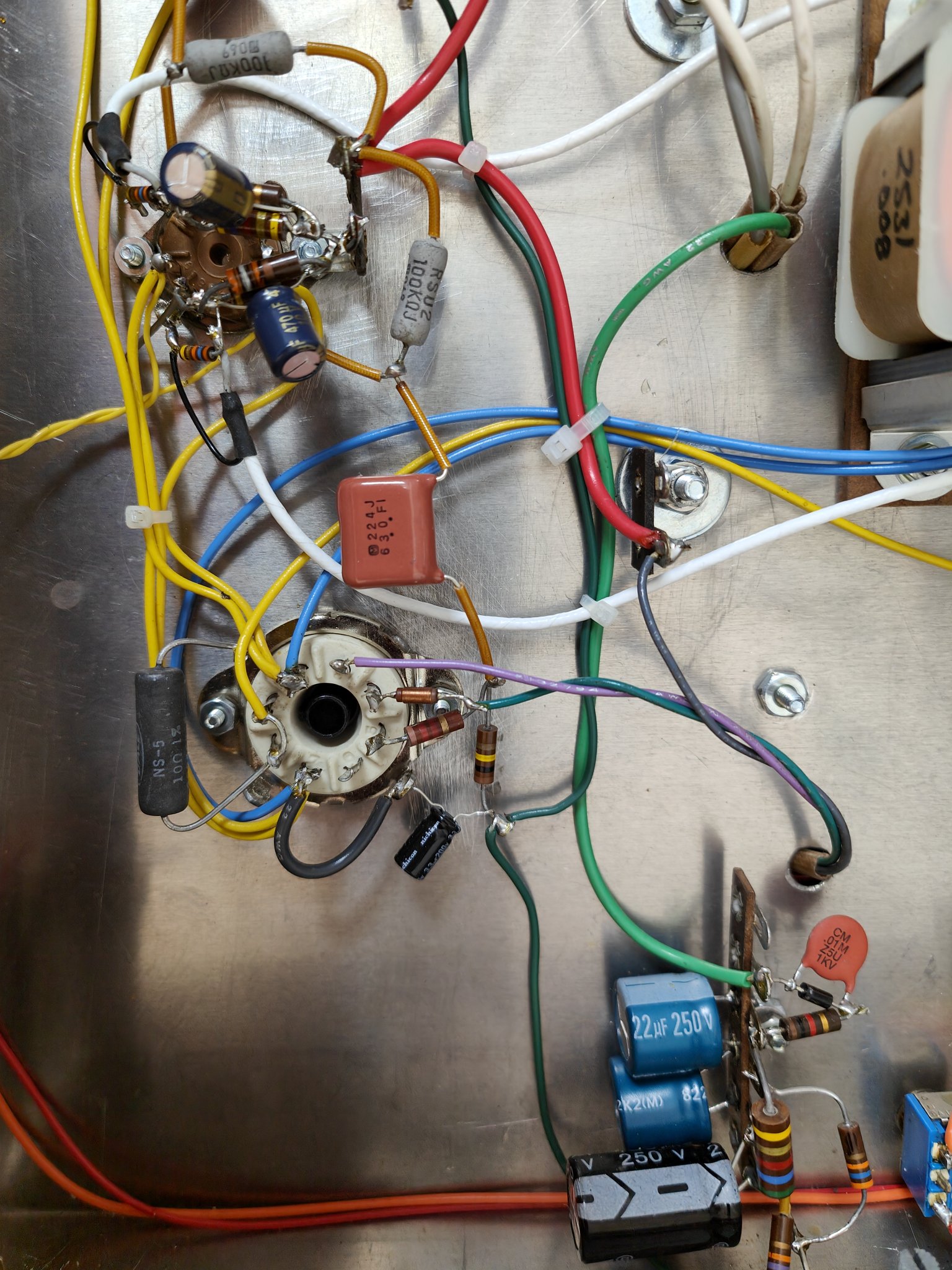

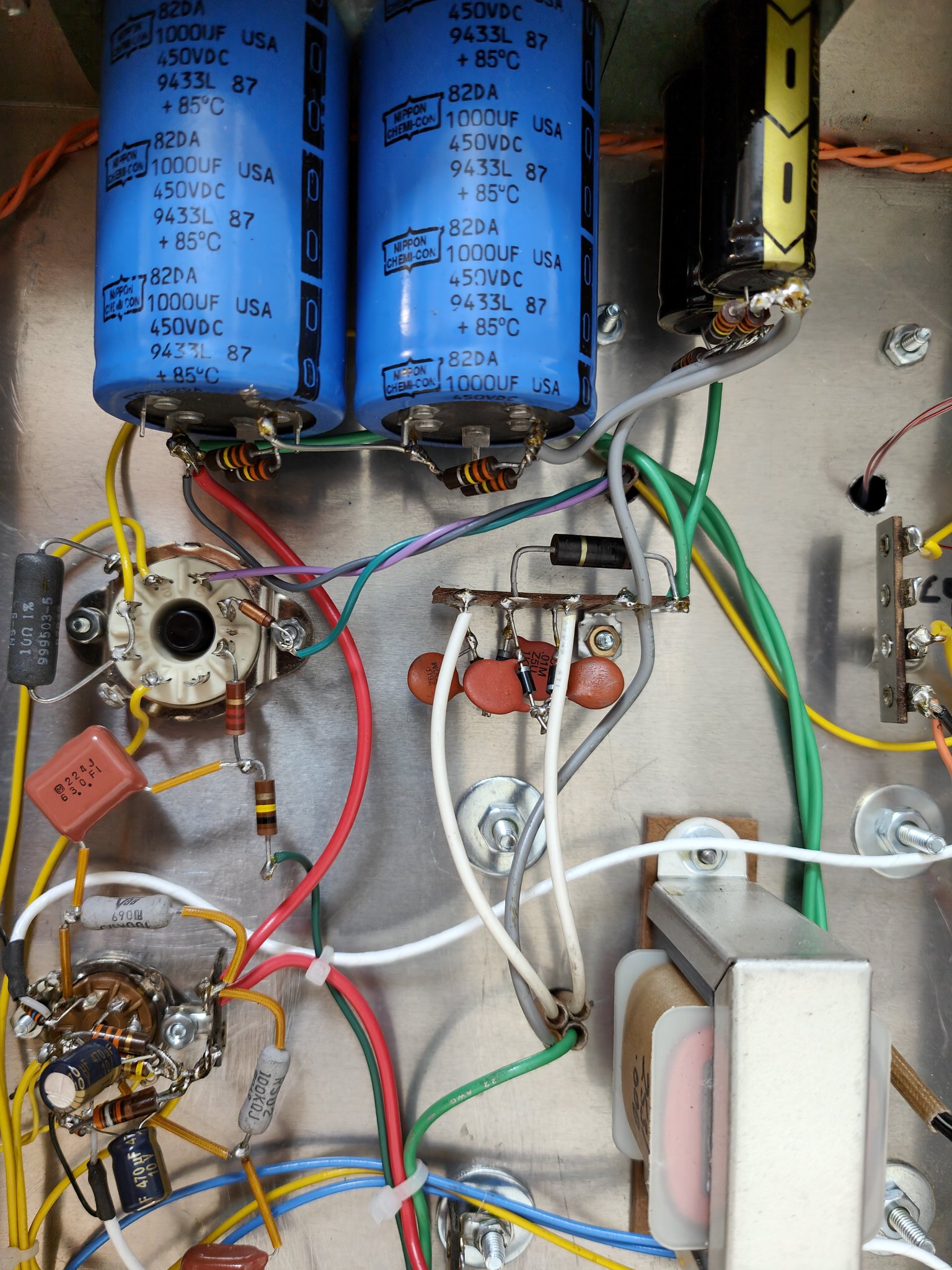

I've attached some photos of the internals of the amplifier along with the schematic again so it's all in one location.
Plenty of space in the chassis to do some suitable modifications.

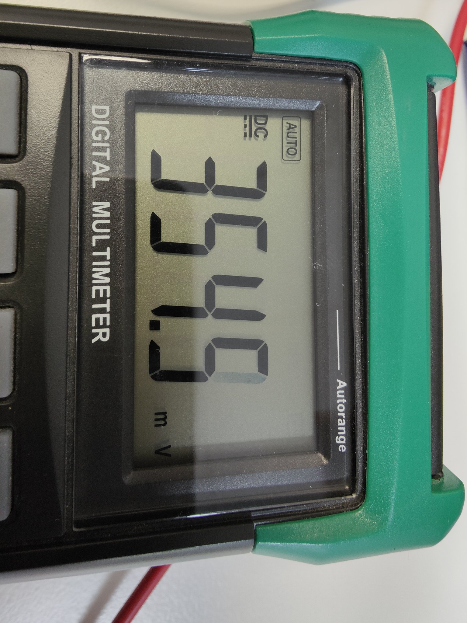

The bias should measure between 37mV and 40mV but I can rarely (if ever) get two EL34s to be within this range. For example, at the moment the two Electro Harmonix valves in there are measuring 35mV and 40mV.
I really appreciate the input here as working on a circuit like this is new territory.
The amp itself performs nicely, mind you I am only comparing it to a 6V6 push pull and a JLH 1969 solid state amp - which are completely different topologies.
Sorry - the impedance of the output transformer I assume you mean at the speaker terminal, it's 8 Ohms. Any other details I'd need to check with the manufacturer.

Cathode Bias, The Great Leveler
I put this simple demo together a while back to demonstrate how cathode bias stabilizes the tubes operating point.
In this case the tubes are 6V6s, one with normal emission, the other 25% low emission.
The cathode bias in this example gets the emission to only 9% difference.
For Cathode Bias all the Reactive Impedance's drop out of the calculation of steady state, Only the DC values are required.
Running a nominal 625V B+ on the screen of EL34 with a max spec of 500V is somewhat adventurous.😱
What happens if the supply line goes high? This amp would probably not pass UL. 👎

lordearl,
37mV and a 10 Ohm cathode resistor = 3.7mA
40mV and a 10 Ohm cathode resistor = 4.0mA
Not working well
Perhaps your cathode resistors are 1 Ohm, then . . .
37mV and a 1 Ohm cathode resistor = 37mA
40mV and a 1 Ohm cathode resistor = 40mA
That is more like it.
Sorry just switched to auto range on the multi meter it looks accurate, here are the readings. Cathode resistor is definitely 10R.
Higher than rated voltage on a screen is one of my most unliked conditions for a vacuum tube.

Thanks for this @jhstewart9 and @6A3sUMMER, this is somewhat alarming.
I am rather concerned and so would like to modify the circuit to have safer operating conditions, and to be self biased.
What is the step by step process I will need to follow to make the necessary changes?
Those voltages are 10 times larger than 37mV and 40mV.
Your meter readings show much more correct voltages of 354.5mV and 395.7mV.
35.45mA and 39.57mA.
Much better!
Change your B+ filter to a Choke Input Filter. You have way too much Screen Voltage. It will work until it blows up!
Much better!
