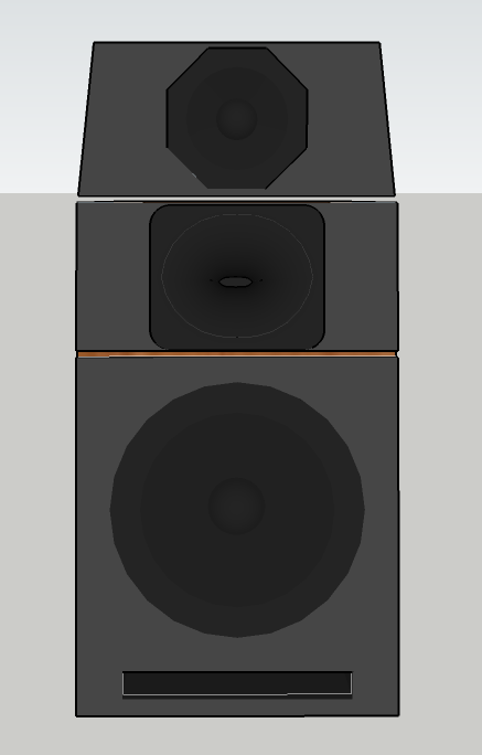

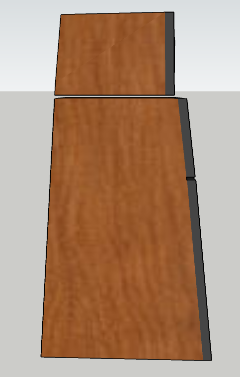

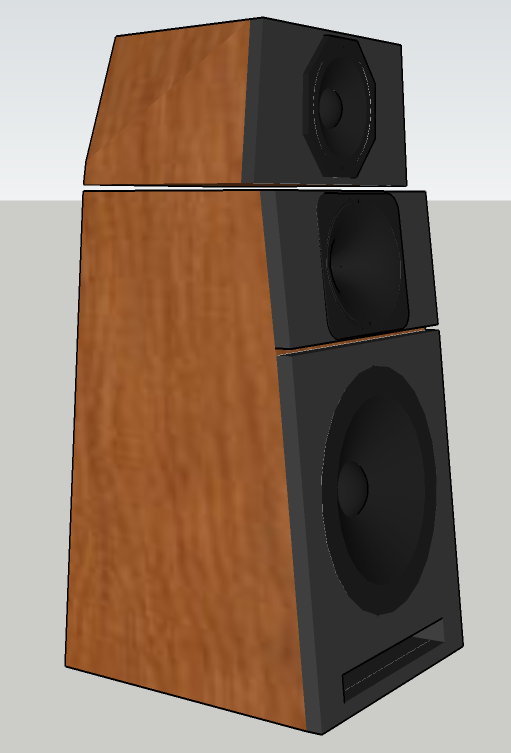

I further modified my design, changing the width of the medium driver cabinet to be the same width as the rest of the speaker, and also adding four routed holes on the top of the bottom cabinet, so the medium cabinet 'clicks in place' down to the millimetre, ensuring time adjustment is always spotless.
Excited to see your finished speaker!
Here are some pictures to make it clearer. I'll make a plan soon with precise measurements of the inside and outside of the cabinet.

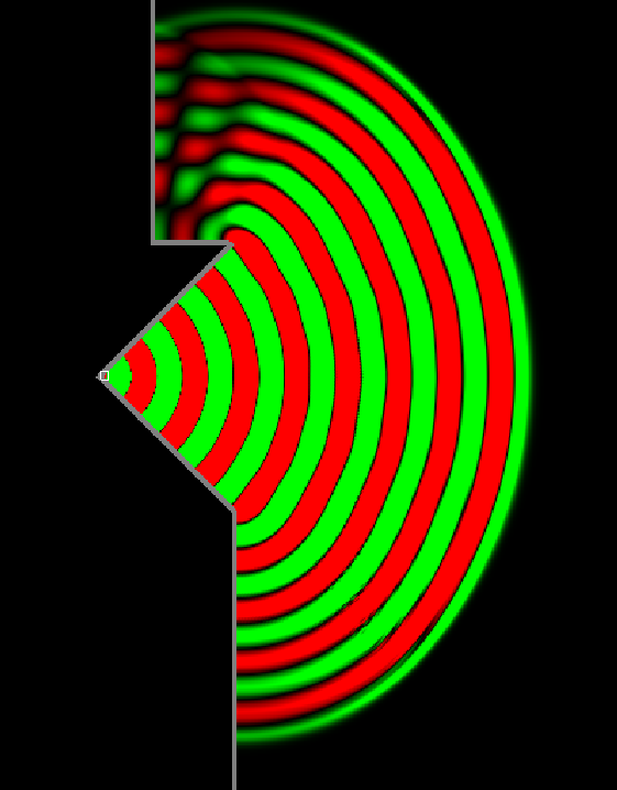

Bumping this thread reminded me of a simulation I was going to attempt earlier. It is just suggestive as it isn't to scale, and not all the diffraction sources shown are obviously visible. It does however demonstrate how the outer baffle regions can still have an effect, as shown by how different the top and bottom are.
