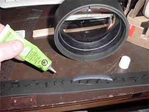

I modified my triplet just to get a bit more resolution to throw.
I use a 92" 9X16 screen at 14 feet and 4 inches, so my used image was only about 830X465 pixels of a 15" 1024X768 monitor. After modifying the triplet I got 899X544 pixels to throw (a 15% increase in pixel depth), with mixed result.
I modified the triplet on the cheap(like 5 bucks), and I can put it back to normal if the picture can't be cleared up in the coming weeks with a bit of tweeking, no harm done.
More photos of the construction/destruction Here

Dogbite said:I modified my triplet just to get a bit more resolution to throw.
No harm done? You still wont have a working lens if you put it back together.

The unmodified 135mm triplet I got from DIYPC using a 330mm rear fresnel, 550mm 3Dlens front fresnel set up in a split design, and 17" LCD gives nice results except in the corners.
I grabbed a tape measure and set up some desktop items offset from the corners diagonally, and measured the viewable diagonal distance before the screendoor disappeared into the blur.
This indicated a display diagonal of 14.5 inches is quite usable. Pretty much agrees with Guy's comments above.
I have my PJ 10' from the wall, giving approx 102" diagonal.
On widescreen it looks wicked. You can sit pretty close without noticing the screendoor because of the relatively fine pitch compared to lower res displays. Even though the source material might not be high res, the interpolating/reconstruction filters on the video software make it disappear.
Slideshow with photos is stunning.
As I posted in another thread, the modified triplet did not seem to give as good an image. Maybe we didn't do a very good job realigning the lenses though...
