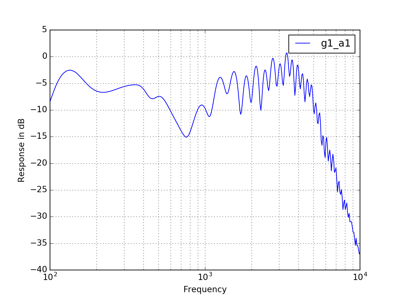

The attached image shows the measured frequency response of the speaker emulation filter in a certain commercial DSP modelling guitar multiFX box. The very ugly and very ragged frequency response creates a harsh and ear-fatiguing sound; those numerous sharp peaks and dips are not from the speaker, but the result of poor-quality speaker measurement without the use of an anechoic chamber or proper gating of the measured impulse response.
That measured frequency response curve came from here: Automating the Measurement of Frequency Response

As far as I know, a speaker frequency response curve is pretty much a speaker frequency response curve. There is no audible difference between the same frequency response implemented digitally, or by analogue means; the digital version often adds several milliseconds of delay, however, which can be undesirable in many situations.I guess it's much deeper and realistic than just shaping the frequency curve.

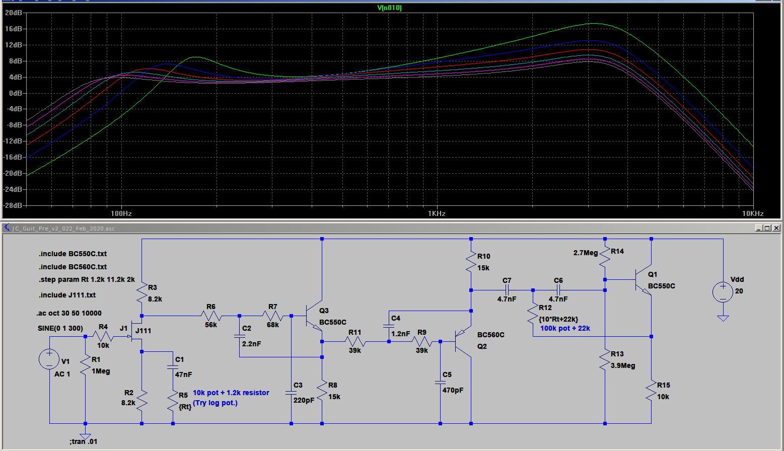

R4 foils attempts to get good gain control between stages.
The low impedance of a ADC (not DAC) is a heavy load for a vacuum tube or a 1Meg(!) pot.
Without R4 gain is 10,000 so the circuit needs some taming.
I have massively diverged this thread to offtopic (from what I was planning to what I actually need).
But out of curiosity, could you explain how a device which is capable of giving the 100x gain maximum (12ax7) can give 10000 gain in the circuit?
100 gain in first triode then 100 gain in second triode.
100*100 = 10000.
This is one of the reasons why decibels are such useful units.100*100 = 10000.
A voltage gain of 100 is the same as 40 decibels. Two stages each with 40 dB of gain add up to 80 dB of total gain. 80 dB is the same as 10,000.
As an aside, a typical 12AX7 gain stage only has a gain of about 50x - 60x (that's about 34 - 35 dB).
Two 35 dB stages, one after the other, combine for 70 dB total voltage gain.
But - in this preamp there is a gain control between the two stages; set to half-way, a log pot has a gain of one-tenth, or -20 dB. Now we're down to 50 dB total.
And then there is the attenuator at the output of the 2nd stage, with an gain of something like (1/60), or -35 dB if the diodes are just clipping at full tube output. Now we're down to +15 dB total gain, from guitar input to ADC input, with the preamp gain turned down to half-way on the knob.

That gave me deja-vu. I designed an almost identical circuit about 1986 or so, and built it into the DIY guitar I'd just finished building....JFET...this one: https://www.guitar-repairs.co.uk/FETPreamp.pdf.
The clever thing about this particular hybrid JFET/BJT hybrid circuit is that there is DC negative feedback via R7/R6, which makes sure the JFET is always properly biased, in spite of production variations from one JFET to another. (Most simple JFET circuits you find on the 'web are poorly designed and may not work at all, even when using the correct JFET type.)
However: R7/R6 also provide negative AC feedback. This makes the preamp itself very Hi-Fi, super-sterile-clean, with no "tubey" sound at all.
But if you put it in front of your new DIY tube preamp, it can drive those tubes harder, and make them sound more "tubey".

One of the key points why I've chosen that particular JFET circuit among other ones I've managed to find is that that circuit claims to be supporting various power voltages. The circuits out there are mostly designed to work from 9VDC, and I have a 12VDC as my primary power source. This particular circuit seems to be less of a hustle. I'll see, waiting for J201 transistors to be delivered.

2. As for the DSP, I use Teensy. It's an Arduino-like board. The latest version (4.0) has Cortex M7 processor which is 600MHz (!) and has a decent amount of memory. But the best part about it is that it has a really nice audio library. It's nicely structured, and practically has everything needed already (I2S input and output, effects). So that my work was not about writing audio firmware myself, but just combining the pieces properly together. The only thing is that it works with 44.1KHz/16bits only. But reading their forum, it seems to be primarily a marketing concern (people cannot hear the difference with bigger depth and sampling rate on the same hardware). So the digital audio software part is rather simple, because I reuse whatever is created by smarter people. Most challenging part was to understand how Biquad filters work in order to apply them for EQ and visualize them on LCD screen. Other than Teensy I use cheap ADC and DAC boards from eBay (ADC has PCM1808 and DAC has PCM5102A). And I use I2S to get the sound into the microcontroller and to send it out to DAC.
3. Given the above, Teensy has an integration with Arduino IDE, so, I program the thing with Arduino IDE.
4. For the speaker simulation, I'm also reusing something. There is an example on Teensy's forum which implements FIR algorithm. Under the hood it uses fast Fourier transform functions which are provided by the Cortex processor. On Teensy 4.0 it's capable of doing up to 22016 taps FIR. And that's the microcontroller's memory limit, as the processor could do twice as much. I've taken that algorithm, restructured it for my needs. And for now I limit it to 8192 taps, because otherwise, I have no space for other effects and I don't really hear much of a difference on the hardware I use. Plus, I've found a bunch of different IRs in the internet so that I can choose the best one for the moment (and some of them are far below 8192 taps).

That's a lot of taps!...8192 taps...

I have tried that JFET boost circuit. It certainly does something. I'm yet undecided if it's for better. The high frequencies feel to be more harsh when everything is at maximum, but that feels to be caused by the clipping. It even sounded a bit like digital clipping, so, I'll need to play with the gains in my code and with different environments to understand it more. But the midrange is more roary and still tubey with it. I suppose I'll have it behind a switch in the final thing, the thing it does actually feels a bit similar to the «bright» switch some amps have.
