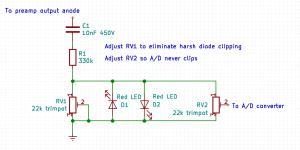

About my 4.3V zeners. I've found out that my ADC supports maximum 3Vp-p at the input. Whenever I was going gainier, I was getting a nasty dirt in the second (not yet connected) ADC channel. I tried to lower the zeners value, but 1.5V zeners (to get 3Vp-p) don't exist, I tried 3V zeners. Two observations. They are still not enough to limit the output enough. And they worsen the sound a lot at high gain, I suppose because they clip the sine wave too early and the sound becomes unpleasantly distorted. So, I've added a voltage divider (made of two resistors). And with the overdrive pedal and high gain/volume I still hear that unpleasant distortion coming from the zeners clipping the signal. So my plan is to put even higher value zeners (like 5V or 6V) and adjust the output voltage divider resistors accordingly so that they let only 3Vp-p through.

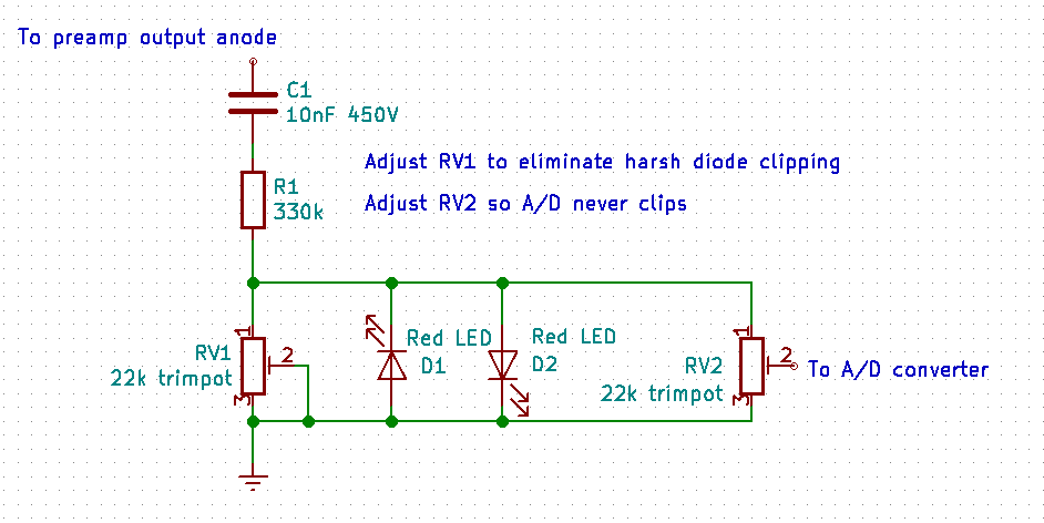

1.5k is "centre biased", and gives you lower distortion and more clean headroom before clipping. More Hi-Fi, less "tubey". Leo Fender used 1.5k a lot, most probably taken directly from the example circuits in the GE or RCA tube catalogues....cathode resistors...2.7K sounds more soapy to me and 1.5K sounds crispier.
So only 1.5 volts peak. Yes, that's too low for a zener diode!...my ADC supports maximum 3Vp-p at the input.
However, an ordinary red LED (usually about 1.4 - 1.8 volts) or two or three ordinary silicon small-signal diodes in series (about 1.5 - 1.8 volts) is a simple alternative.
The attached image shows my suggested circuit. The 330k resistor and first 22k trimpot (RV1) lower the dangerously high voltage from the tube's anode to a level fairly close to the LED threshold, while the second 22k trimpot (RV2) lowers the signal from the LEDs to less than 3 Vpp, to keep the ADC out of clipping.
To use, first adjust RV2 to a very low setting, low enough to guarantee the ADC doesn't clip.
Then increase RV1 to maximum resistance, and play a strong signal into the tube preamp input. You should hear harsh solid-state clipping from the two RED LEDs. Gradually decrease RV1 until the harsh clipping just disappears, leaving only tube clipping from the 12AX7.
Now go back to RV2, and gradually increase it until the ADC just starts to clip, then back RV2 down a little.

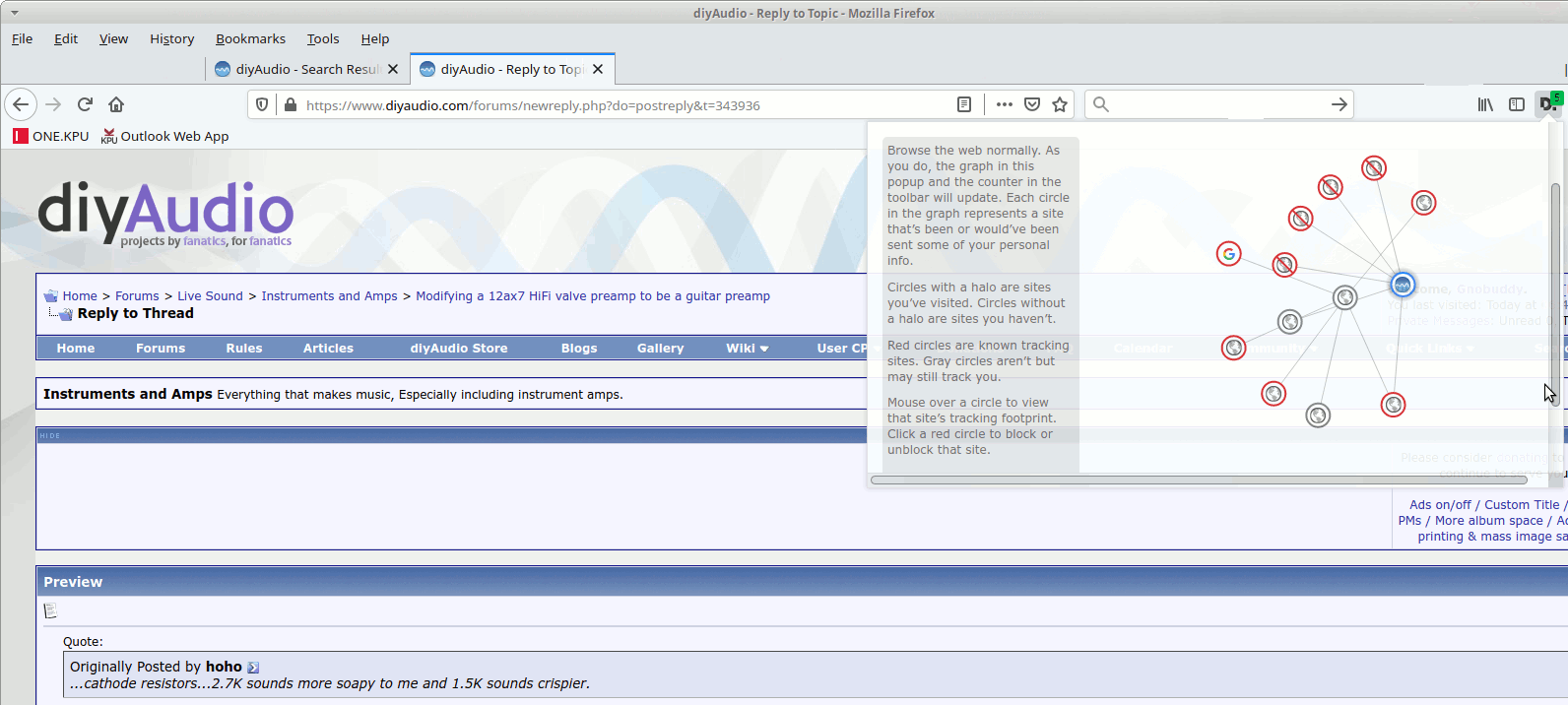

I do have a name, of course, but I prefer to keep it off the Internet as much as possible. There are far too many nasty online entities working hard to steal as much of our personal information as possible, and to use it against us. So why make it even easier for them by giving them my name?
The second image attached below shows about a dozen nasty websites trying to spy on my Web browser at this very moment, as I'm typing this post into diyAudio. All those red circles are known tracking sites...and most of the grey ones have no business spying on my browser, so they're probably tracking sites as well.
Please note that I'm not suggesting that diyAudio itself is doing anything nasty. The nasties currently trying to track and spy on me include gstatic.com, newrelic.com, and a number of Google sub-domains, all surely reporting back to the One Tracker To Rule Them All, Google itself.
-Gnobuddy

Do you think there are advantages of the circuit you've given comparing to the resistor limiter? It's just two zeners plus two resistors seem to be easier.
My logic is that if I choose the right zeners, I will have a known maximum output limit, from that maximum limit I can just calculate the resistor for the voltage divider (for example, if I have 6V zeners, I have 12Vp-p maximum output, then it's 30K and 10K resistors, to get 3Vp-p and keep the same 10K impedance).

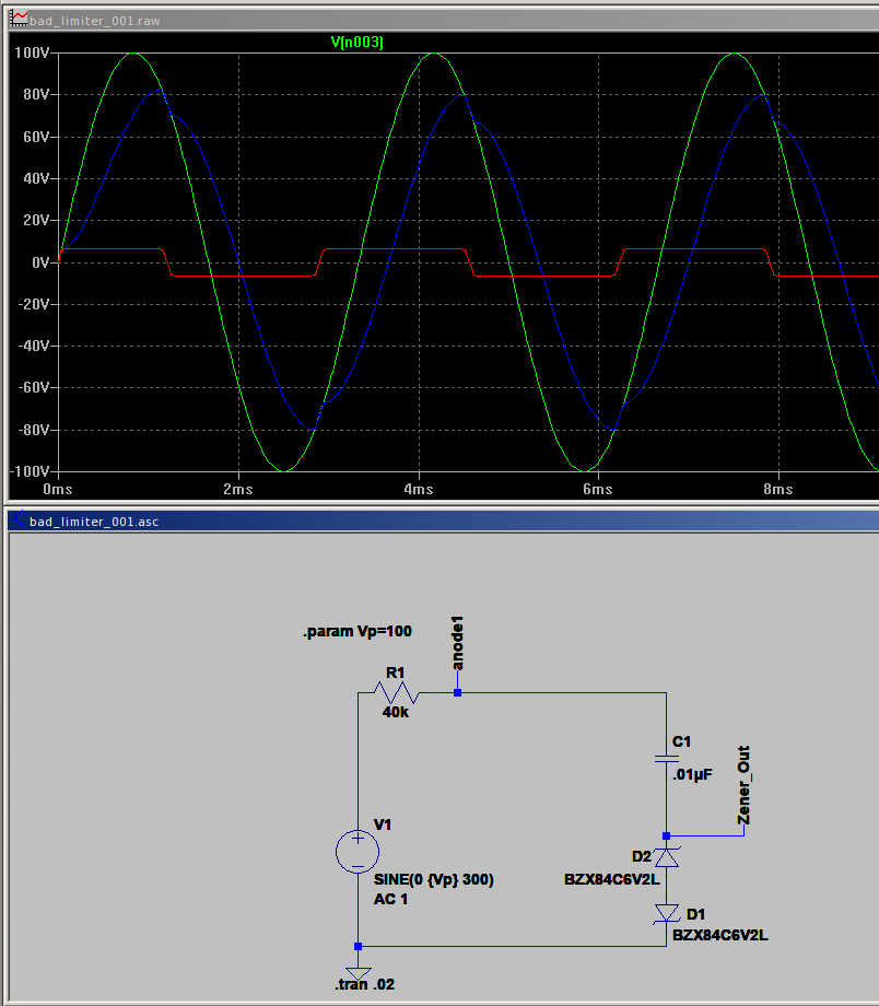

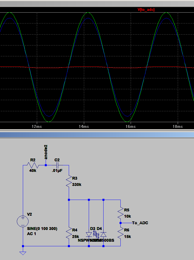

Mind posting your circuit? I can give a more informed opinion if I'm sure exactly what you're planning.Do you think there are advantages of the circuit you've given comparing to the resistor limiter? It's just two zeners plus two resistors...
But making a guess as to what you have in mind, yes, I think there are advantages; I don't think your circuit has any way to extract maximum "tubeyness" from the triode without also getting harsh gritty horridness from the zeners, and I think your circuit may have a bass frequency response that varies wildly with signal level. I may be wrong, as I haven't seen your schematic yet...
Life is rarely that simple in the world of analogue electronics, which is why digital circuitry is usually much simpler to understand. 🙂...I choose the right zeners I will have a known maximum output limit...if I have 6V zeners, I have 12Vp-p maximum output...
Firstly, you have two zeners in back-to-back series; each one has a voltage drop, so even if one dropped exactly 6V, your total voltage drop would be more than that.
In reality, the zener that's forward-biased will have a voltage drop of somewhere between 0.5 V and 0.7 V, usually, but it will vary with temperature, zener current, and from one manufacturing batch to the next.
The one that's reverse biased may be supposed to conduct at 6V, but in practice, there is quite a soft "knee" to the curve, particularly at the tiny currents used in this circuit (which are far below datasheet minimum zener current specs.); the voltage climbs slowly through the knee as current increases. There is also a tolerance (typically +/- 10%) to that 6V rating, and there is a temperature coefficient as well.
So, even if operating within datasheet current specs, that "6V" circuit might actually give you 5.9 V (5.4V zener + 0.5 V from the second zener), or it might give you as much as 7.3 V (6.6V zener, 0.7V second zener), and both numbers will change with ambient temperature, and with zener current (which means with how hard you drive the tube preamp.)
Since the circuit is actually operating at far lower-than-datasheet currents, real-world voltage drops may differ significantly from the estimates above. Short of measuring it (using a known precision attenuator feeding your ADC, or a 'scope!) it's hard to even guess what you might end up with.
LEDs also have a soft knee, forward voltage isn't even specified, and the same sort of temperature and manufacturing variations occur. But LEDs are less noisy than Zeners, they're probably cheaper than zeners, and the "knee" voltage is (ballpark) closer to what you need. The last few red LEDs I've measured usually dropped around 1.8 volts, plus or minus about 0.1 volt.
Notice that the two LEDs are wired in reverse parallel in the circuit I suggested, and not in reverse series like the zener diode clipper...if you do decide to go with the LED circuit, this is important!
Because ADC clipping sounds utterly horrible, I suggest staying well below 3 Vpp. Staying 6 dB below that is about as far as you should even consider pushing it - that means never applying more than 1.5V pp. (Yup, the MSB in the ADC will never toggle!)...then it's 30K and 10K resistors, to get 3Vp-p
In fact, a rule of thumb for feeding audio to ADCs is to set peaks to 10 dB below clipping. This throws away an unimportant bit or two of resolution, but much more importantly, keeps you from ever hearing that utterly horrible sound of a clipping ADC. When you have 16 or more bits of resolution to play with, this is a very worthwhile tradeoff.

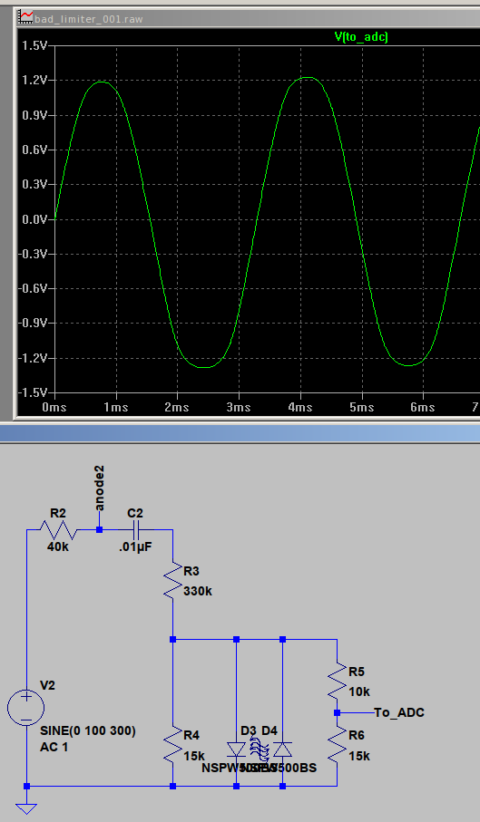

But going back to the schematic things. What I currently have looks like:
I suppose I should certainly try your way (luckily I've recently received a pack of variable resistors). Especially if it promises lower noise and better frequency response.
Code:
>---|------------[ R 30K ]---|--------------->
| ZD1 (6V) |
| [ R 10K ]
| ZD2 (6V) |
Thanks!

Thanks for the (ASCII) schematic! 🙂Code:>---|------------[ R 30K ]---|---------------> | ZD1 (6V) | ▼ | | [ R 10K ] ▲ | | ZD2 (6V) | >---|------------------------|--------------->
Here's the thing: a triode is very linear at small signal amplitudes, so if the signal is very small, there's no "tubey" distortion, and a 12AX7 won't sound any different than a solid-state op-amp. To get audible amounts of "tubey" sound (i.e. distortion), you have to drive the triode until it's spitting out a large signal - tens of volts, and maybe as much as 200 volts peak to peak, roughly speaking (depends on B+ voltage, anode resistor, tube used, etc, etc.)
So what happens if your second triode is spitting out a slightly distorted, "tubey" sounding signal, two hundred volts from peak to peak, and you then brutally throw two 6V zeners across it, as the clipping circuit above does?
Well, you clip the heck out of the signal! Instead of hearing subtle tubey distortion, you hear a crude solid-state fuzz box, like the ones Jimi Hendrix used. The entire point of using a tube is gone, flushed down the toilet; you might as well have used any of a number of $20 fuzz pedals from Ali Express.
The frequency response problem is a secondary one; a 6V zener diode goes from having extremely high resistance (hundreds of thousands of ohms) at, say, 4 volts, to having very little resistance (a few ohms) at, say, 6.2 volts. So the coupling capacitor from the second triode's anode to your zener clipper is "seeing" a load that varies abruptly between hundreds of thousands of ohms, and just a few ohms, twice on every cycle. There will be some sort of average resistance, which will depend on how hard you're clipping the zeners; and that average resistance will set the bass response. The harder you clip the zeners, the less bass will appear at the output.
So the circuit as shown isn't ideal - in fact, it has serious flaws.
But the flaws are not hard to fix. If you want to preserve the "tubey" distortion you worked so hard, and spent so much money and time to achieve, you need to take a different tack - first, allow the second triode to gracefully go all the way up to nearly its maximum output signal (probably around 200 Vpp), while still sending less than 3 Vpp to your ADC.
This means you need attenuation - lots and lots of attenuation, cutting down the signal to maybe one-hundredth of its original size. Because we don't know exactly what the maximum signal out of that triode will be, it's best to have adjustability.
So that's why I've used a big resistor (330k) and a much smaller trimpot (22k).
Having attenuated the signal down to a level that's probably not going to kill the ADC, we now want the finishing touch: a subtle clamping / clipping circuit that only comes into action if the worst is about to happen - if the ADC is about to be overloaded.
That's where the back-to-back LEDs or zeners come in - but we want them to stay off, and do nothing, so they don't generate crude, nasty, solid-state diode clipping distortion. The exception is if the ADC is about to overload, which makes an even nastier noise. In that case, and only in that case, we want the LEDs or zeners to clamp the signal - even nasty diode clipping is not as nasty as ADC clipping!
I'll try and put together an LTSpice simulation and some simulated waveforms for you tomorrow if I can, but I have other stuff I have to do now. Tonight is music jam night...but the snow is falling, and I need to contact my fellow jammers and see if people want to brave the snow tonight, or call the whole thing off. 🙂
-Gnobuddy
Here are some simulated waveforms to show what I was trying to describe in words yesterday.
The attached image shows the uncorrupted waveform "inside" the 12AX7 in green. Attaching the two-zener clipper and series coupling cap to the anode distorts the anode waveform into the shape of the blue line at the anode - note the heavy distortion at the points corresponding to zener conduction. (This will sound "buzzy" and harsh.)
Finally, the red waveform shows what comes out of the zener clipper - this is not subtle tube distortion, but rather, crude fuzz-box distortion that owes nothing to the tubes, and everything to the zeners. Harsh and buzzy is probably an understatement for what this will sound like!
The trouble is the huge gap between the 200 Vpp output of the tube, and the 6 - 7 Vpp clipping threshold of the zeners. Without attenuation between those two, the zeners will just clip the heck out of the signal from the second triode's anode.
-Gnobuddy
-Gnobuddy
And here's what LTSpice thinks the circuit I proposed in post #52, the one with the resistors, trimpots, and two LEDs.
The first image attached to this post shows the same three signals as in the zener clipper. This time, the 330k resistor (R1) prevents LED conduction from causing any nasties in the anode waveform at the triode. Because of this, the blue anode waveform has the same shape as the green "imaginary, inside the tube" waveform.
The second image attached to this post shows only the output waveform to the ADC. There is barely a hint of waveform distortion - the tips of the sine wave are just a bit soggier than they should be. The 22k (or 25k, depending on which country you live in) trimpot has been adjusted to keep the LEDs out of conduction until they're absolutely needed as a last resort. (Note that this is the same signal as the red trace in the previous image - LTSpice picks colours based on how many traces you're graphing, and the very first trace is always green by default.)
Because of the attenuating resistors, the tube preamp can spit out 200 Vpp, and the signal to the ADC is limited to about 2.5 Vpp, but this time, without additional gross solid-state distortion.
In practice, the trimpots would be adjusted using the procedure I outlined in post #52, ideally, using an oscilloscope to supplement fallible and inaccurate human ears.
-Gnobuddy
-Gnobuddy

This is the trouble with not having a schematic of what you're actually building.But I also already have a master volume knob at the output of my preamp.
If you could hand-draw a schematic you've actually built, complete with all pots, photograph it, and post it, it would help to avoid some of these dead-ends.
So: where have you placed your master volume? What is it intended to do?
In the original application decades ago, the master volume let the preamp generate distortion independently of the power amplifier.
But you're digitizing the output of your tube preamp. Either you're planning to feed the digital signal direct to a computer, or you're going to use a D/A to convert it back to audio after your DSP filtering, and that audio will drive the power amp. That's where the master volume should go, after your D/A, no?
I don't think it should be between ADC and tube preamp; if you turn down the master volume and also drive the tubes gently to get clean tones, you'll get poor bit resolution from the ADC. There is also the problem with matching the high output impedance of the tube to the low input impedance of the ADC. And finally, if you turn up your master volume too high, your ADC will clip and distort harshly, or the carefully designed subtle diode protection circuit will have all the subtlety removed, and become a harsh diode clipper.
I think the way to do it is: tube pre, trimmable attenuator, protection diodes, ADC, your custom DSP filters, DAC, master volume, power amp.
Am I misunderstanding your intentions in some way?
-Gnobuddy
