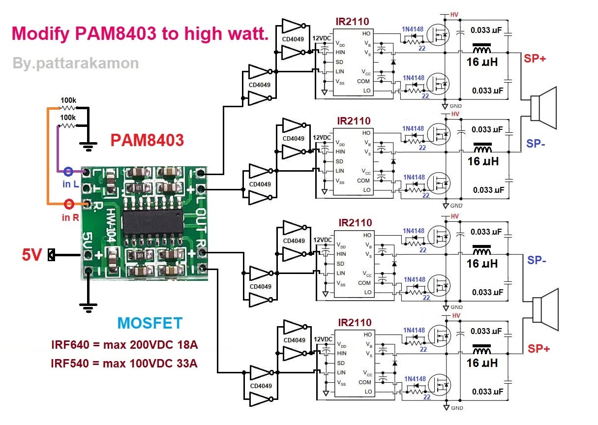

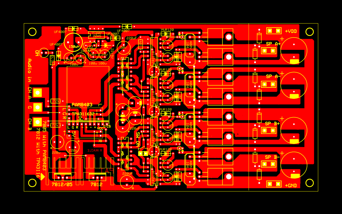

Modify PAM8403 and TPA3116D2 to high watt

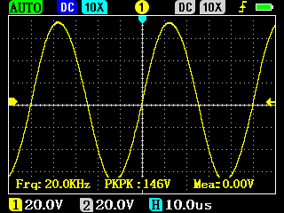

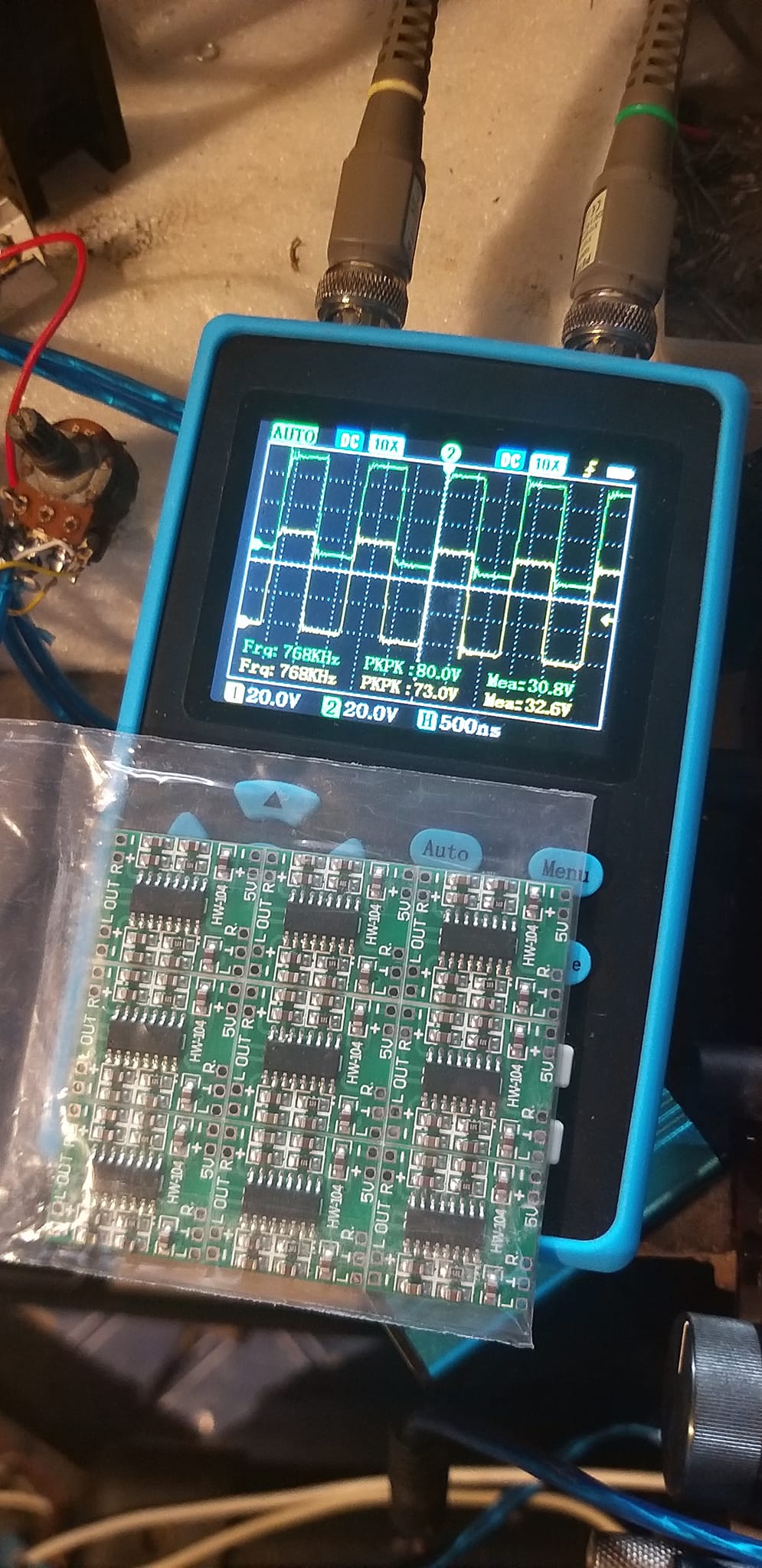

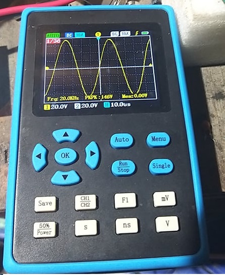

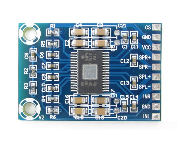

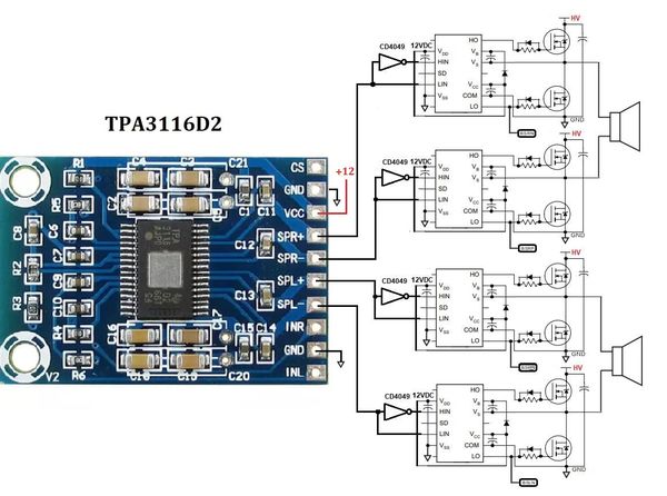

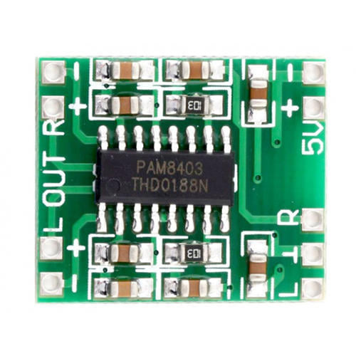

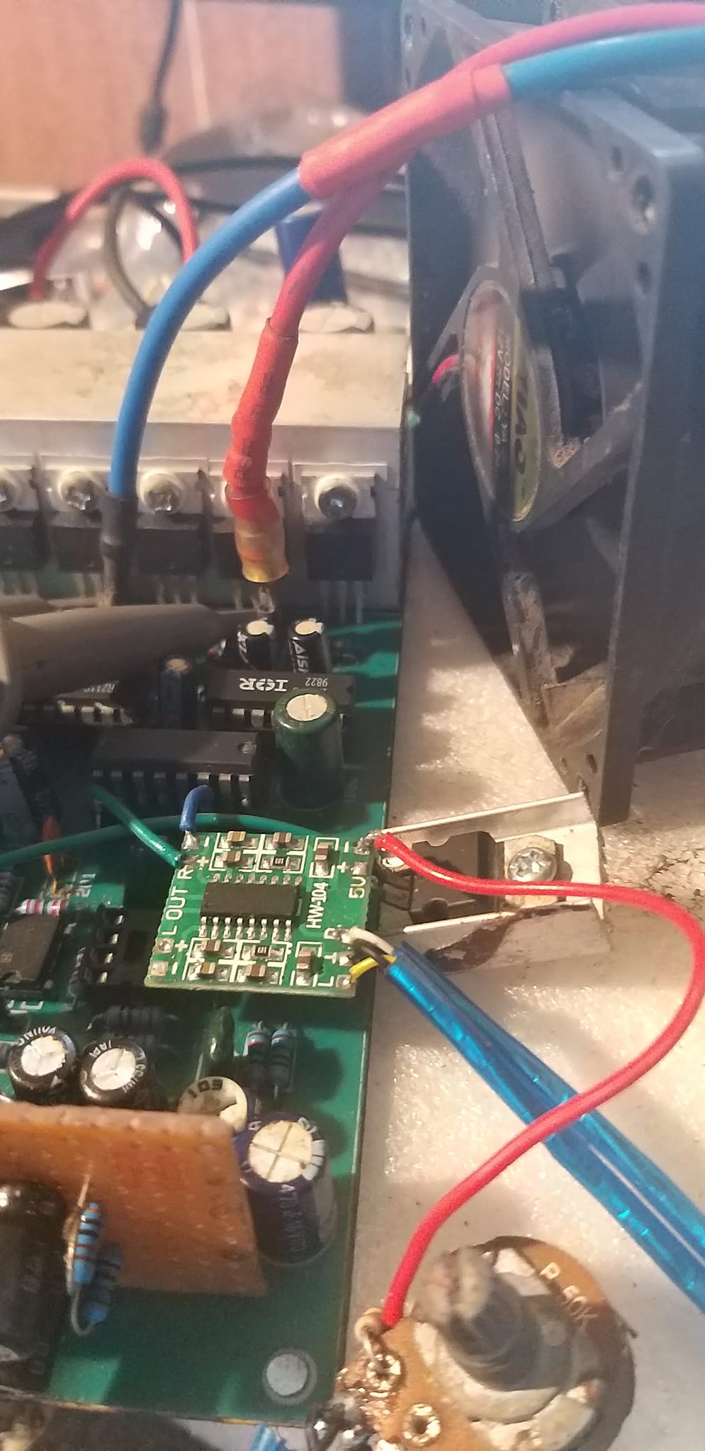

I have implemented PAM8403 and TPA3116D2. Let's use the PWM signal to increase the high volts in the circuit I designed. It works well. I recommend it to work in the line, the short range speakers are safe and sound good. But if using a long cable, it should use a filter core.

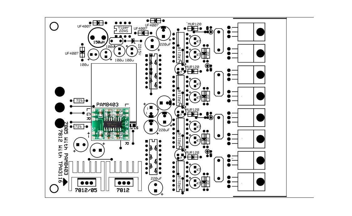

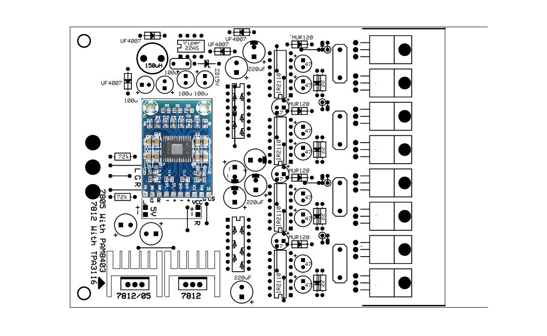

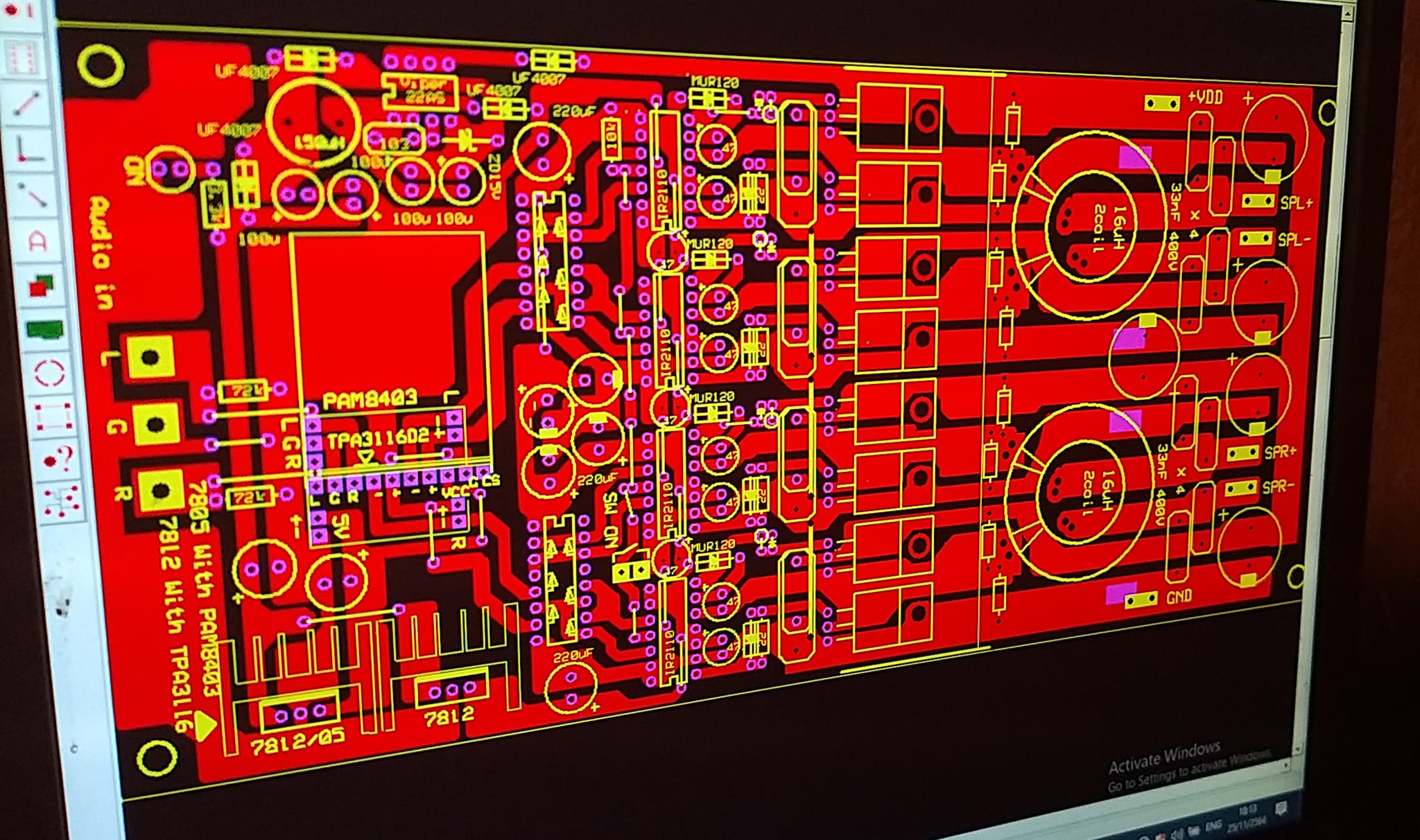

This is the PCB
This is the PCB that I designed to work with these two numbers.

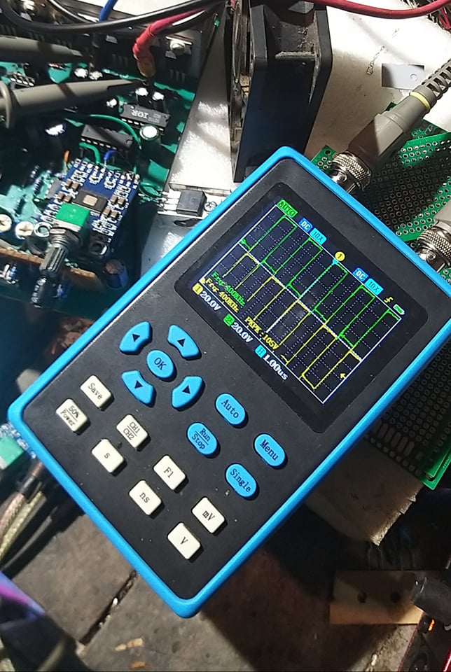

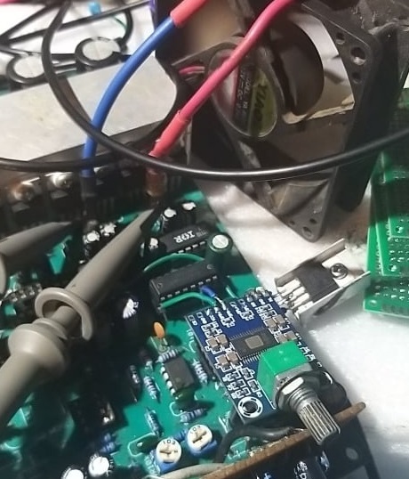

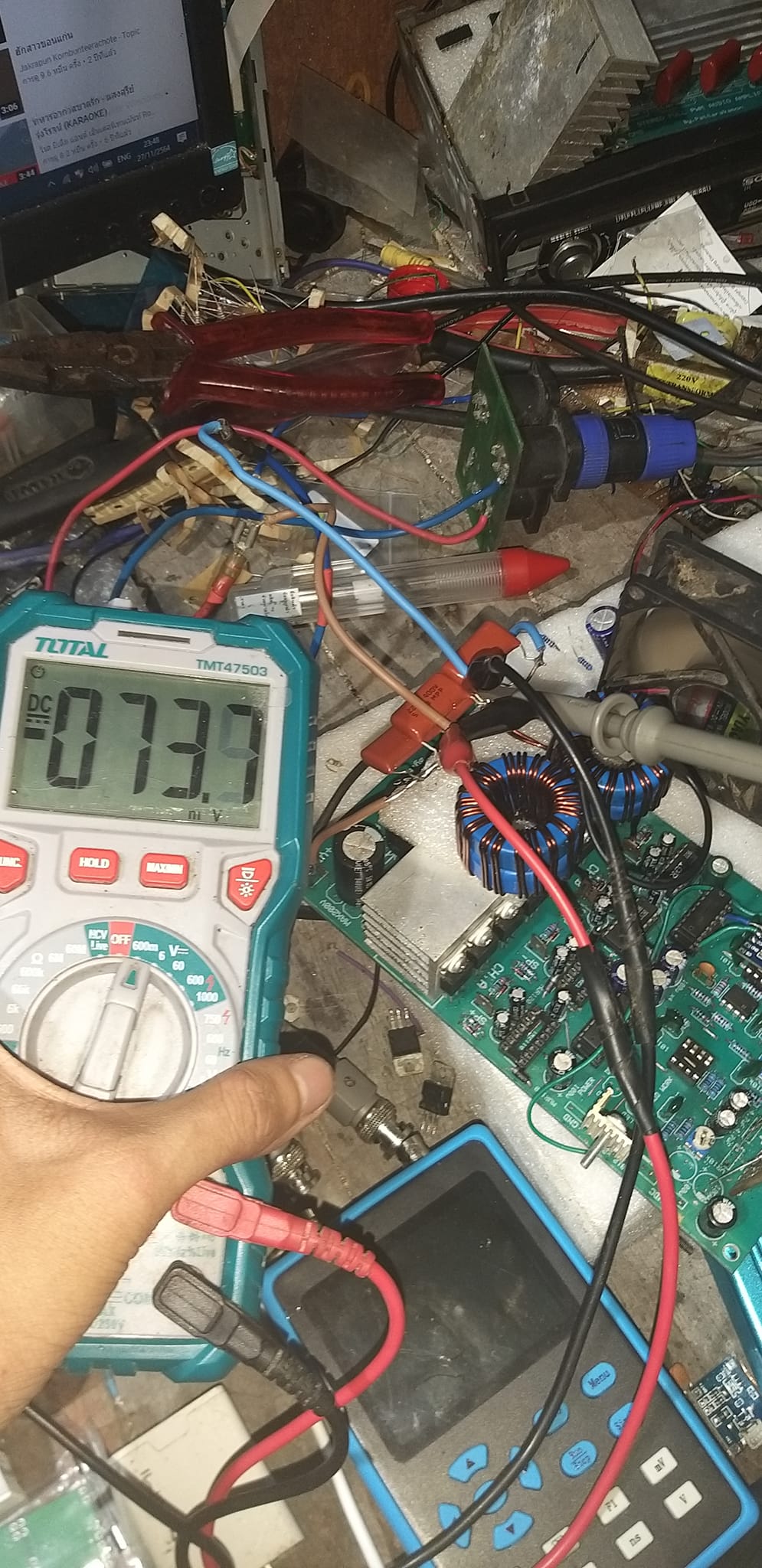

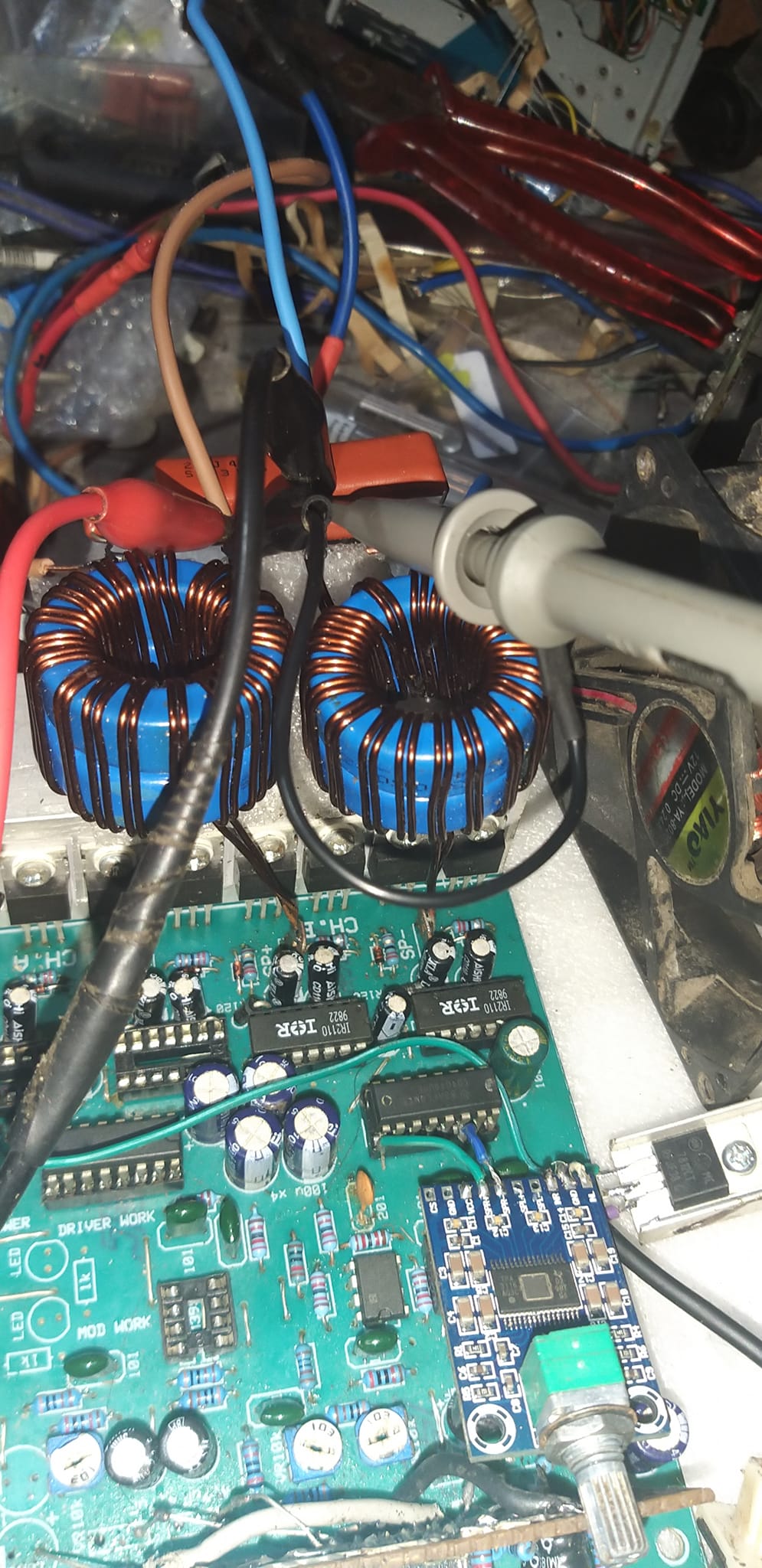

Test +filter coil
TPA3116D2 to high watt +filter coil test.
No feedback, offset 73mV

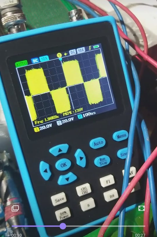

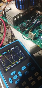

Behind the filter core is a SPWM wave that changes according to the audio signal. It causes the carrier to be completely wiped out. And this TPA will resist clipping in the volt peak.
