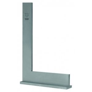

About the holes: please use the tool (forgot the English word) to have an exact straight line and check the RCA connectors you bought beforehand how much mm they need inbetween them. Too much looks weird but too close and you can not use thick RCA connectors. Probably 4 extra mm are needed compared to the original ones if you buy fancy gold plated ones with insulation rings. You can determine the right distance when "dry testing" with just the insulation rings together and your RCA plugs on a table. Measure the distance between middle points.
Put a mark with a felt pen on the step with the right diameter. Let the drill do the work and just pay attention on exactly the right spot. Take the time and let the drill cool off in between and after cooling check if the plastic insulations ring fit in the hole (the smallest ring) as too small is a smile and too large is bad for your temper. Deburr when necessary and clean. A little bit of black paint helps against corrosion.
* since you already replaced the 4558 for new 4558 (why?) and will solder a socket and then a final opamp the chance is pretty high that PCB tracks peel off. Five times soldering is too much for Pertinax. I would now suggest to leave the opamp where it is.
...and, needless to say, always use high quality tools. Buy a step drill like this one.
This really isn't a cheap one, but you won't regret it. This drill reliably prevents from ridges at the inside and presents remarkable longevity. There's even a three drill assortment by the same manufacturer. Hopefully you will find adequate tools in your country.
Best regards!
The tool.

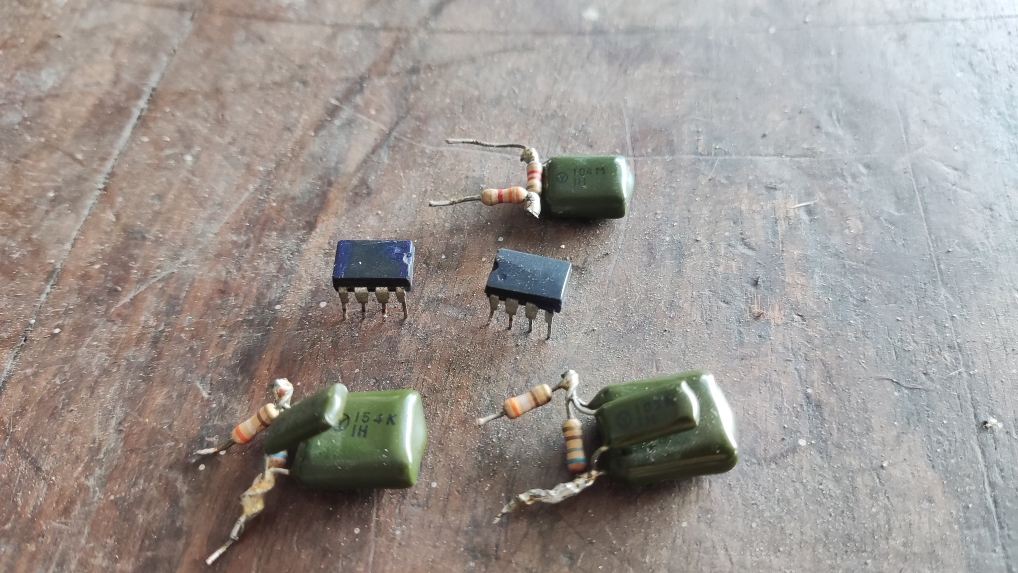

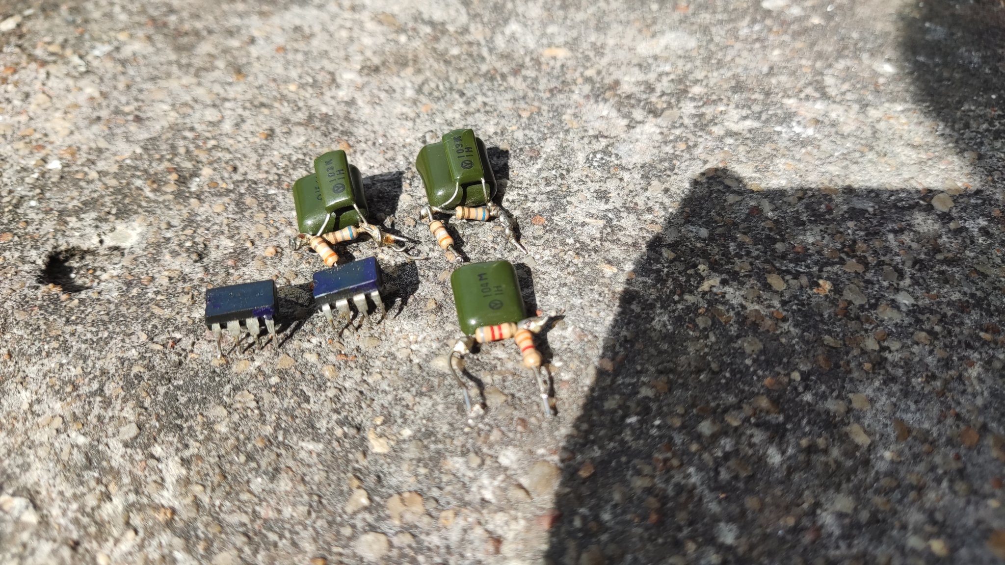

@Mooly @jean-paul the owner or the tech guy maybe from the previous owner was doing something strange, put an ic QE01 and QE02 and modify resistor and film caps around the ic, then paint it purple to cover the ic number/model. That is why i replaced with the closest based on service manual and other photos on the web.
Here it was:
There is another one missing that same as the far right bottom in the picture that has marking 104M i threw it.
I forget to take picture before replacing them.

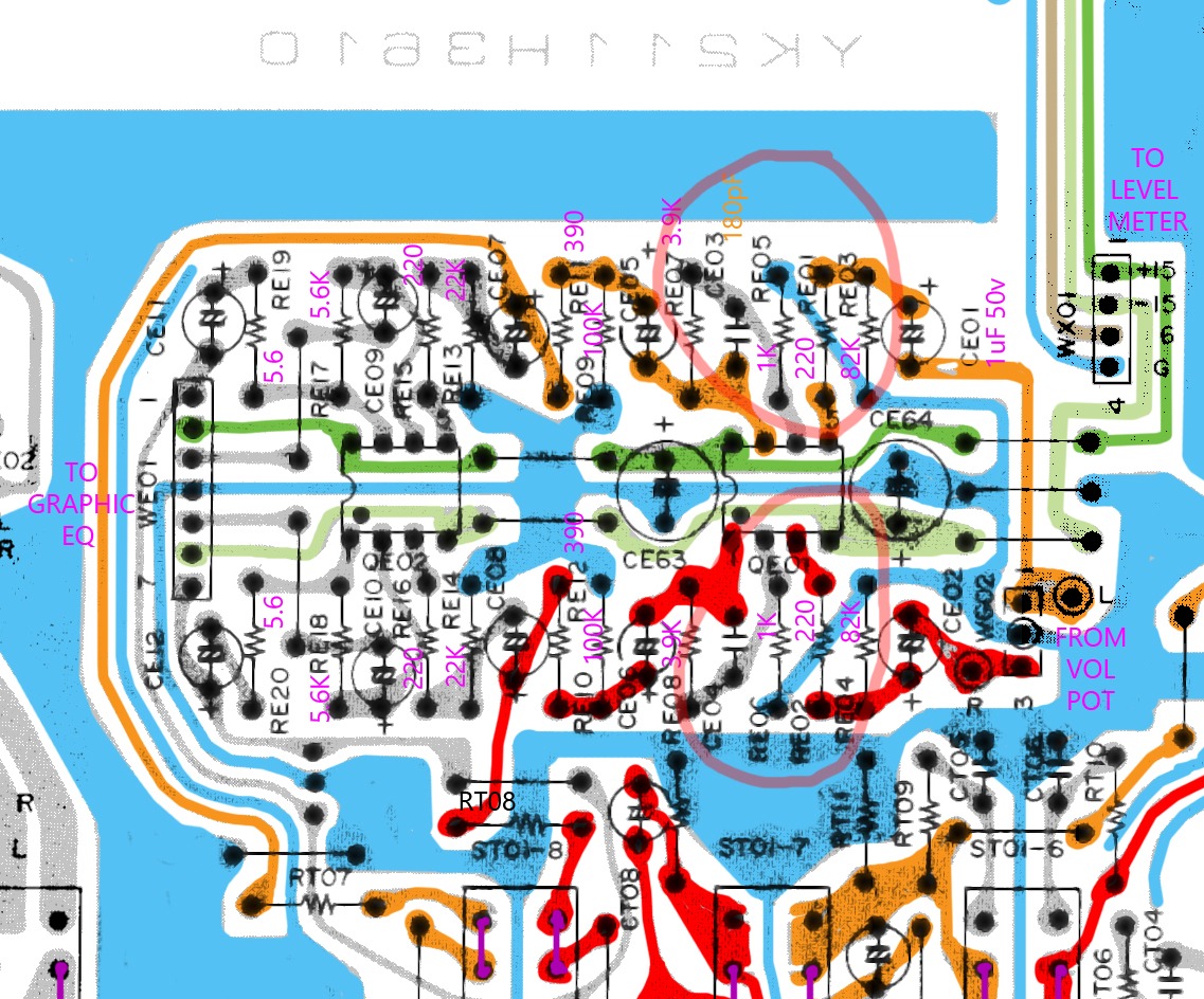

The area they modified (red circle)
what i remember is i must find CE03 and CE04 (both same 180pF) to replace that greeny strange stacking films.
QE01 is configured as a simple gain stage with a voltage gain of 4.9. That is determined by the 3k9 and 1k resistors. The 180pF cap rolls the gain off at high frequencies (past 100kHz) and so plays no part audibly as such. If those values have been altered the gain has been altered.
