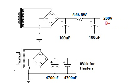

Sorry, I meant something like this (in the attached schematic).
__________________
Or, you could take your circuit with the two 100uF capacitors and replace the 2.2k ohm resistor with a 5.6k ohm 5W resistor. But the one I drew will give you a much more quiet supply.

Sure, that should work fine.
The thing to worry about is the wattage rating of the resistors you use.
If that 2.2k resistor is dropping 35V (let's say), then 35/2200 = 15.9mA (0.0159 A).
If you put a 5k resistor there, and it drops let's say 14mA (0.014 A) then
5000*0.014 = 70V, and you might get 230V B+. But that would be helpful (half of 230V is 115V, which is within spec for the 6DJ8s' plate-cathode voltage).
If the 10k ohm resistors in parallel drop 70V with 14mA across them, they'll be dissipating 1W altogether. So each resistor will be dissipating 1/2 a watt. Make sure each 10k resistor is rated for at least 1W, although 2W rated ones will be much better (they won't get so hot).
