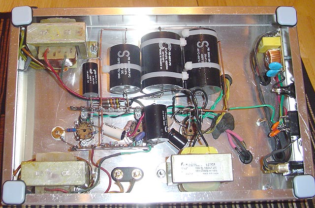

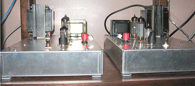

Don't know if I could afford all of that inductance
In the upstart 2 of the pieces of iron are two of the same (German) OPTs, one used as a parafeed choke. Parafeed swaps a cap for a non-gapped OPT. I don’t feel it is necessary.
There is only 1 filter choke, 100 mH Hammond, we bought a box of them they were something like $15 CAD each. The flter choke is very important. The caps are pricier. In a SET power supply is more important than the rest.

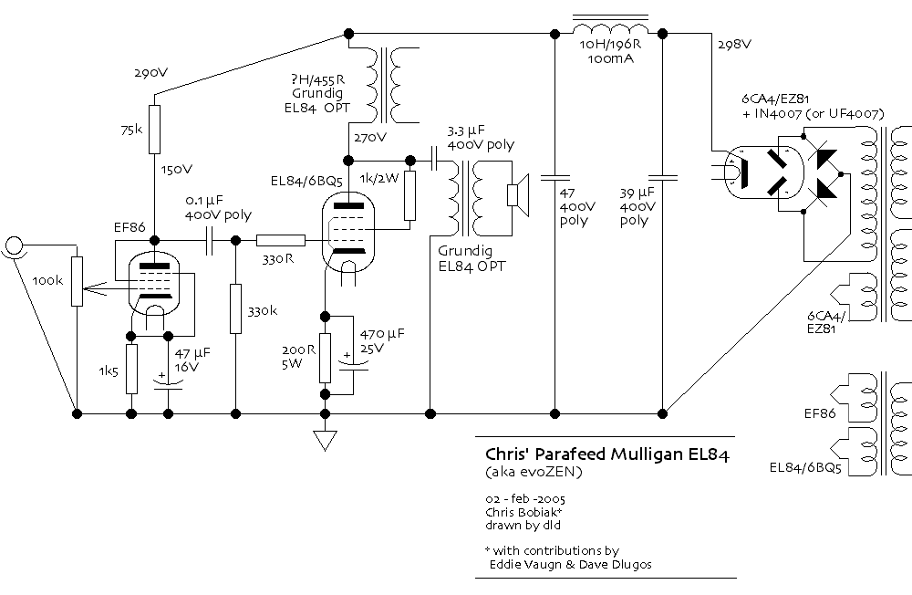

Keep the circuit simple, and add a switch to go from triode to Schade feedbaxck pentode. No guessing. And you might find each mode is better (for you) on some source material, your mood.

add a switch to go from triode to Schade feedback pentode[...]
On the EF86? EL84 seems to be fairly locked into pentode operation from the schematic. I would also probably substitute the EZ81 for a 5U4GB, simply because I have two of those since a few hours ago.

The switch would connect the screen differently and switch off the Scade feedback (plate-to-plate)
EF86 in triode [...] is kinda whimpy and i think it could get better yet.
Ok, gotcha on the switch situation.
What's the reasoning behind using a pentode on the input? I'm only versed enough to know that triodes are typically preferred there due to generally lower noise figures and snappier response.

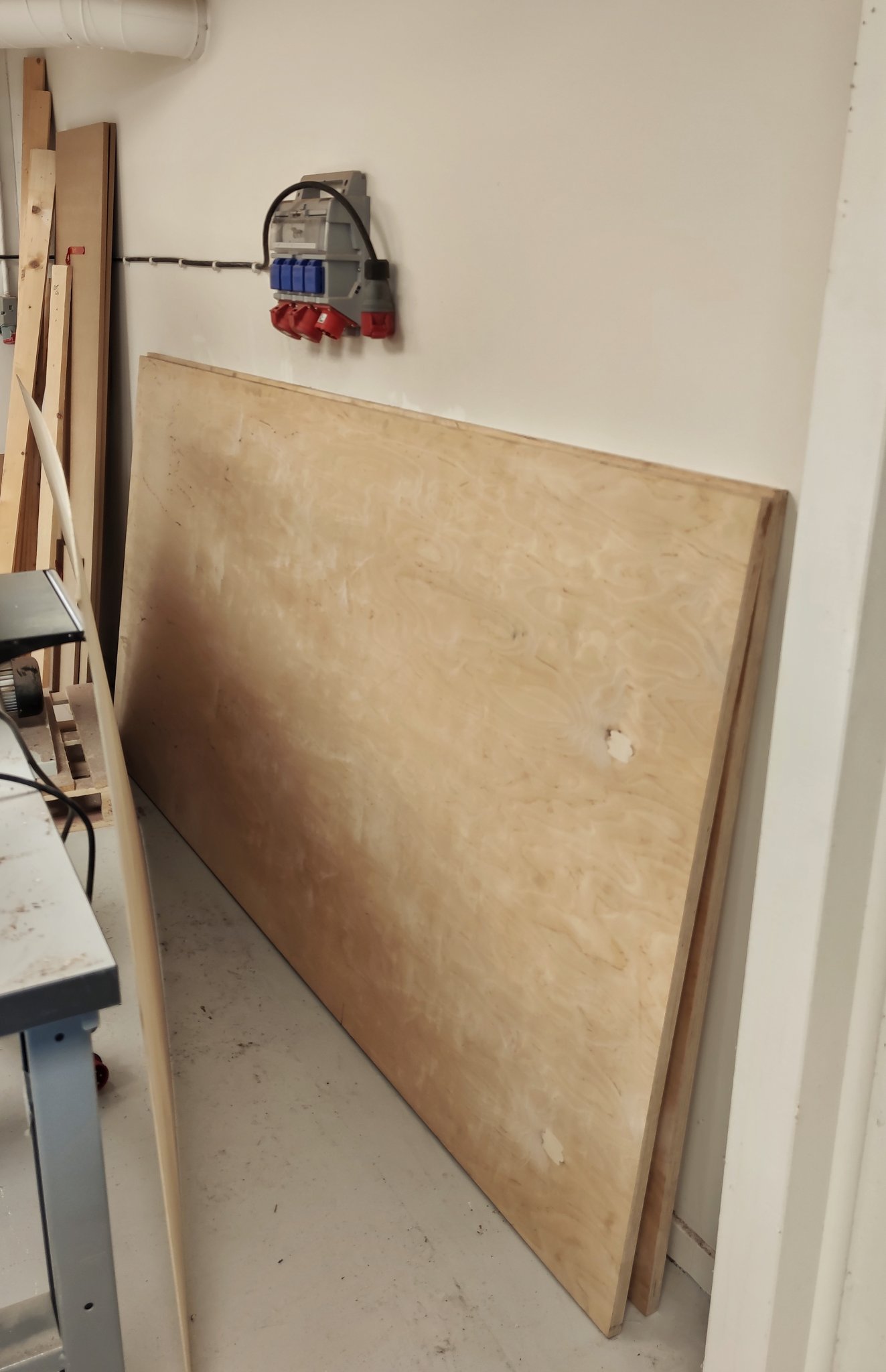

Took delivery of the ply last Thursday, things were HEAVY.
Also entered the dimensions into Opticutter -- stock usage is sitting pretty at 95%😬. No mistakes allowed.
Next step is to properly square the gantries on the laser cutter at work and do some test cuts to confirm dimensional accuracy. Once that's done, I'm going to cut some jigs out of 6mm MDF to ensure that critical angles are accurate.

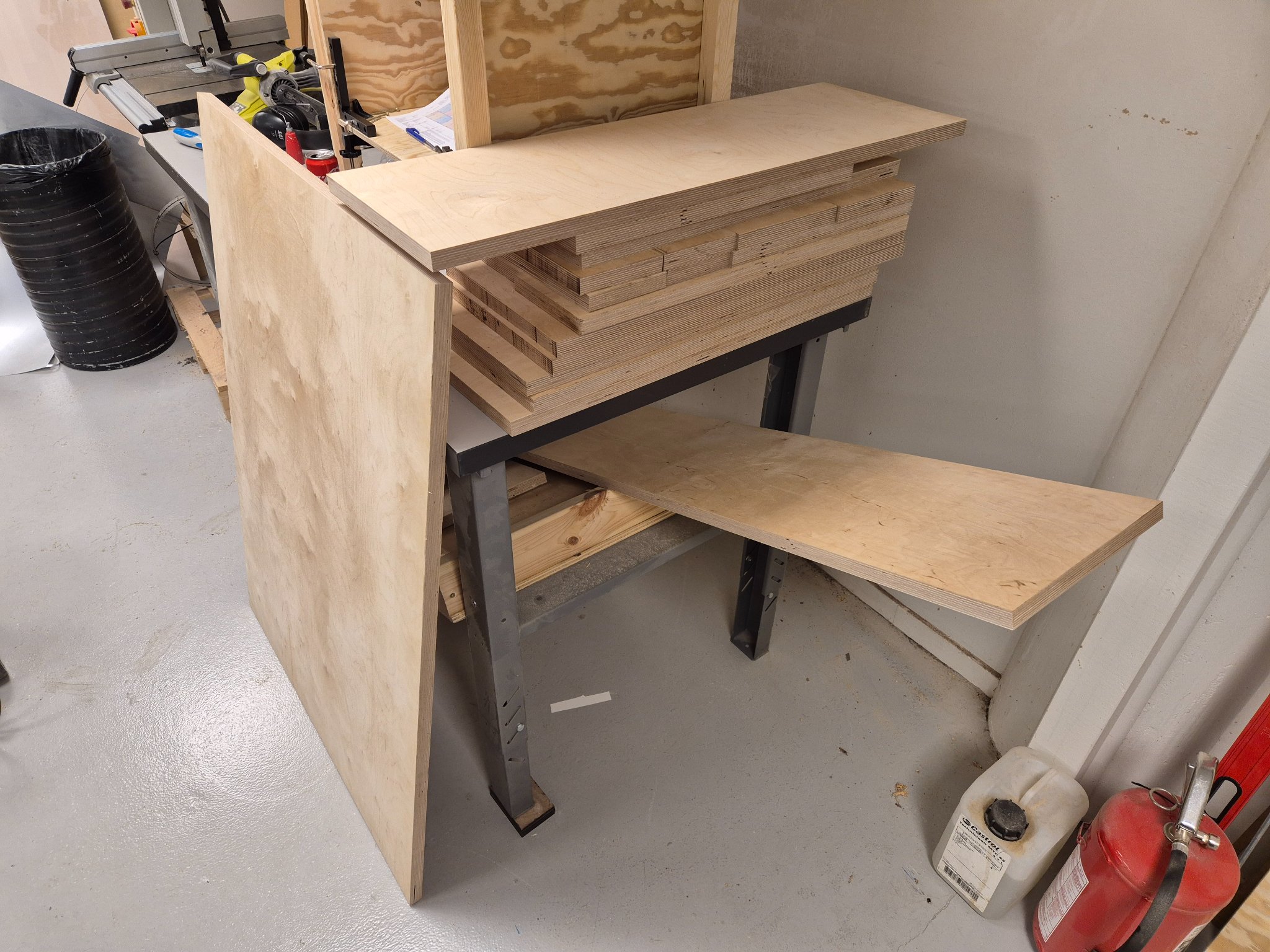

Great progress has been made on the Dallas Horns! Managed to snag one of my dream motorcycles a few months back so this project was put on the back burner, but these past two weeks I've been chipping away on the build after work.
I'd say a solid 80% of the panels are cut out now, and I intend to have the rest cut out before the end of the year. I've also modeled and 3d printed corner braces to ensure consistency when lining up the inner panels.
