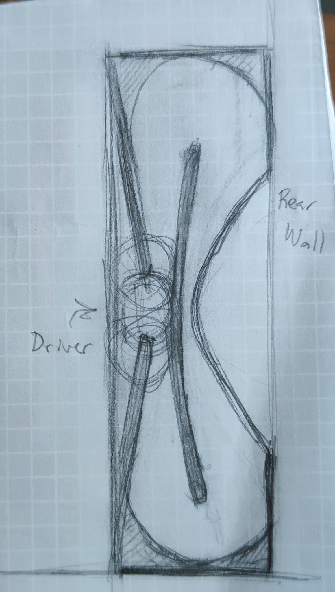

Ok. And the offset driver alignment achieves what, exactly? Does the space "above" the driver simply act as some sort of filter chamber? Is it important that the driver be placed asymmetrically along the horn, ruling out a symmetrical "dual path" horn? For example, the Duelund horn has a bit of internal volume ahead of (or below in this case) the driver.??? This is a tapped horn, AKA 6th order bandpass (BP6).........so technically all others are just basically offset driver alignments.
Reason I'm asking is because I'm wondering whether something like the enclosure pictured below would work.
Not sure how to dimension the rear-venting area though. Assuming a 45 degree "radiation angle" of the volume, it seems to perform decently in Hornresp.
Not at all clear what you are intending… looks sealed as drawn.

Yeah, I realize thatNot at all clear what you are intending… looks sealed as drawn.

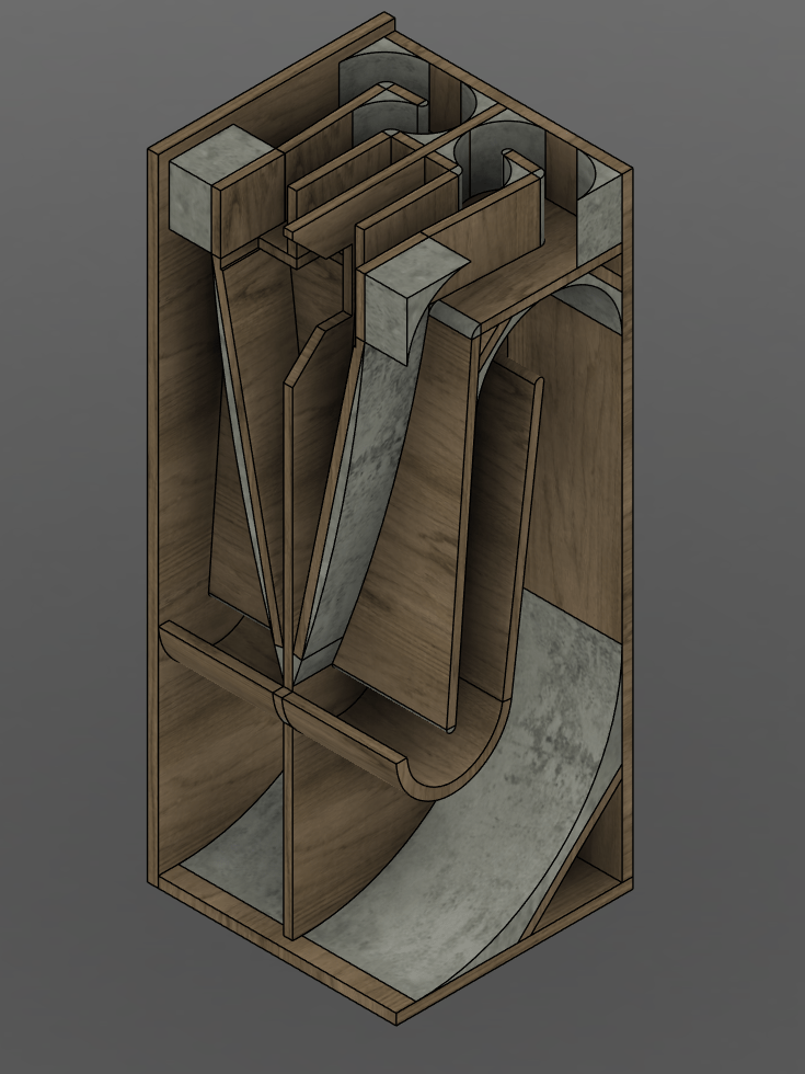

School has started back up now, so things are going to slow down for a bit. Went over the plans with my father during the weekend though, and he's equally curious about the Duelund horn, so modelling that will make up my free time for a while. Mainly aiming to unfold the horn and calculate the volumes to determine suitability for the Betas.

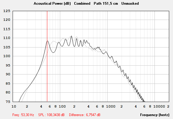

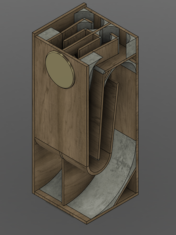

NEVER MIND. Couldn't leave well enough alone, so modeled the "small" Duelund yesterday according to the available plans. Aside from minor deviations it came together fairly accurately (within ~0.5mm).
Simulated it in hornresp and the results are reasonable IMO. Fair bit more "comb"-y but with better bass extension. Grayed out response curve is the modified Dallas horn. Makes the decision a bit harder.
