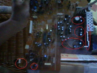

Well...... i'm quite weak on circuit tracing, because i don't know which stuffs i need and don't need CLEARLY in my mind. (such as when the circuit goes to volume control IC, do i need to continue tracing ? etc...) So we also need to preserve the headphones and speaker output connection ?
Would be very good if you can help me in this tracing job, but its far too troublesome to have to do it for me.
But i think you could 'direct' me about how to trace what i need in this project.

Some more thing to ask:
There is 3 connection to external just below the main plug in the power supply page/board.
Which marks as arrows of 1 black 2 white, which labeled as 'B+' line also.
About the plug, it is only 2 for AC '+' & '-', is it necessary to make a ground line for safety/quality purpose ?

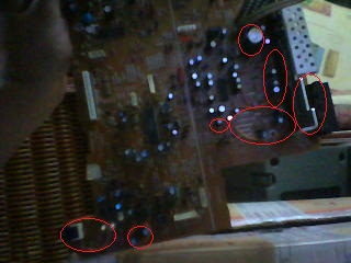

Do you mean Top Right, instead of top-left ? So i just cut out the batteries line (abandon it)?
**I guess is following the way of the manual, because 2nd method need to do alot of rewiring ? But I'm not too sure about the ground/sleeve of input(RCA) should wire to black line of PSU, or amplifier...**
I mean if i use the crimping style(encase a copper plate) instead just putting the wires into the 'clipper', would it disturb or downgrade the audio quality ? (because of different conductor material in the way)
So in conclusion, after isolating the powerboard (disconnect the battery connection and others), and isolating the amplifier along with the headphone & speaker(cut just before C116, C216, Q101, Q201, pin 4 & 8), then how should we connect ? (pin 4 & 8, PSU and others)
I think the pin 4 would connect to the top(black dot) to the PSU, but i have no idea connect pin 8 to what, even i had to put in a resistor(which you told).
And a bold black wire from Amplifier to page 37 through -<2>-, should we cut slightly outside region of Amplifier, then connect it to second dot(White dot) to PSU ? (i think it serves as grounding)
Then no need to connect other things to the PSU at the 3 other wiring ?
And about the output of the speaker volume, since i don't have internal volume control as in our modification, the volume control is from outer source and it will as if the magnitude of volume radio player has been turned to maximum volume in the original condition ? (example : the input of radio is about 5dB, then amplified to 10dB through maximum volume of original condition. Then after we modification, if the input is 5dB, it is set to amplify to 10dB)
Do you mean we cut just before C116, C216, Q101, Q201, pin 8 & 4 ? then de-solder the Q101 and Q201 transistor and leave the other wiring as it is ? So thats the way to isolate the amplifier ?also ,you should pull out by desoldering them , Q 101-201 transistors (which mute the input): So the (+) of C116-216 are our inputs ,cut the traces before them ,and solder a wire on that buttonhole ,carefully . So we may end in having the left and the right wires . And the ground ?? Wherever , near the inputs .
About the RCA, i need 2 RCA connection for left and right, isn't it ? I mean i connect the each RCA's tip/inner(signal) to pin 12 to both amplifier(like on the manual), or pin 11 & 12 individually ? and RCA's sleeve(ground) to pin 13 to both amplifier, or pin 10 & 13 individually ? (these connection I meant is all before those capacitor/resistor, not directly to the pin)should I explain how to connect an RCA ???? Or how to twist the stranded wires of the speaker cables to insert them into the clips ?
There is also a capacitor just outside of the powerboard/PSU, which is C348(4700 16V), do we need to preserve it ?

Don't matter ....I was dreaming of my 12" in 120 liter boxes I'm just finishing😎 I dream they were just attached without any filter and they sounded fabulous 😱 Today I should glue the front baffle ...and try 'em
OK : pin 14 and 15 are Power Ground (they are tied together )and pin 7 is also ground...for line level signals you should consider this pin as Gnd .
I guess that on the PCB ,the C348 (4700 uF -16 VL )is located close to pin 4 (+ Vcc ,same as +B...)and pins 14-15 because there is where is needed .
Just bring two wires from the output of the diode bridge to the buttonholes of that capacitor ,respecting the polarity . Now the power is supplied .
For connecting the line level signal ,you can also desolder one leg (+)of C116-216 and lift it ,and solder the wire there .Usually shielded cable is used ,
but it is not peremptory. The shield is the ground ( O V ) of course.
Two wires (black -negative ; red -positive ...or whatever) bring power to the amp . 4 wires exit from it (note :the amp works in BTL so there is no Gnd reference at the Black connector for Spkr output ) . Three wires ( or 2+2 )which are Right & Left channels plus Ground brings the input signal .
I expect some sound exiting from this device after these mods .
Let me see them ! X.x I think it will be excellent !
I don't know about shielded cable, could you show me some picture or links ?
So we are really ignoring(not connect to anything) the other 3 wiring of PSU to mainboard, and the backup board ?
So we should preserve the C348, is it ? As it is in original(C348) ? Then connect the as the manual, is it ? (excluding parts we don't need)I guess that on the PCB ,the C348 (4700 uF -16 VL )is located close to pin 4 (+ Vcc ,same as +B...)and pins 14-15 because there is where is needed .
So you mean that the external input signal of L&R should be soldered to the leg of those 2 capacitor respectively ?For connecting the line level signal ,you can also desolder one leg (+)of C116-216 and lift it ,and solder the wire there .Usually shielded cable is used ,

I have manage to trace out the location and encircle it, just to have opinion on you guys :
- the components are a bit too far in a board, therefore i want to make it closer (to a smaller size, but same board).
The main problem is that the connection need to connect the headphone to the front, therefore distant those 2 section.
My idea is to remove headphone side section (which consist of L101/201/301, C134/234, R119/219)
Is it possible to completely bypass that section ? (component I concern is the capacitor & Resistor)
Thanks in advance.
Thanks in advance.
