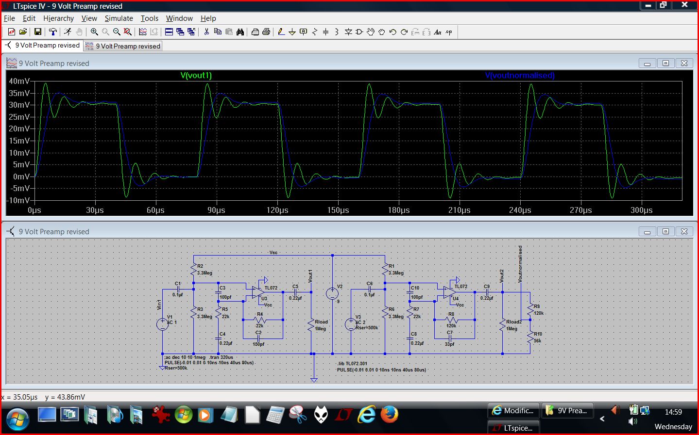

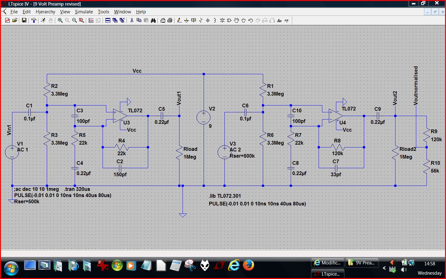

The TL072 is actually fairly similar to the model I have used. Both are fast 'audio grade' JFET devices. The TL062 is a low power version of the TL072 and has a reduced high frequncy performance (although still quite respectable in real terms).
Post #146 here shows how to use a '301 file' although like most things in LT, there are differnt ways of doing things.
http://www.diyaudio.com/forums/soft...ltspice-iv-beginner-advanced.html#post4067126
See if the attached simulation runs OK.
