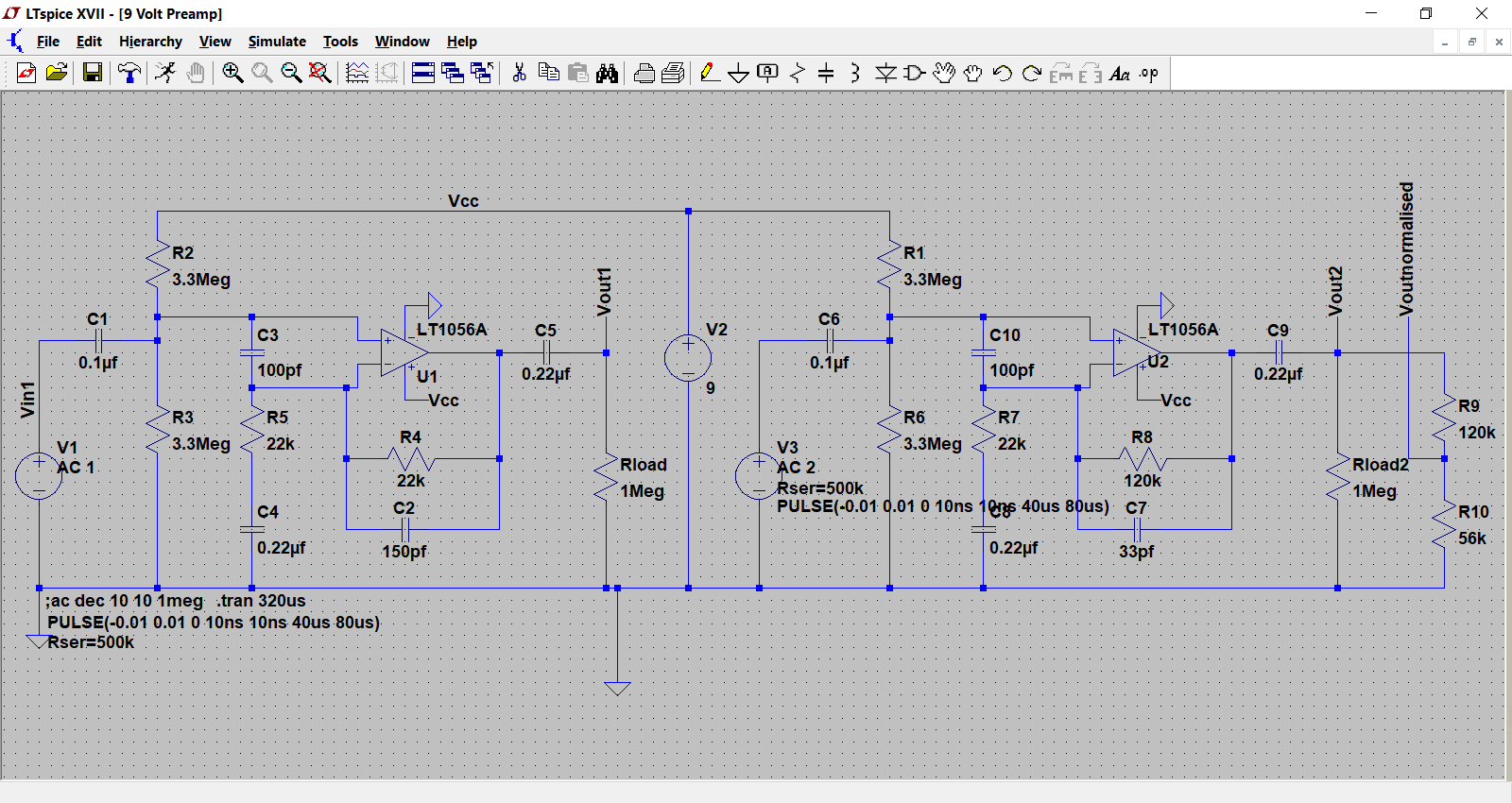

So 100pf. Normally such a cap would make little to no difference over the audio range, but here and given the possibly high value of source impedance feeding the preamp it does have an effect on the midband gain. Not a lot but noticeable.
Try it and see. If you right click the voltage source feeding the input then you will see you can add series resistance. I tried 500k.
C2 provides additional feedback at HF. As the frequency rises, the caps reactance or Xc (its 'resistance' to AC) falls. That extra impedance appears in parallel to the feedback resistor and so has the effect of reducing gain. For example, 150pf at 100kHz has a reactance of 10610 ohms. 10610 ohms in parallel with 22000 is 7158 ohms. So at 100kHz the feedback network is 'similar' to the equivalent of a 7158 ohm and the gain is reduced accordingly.
Slight correction here---a capacitor is a reactance, not a resistance, so its impedance is 90 degrees from the resistance---you can't calculate it like resistors in parallel. A 22KΩ resistor in parallel with a 150 pF capacitor will provide an impedance of 9.56KΩ AT 100 K Hz; as opposed to 21.5KΩ AT 10 K Hz. This, with the 22KΩ resistor to ground, will provide a gain of ~2 in the non-inverting circuit at 10 KHz, but only 1.43 at 100 KHz. This will roll off the 100 K Hz signal about -3 db compared to the audio-range frequencies.

First I did some hearing tests comparing the loudness of my two Yamaha FG guitars (one newer and sounding great and the old one where I replaced the pickup) and tried to match the loudness by adjusting value of R4. At about 120k both guitars had a similar output volume. My former idea that I needed an amplification of 1.5 for the whole preamp came out to be a wrong assumption then.
Next step was entering that value into the LTspice simulation. As Mooly pointed out earlier, the C2 capacitor along with the new value of R4 changed the frequency response of the circuit quite a bit. So I run some simulations with other values for C2 and came to the result that a value of about 30pF resulted in a frequency response similar to the R4 22k C2 150pF combination.
@Mooly: would you be so kind to confirm those values in your simulation? I'm quite new in using LTspice so I'm not 100% sure whether I did everything right.
If Mooly can confirm my findings for the ideal value of C2 in combination with a 120k R4 then all that remains to be done is finding a capacitor of that value and soldering it in.

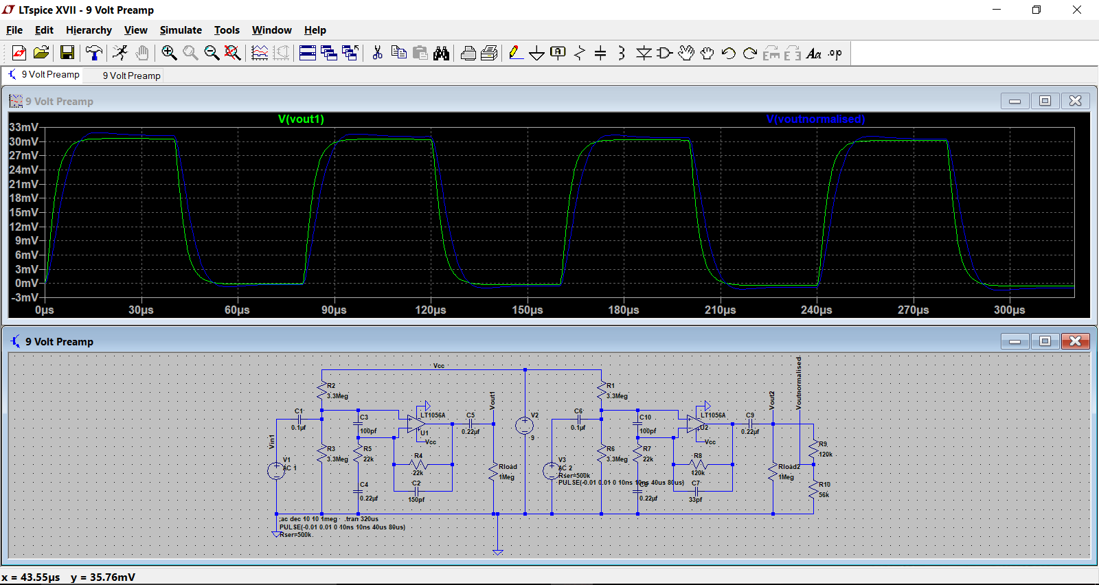

It looks a good fit. Also bear in mind that the TL062 is not as good a performer at HF as the model used here and so that will have an effect as well.
One thing thing we can do in LT is copy a circuit and have two instances running at the same time. Here we have the original circuit and the modified one. The output of the modified also has an attenuated output to match the level back to the original and so allow easy comparison.
I've changed the input to a 12.5 kHz square wave which is useful to check out the transient response and any ringing.
Hi Mooly,
thanks again for your advice. So 33pF will be the value to go for, since the diagrams are looking good with it.
So I guess there is no real TL062 plugin for LT?

The copy feature is really useful. Just click copy and drag and move the area you want duplicating. LT reallocates new reference numbers, all you need do is delete any duplicate .op commands and so on and relabel any nodes such as Vout etc so that there is only one of everything.
There probably is a more suitable model in there somewhere but I'm not familiar with a lot of the LT devices. You could search the Linear Tech site and try and find something more modest using the parametric search perhaps.
You might a suitable cap in some old scrap equipment or old circuit boards. Its always worth a look if you have any.
