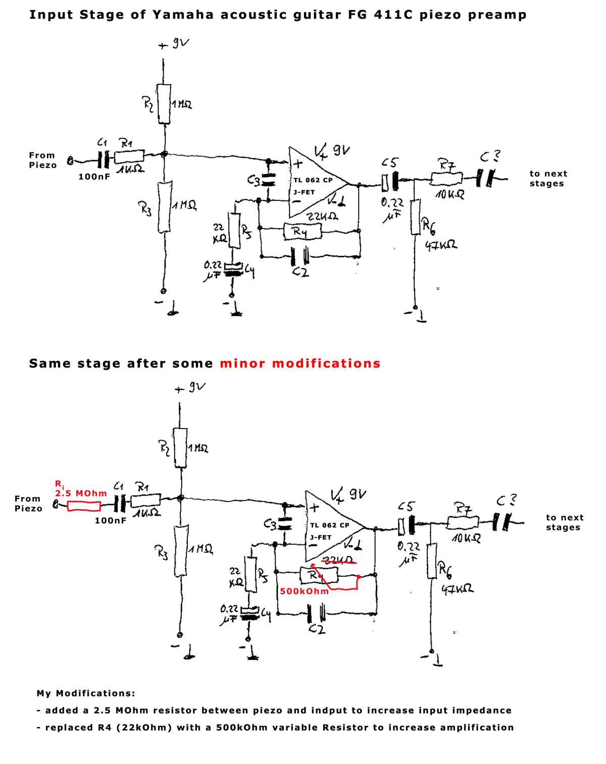

Hello electonic experts,
I recently exchanged the original piezo of my old Yamaha FG 411C with a standard fishman acoustic matrix piezo. Since the fishman has way lower output I'm trying now to modify the built in preamp of my guitar to go along with the fishman (see partial circuit diagram below).
There are two main questions at this time:
1. when I'm raising the value of R4, the amplification doesn't react like I thought it should. Amplification should be something like R4/R5, but when I'm setting R4 to 100kOhm I don't get much more loudness than when I'm setting it to 50kOhm. Raising amplification by raising R4 doesn't seem to be linear at all. Can you tell me why?
2. I added the Ri resistor to the input to raise input impedance. Modern piezos should be connected to preamps with 2-3 MOhm input impedance, so I thought this might be the easiest way to get this done. Other aproach would have been to raise R2 and R3 to about 3MOhm (or more) each. Would this have been the better approach? Why?
Hope someone out there can give me some hints.
Yours
Rob
The value of C2 could be a determining factor in the gain calculations. Depends how large it is.
Ri probably isn't a great idea as it also forms an attenuator with the combined parallel resistance of R2 and R3 (500k).
A J-FET input opamp like the TLO62 will allow you to raise R2 and R3 if needed. 10meg is no problem.

C2 is a brown ceramic disc with the inscription "151K". I can't figure out the value.
Further measuring of input vs output signal voltage has shown that Ri actually wasn't a good idea, seems to take away much of the signal. That's why I had the idea of replacing R2 and R3 with way bigger values to get a higher input impedance. I figure that I have to count the impedance of the 9V block battery into the calculation, so if I'm replacing R2 and R3 with 3MOhm values, what overall input impedance will I get?
Yours
Rob
151 is 150pf, it is one, five and one zero, so 150.
The 9 volt battery will have a low impedance (and will probably have a decoupling cap across it as well) and so that means the +9 volt rail and the 0v side are effectively the same point as far as audio frequencies go.
Replacing R2 and R3 with 3meg resistors would give an overall input impedance of 1.5meg. Because the two values are always equal we can just divide one of them by two to get the result.

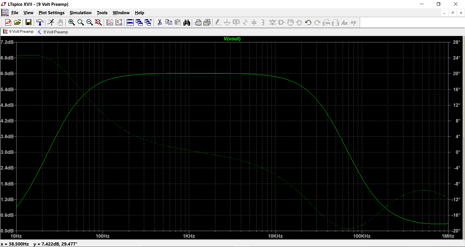

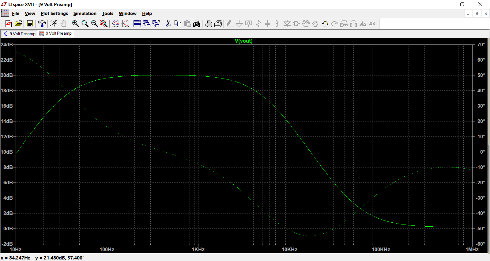

The 150 pf will have a big effect but only at frequencies over about 10kHz from which point the gain will roll off. That's on the version with a 22k feedback resistor.
If you alter the feedback resistor then the cap interaction will change, make the feedback 200k and the roll off starts much earlier at around 1kHz.
I'll have to leave it for tonight but this shows you the response with the 22k + 150pf and then with 200k +150pf.
Note the gain scale at the left.

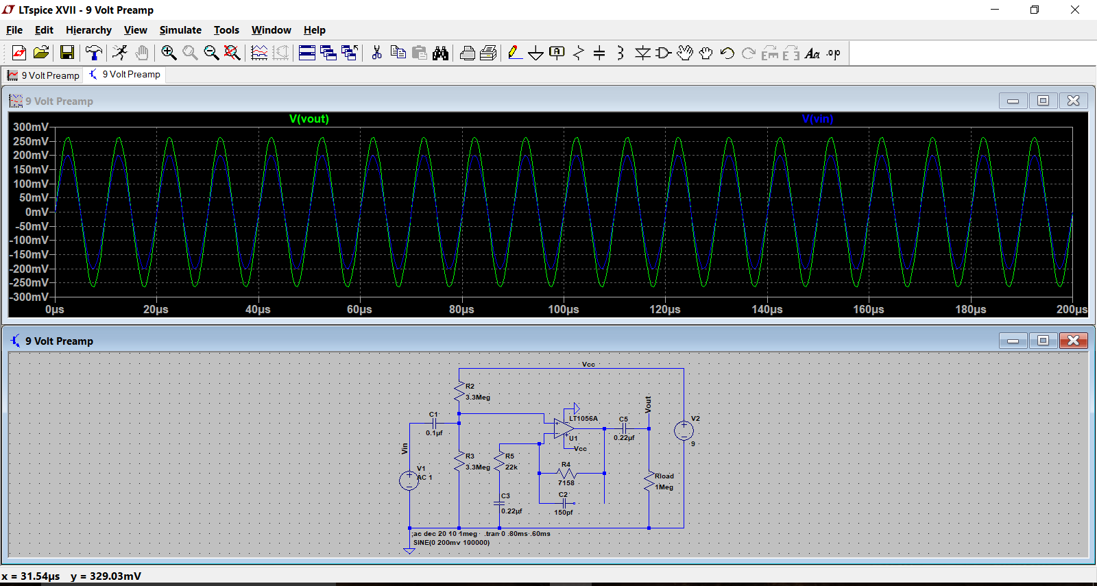

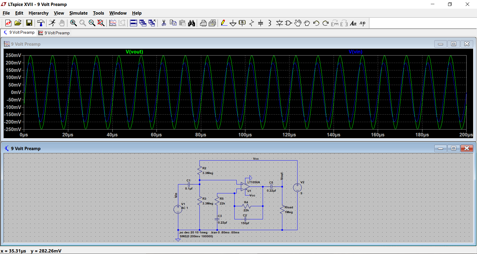

If the gain isn't increasing by altering R4 then something is wrong in the method or implementation.
Its a classic text book circuit that will absolutely follow the theory of an opamp gain stage.
I can't quite follow your results either tbh 🙂

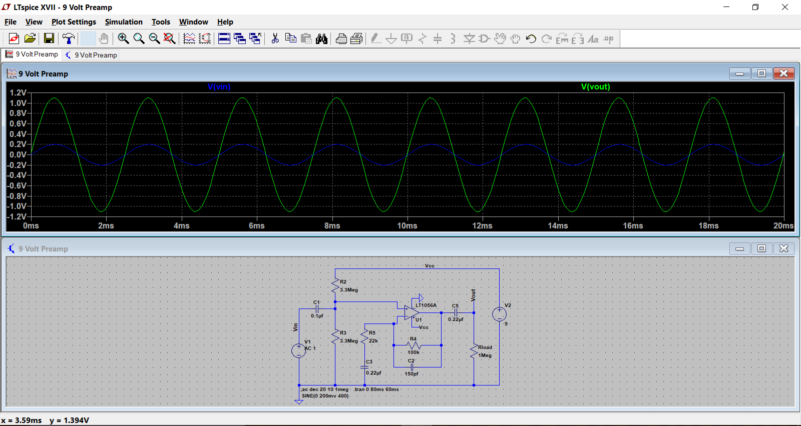

Here is the circuit in standard form and with 200mv peak applied followed by the same set up but now with a 100k feedback resistor.
The gain is calculated as G= (R4/R5) + 1
So for the 22k version we get (22000/22000) + 1 which equals 1. That agrees with the simulation. 0.2 in and 0.4 out.
And for the 100k we get (100000/22000) + 1 which equals 5.54. That to agrees. 0.2 volts in and we see 1.1 volts coming out.
Are you using a scope or an accurate DVM to measure the AC voltages ? A DVM may not be good at the very low levels involved and could give inaccurate results.

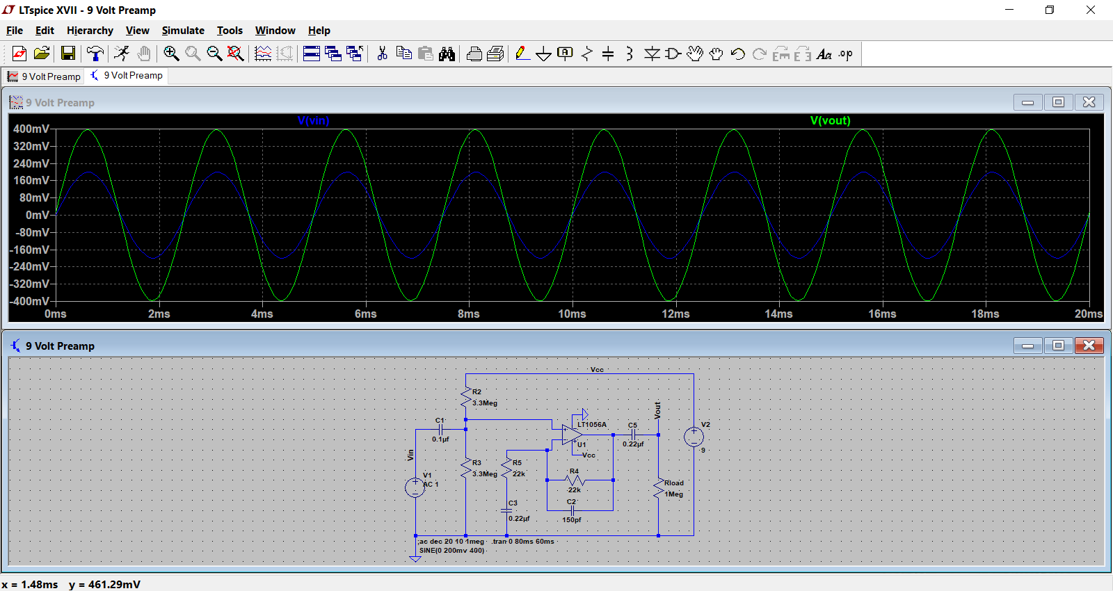

Here is the .asc file that should run straight off in LT IV or LTXVII
C2 provides additional feedback at HF. As the frequency rises, the caps reactance or Xc (its 'resistance' to AC) falls. That extra impedance appears in parallel to the feedback resistor and so has the effect of reducing gain.
For example, 150pf at 100kHz has a reactance of 10610 ohms. 10610 ohms in parallel with 22000 is 7158 ohms. So at 100kHz the feedback network is 'similar' to the equivalent of a 7158 ohm and the gain is reduced accordingly. Its not quite the same because the cap also introduces phase shift that complicates the calculations but you get the idea. Note the phase shift between the two diagrams below.
