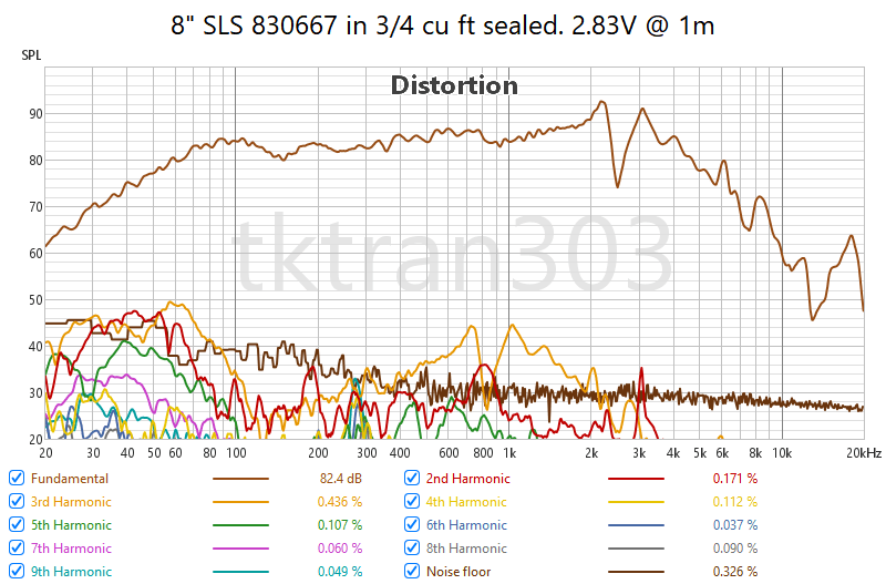

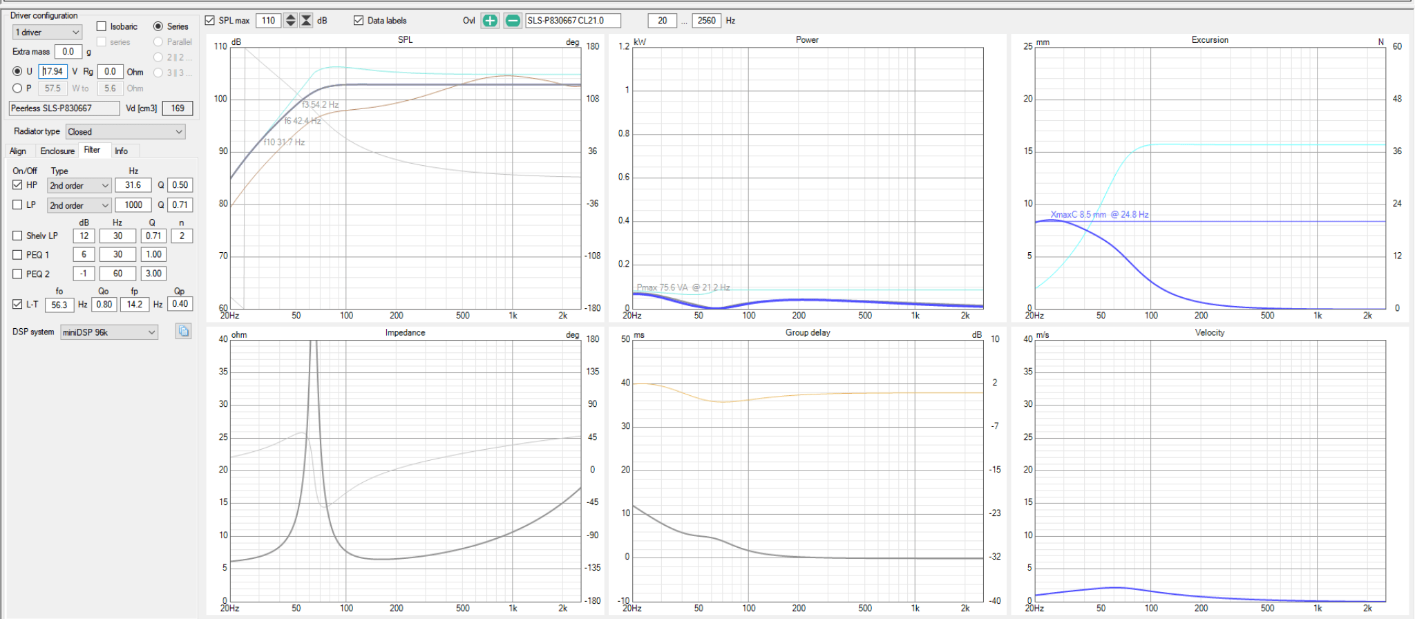

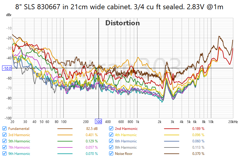

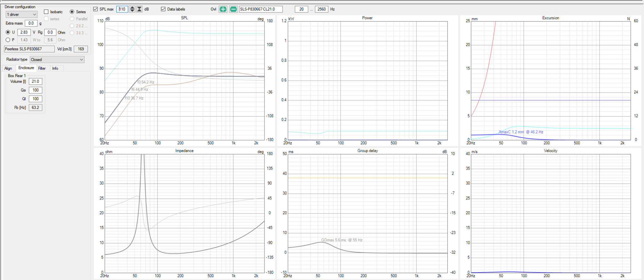

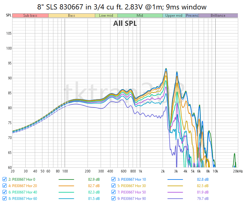

I had a similar decision to make- a low cost driver to prototype a coaxial speaker. If it worked out I would go “all in”
I needed something that worked in 3/4 cu ft, suitable for sealed, healthy amounts of excursion.
https://www.parts-express.com/Peerless-830667-8-Paper-Cone-SLS-Subwoofer-264-1102?quantity=1
