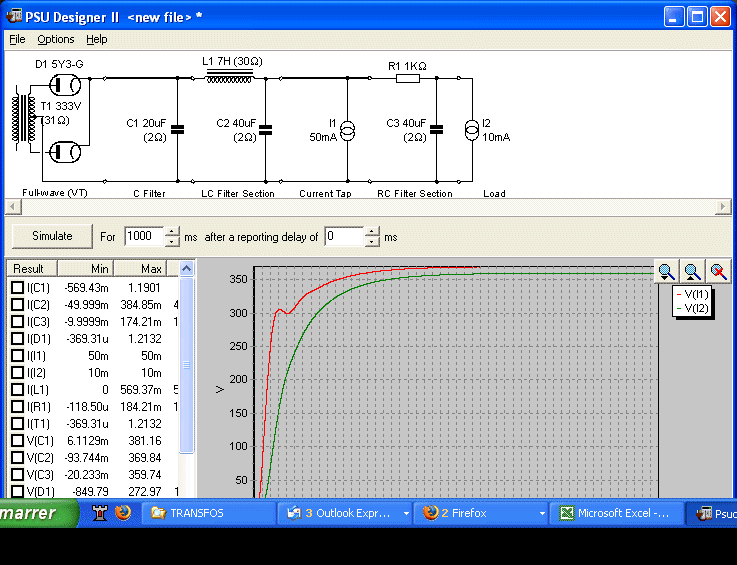

Plug in all the states as described in the thread :
Then - left click and drag a LOOOOOOONG!!! rectangular box around the END of the long sweeping curve (when the voltage has stabilized).
Repeatedly do this until you can see the ripple, then just select a smaller portion to to get the 'nice' wave 😀

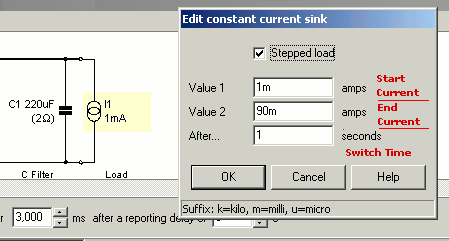

Thanks for the help, folks. I still can't duplicate the results shown above. I've inputted all the data shown including the stepped load. Simulation quits with an error message:
"A current sink has pulled the voltage below zero for more than 5 mains cycles, at a time 1.907917S"
