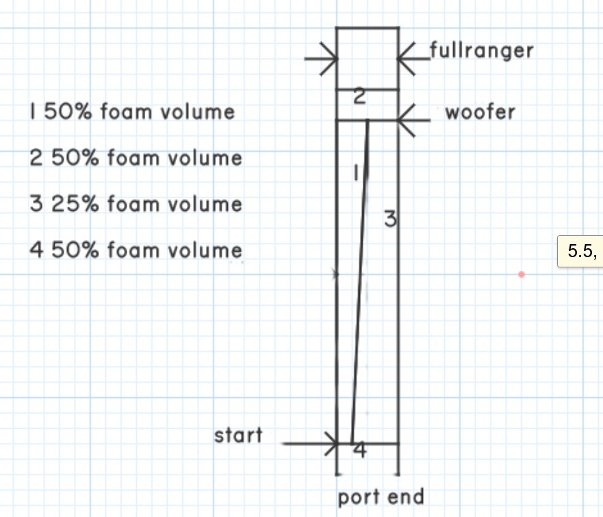

Here you go made it super easy to build should be okay 400 or less testing would
Be needed but I see full range your using can do 300 easily. Each cube =1 inch 1-4 are segments the lines are just to show where they the segments start and stop so just just a 1x4 inch board and the longer board which is around 21 inchs x 4 is all that's needed the foam is more important then the dimensions of the box bc it screws with the tuning which is at 45hz like you wanted.

Wow, that is very detailed. Thank you very much! I think I mostly understand, but I have a few questionsHere you go made it super easy to build should be okay 400 or less testing would
What internal width does this cabinet assume?
There is a horizontal line in the diagram along the midpoint of where the woofer should go. That does not correspond to a board inside the cabinet, correct? Just a line that indicates the position the woofer should be at?
At the bottom of the diagram, there is a horizontal line marked 4, then two lines going down another 2 inches before cutting off, below which you write "port end". Is the base of the cabinet at the horizontal line marked 4? If not, forgive me, I don't entirely understand. I am gathering that you designed the enclosure with a tapered slot port?

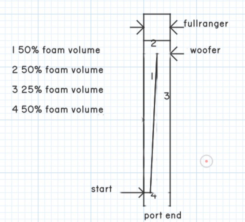

here this should look more like what your looking for the box assumes a 4 inch width. so a 4x4 the port end is liereally just a 4''x4'' hole. also if your not going listen above 85db you can run it without a highpass .
Okay awesome! You've made exactly what I'm looking for! Okay, so. Just so that I know 100% we're on the same page. At the base of the enclosure, it will be a 4"x4" hole (widthxdepth) that is 2" high, and which has an opening into the enclosure that is 4"x3" (widthxdepth) that gradually tapers into a 2"x2" section by the time it reaches the woofer?here this should look more like what your looking for the box assumes a 4 inch width. so a 4x4 the port end is liereally just a 4''x4'' hole. also if your not going listen above 85db you can run it without a highpass .
