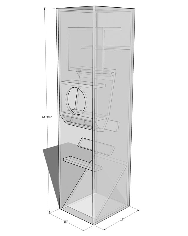

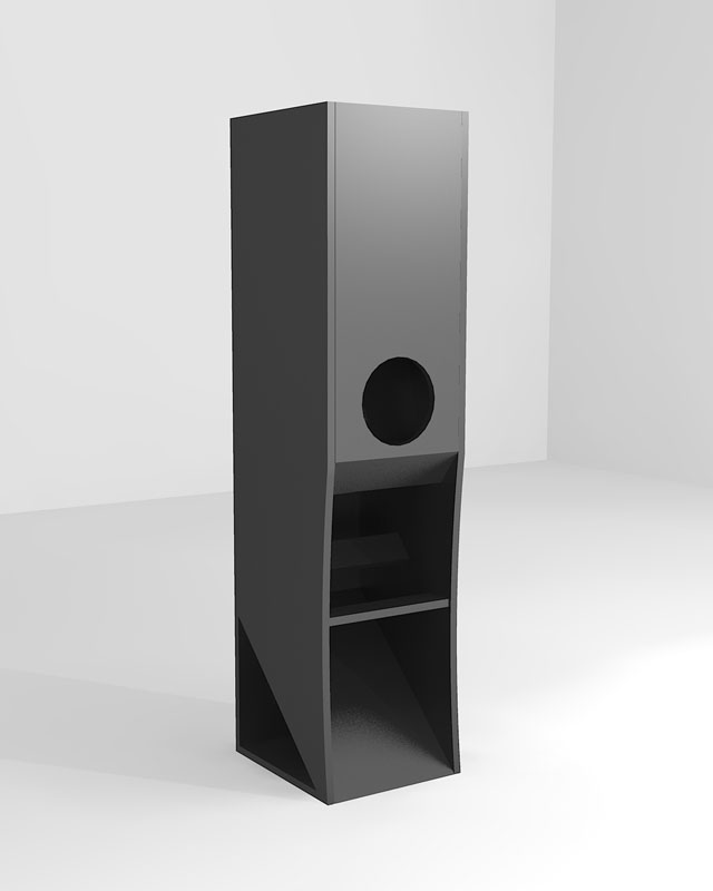

Well, here are the first iteration of the S.P.Q.R. Model III plans. No cut sheet yet but this should be enough for those that have shown interest in getting started on the enclosure now.

I almost forgot. If you look at the plans, you will see that I designed the back chamber to be built bigger if desired and therefore tuned. The back chamber is tuned around 150 Hz now but can be adjusted up to 160 and by my estimates down to 120 Hz. Just a thought.

That looks good... it would be easier to build if it was 60" high (to fit a 60x60" sheet of BB.

That is an excellent point. Let me squeak my numbers. I am sure it will be possible without affecting the horn whatsoever. Thanks Dave!

Ok, I have updated the plan. The enclosure is now 60 inches high. This will be ideal for building with Baltic Birch. The only alteration this made was driver height. The driver height went from 36 inches to 34 1/4" from ground to center of driver. This should be better than 36 as most builders will be putting spikes on the cabinet which will raise driver axis to around 36 inches anyway.
