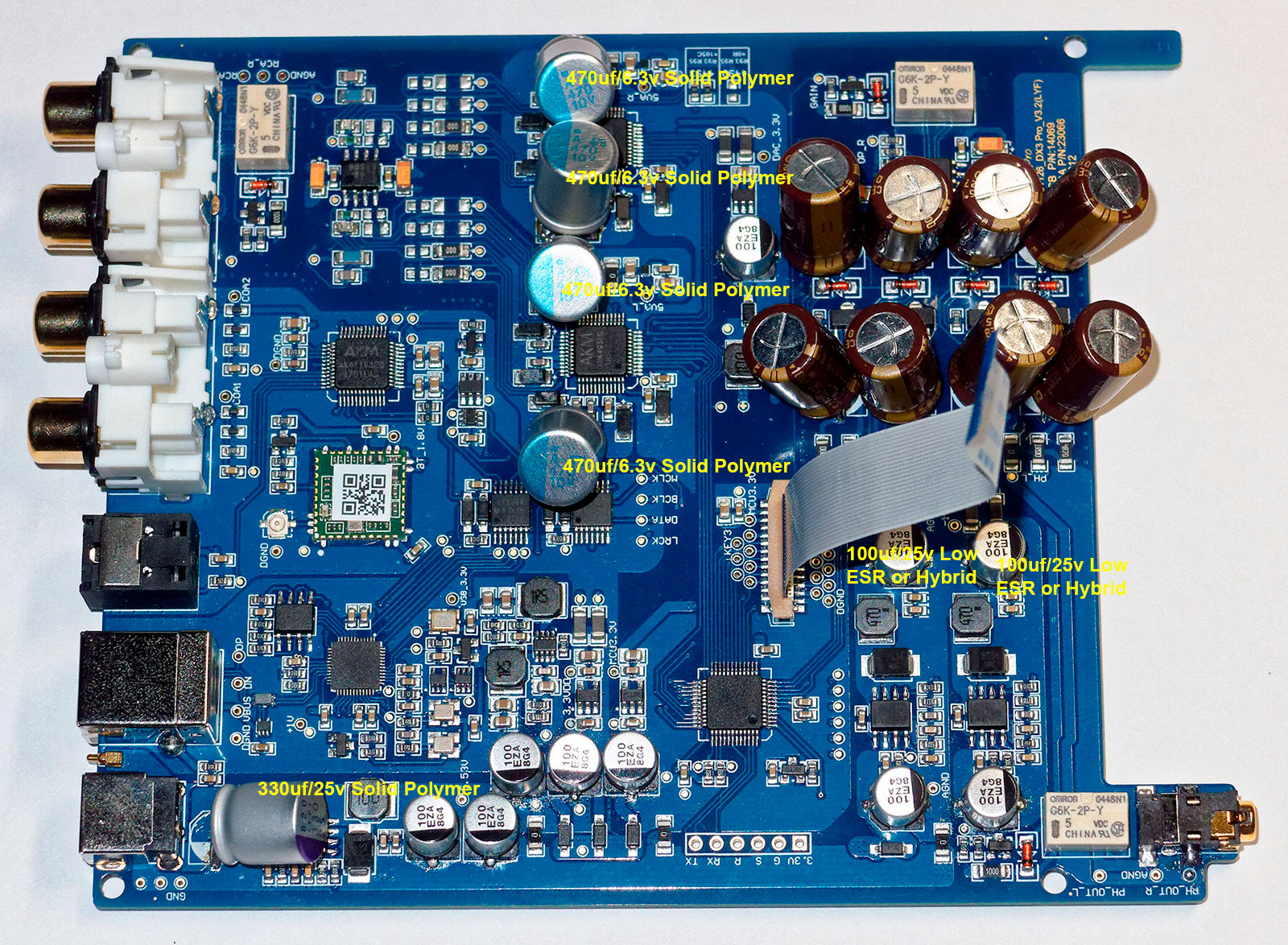

What many of us do is to google the numbers printed on all those parts and see what they are and then find out what they do. Then you can have a better idea of the architecture, the power supply will be identified easier that way, as well as everything else.
I will often take a picture of the board, and make notes or point out certain things for reference.

Finneybear excellent post #113 is already very clear on what to replace at the dac's output. All the parts that needs replace are labelled. You can skip the opamp replacement as it is a bit more difficult to desolder and opa1612 is already fairly good. The most impact will likely be the removal of the tantalum coupling cap at ak4493 dac output and replace with a zero ohm resistor (or straight wire) plus the surrounding filter parts.
Actually you can easily remove OPA1612 with low temp solder such as this one:
Chip Quik - ChipQuik Alloy (10)
Still more components to replace. Please see the marks in the attached pic.

Here is the shared shopping cart at mouser.com
Mouser Electronics
Attached is the BOM in Excel/ZIP format. Part locations are shown in the comment column.
Standard disclaimer - I am not responsible for any damage done to the machine as well as any hazard brought up by the mod. There is no guarantee the change on sound quality will meet your expectation either. In other words, you are doing the mod at your own risk! 😀
The stock power supply will work fine. Just remember to connect the power supply to the machine first before you plug it to the power outlet. Sure, a good linear power supply with at least 1.5A current will definitely help.
Some mod tips:
. OP can be easily removed by low temp alloy solder as I mentioned above.
. Small caps and resistors can be removed by hot tweezer with rework station. If not available, the low temp alloy works, too.
. SMD e-capacitors can be easily removed by the twist and turn trick with a needle plier. You can search youtube.com for a demo.
. After the SMD parts are removed, clean up the solder pads with solder wick.
. You will need a good temp controlled solder station with small tip for the soldering work.
. To solder the small SMD parts, the reflow method can be tricky to do. I'd suggest you soldering the components directly with solder paste.
. I'd suggest you get solder paste with high silver content (3.0 Ag). Plenty to choose on eBay and mouser.com. I recommend the Chip Quik TS391SNL solder paste in syringe tube. It is thermally stable so it can last for a long time. One 15 gram tube is enough for doing many projects to come.
. Again, check out youtube on how to apply solder paste. The trick is dont apply too much solder paste. One tiny droplet is more than enough.
. Long sharp tip tweezer is required to do precision placement of tiny SMD parts. Be sure to practice this on an old graphics card or something similar first.
. SMD e-caps can be soldered with the heat and slide trick. Check youtube for details. Use lead base solder for its low melting point. Non-leaded based solder is very hard to work with here.

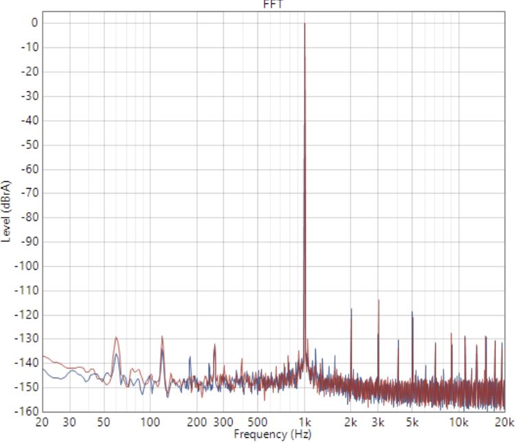

Your mentioning of Figure 7 only confirms my statement that you have no idea about what I was talking about. Please see the attached 1KHz FFT chart. This is the FFT I was looking at. You also need to look at charts such as 100Hz, 400Hz, etc.
As for Bruce's article. He may be a class D master but he did not know everything inside an OP. What he talked about are just very basic and ideal stuff. For instance, the key is not the difference between fast or slow amps. It is the speed of an amp may change among different frequencies.
People all know what he's trying to say yet there are a lot of things much deeper than those. That's where people start to argue about global NFB vs local NFB, and amp speed, etc. Not this simple.. consider they are all seasoned circuit designers.
How do you think a THD vs frequency plot is obtained...
I do not think you understand what you read, sorry.

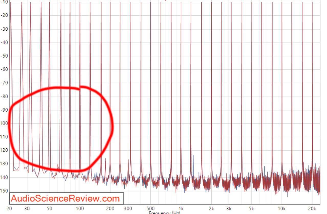

Multi-tone is also very useful to give you a quick glance on the performance of an amp.
Borrow this chart from the ASR board. It's very hard to get sharp lines in the circled region.
Yep, different OPs look differently.
