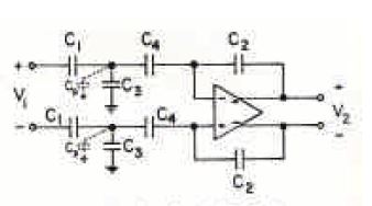

4493 is slightly different here. It has SCF output which is basically an OP paralleled with a capacitor. The job of the OP is to keep the capacitor at steady voltage. Ideally, you want this OP to devote all current to the capacitor with no leakage to the next output stage,

This is concept-wise, what 4493's output stage looks like.
Yep, looks pretty standard to me. So its not different really - the output comes from an opamp and that opamp doesn't have too great PSRR. Best load it as lightly as possible with the following stage, which is normally a 4 resistor differential-SE stage built around an opamp. The higher the resistor values, the lower the current drawn from the opamp in the DAC.
