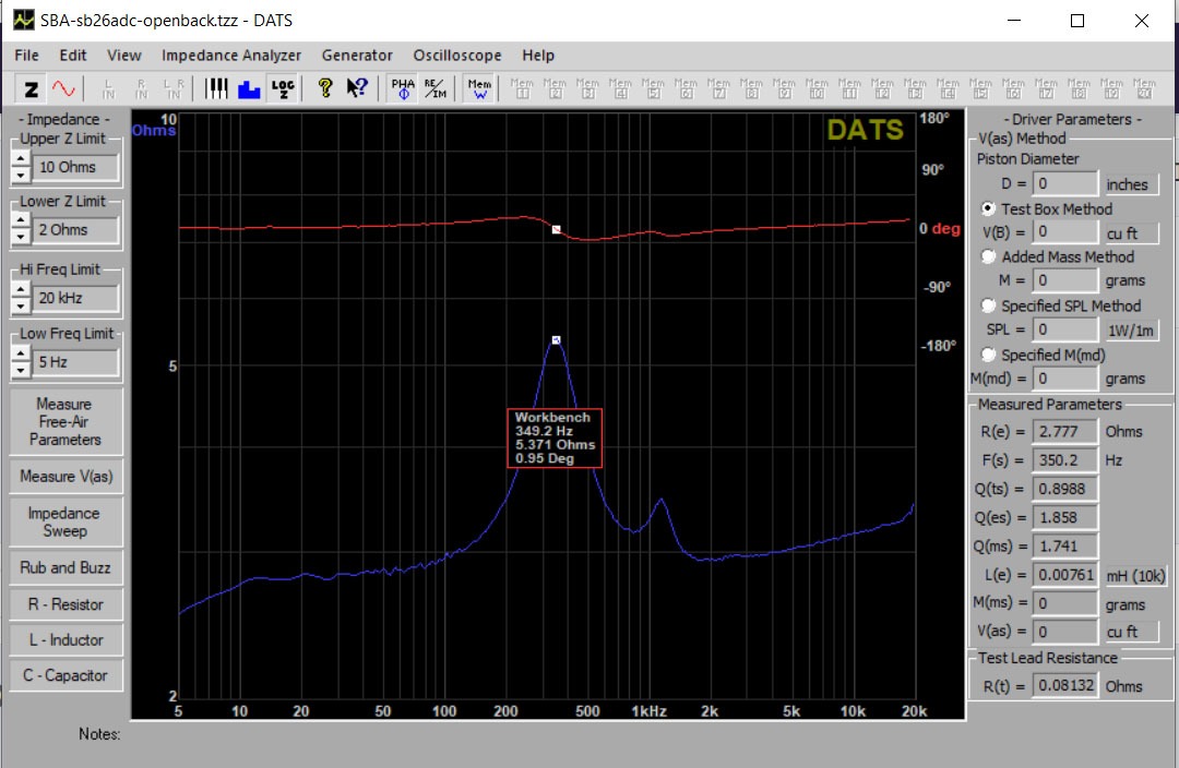

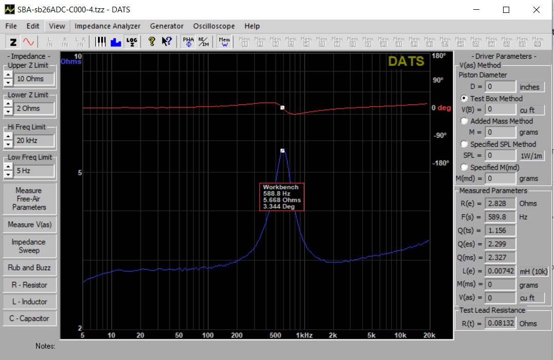

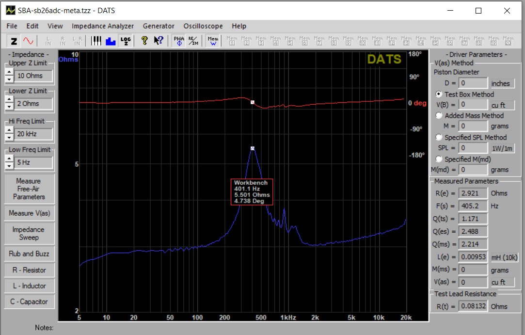

So I did exactly as you suggested & retested with foam + meta-absorber. Virtually no change in DATS result.
Tried changing the foam to a small ball of wool. Again, virtually no change.
Tried without any back at all -- wide open without foam. This dropped Fs to 350Hz. Foam changed impedance at Fs from 6.56 to 5.37 ohms.
All the post-mod results showed the same small peak at 1.2 kHz about 0.5 Ohms above the stick curve.
Possible reasons for the additional peak:
1. Some subtle damage/change to the dome, VC, former and/or slot?
2. This wrinkle is native to the moving assembly & is compensated by the stock back/wool?
Finally, I took the part that I cut away from the stock back, lined it back up as best as I could, and taped it up back to some semblance of normal: Amazingly, the 1.2 kHz disappeared, and the DATS result ended up being nearly identical to before the mod.
This suggests I should try to replicate the foam lining from the stock back cavity to eliminate that 1.2 kHz peak.
@Patrick Bateman -- Did you test your meta-puck modded SB26? Did you notice this phenomena?

Interesting. That it has the peak even open back should help point to the possible cause.
This suggests I should try to replicate the FELT lining from the stock back cavity to eliminate that 1.2 kHz peak.

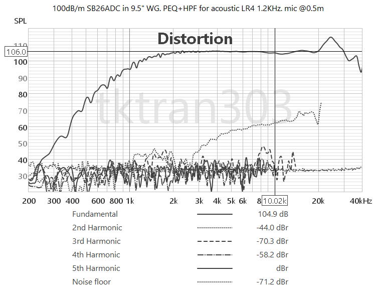

Maybe I missed it but did anyone try to see how low the SB26ADC can be crossed stock before all the hacking and waveguidery?
If you check the test data from hificompass, distortion starts rising below 2khz tho FR is flat to <1khz. With passive I'd say 2khz is the practical limit, probably best with 2nd order. With active, 4th order might be ok pushed to 1.2khz. depends how clean you want it to sound.

Have meta material chamber changed THD on lower than 2 kHz range?
Yes. I have not measured yet but @Patrick Bateman has. Will add link to his relevant posts about this in a couple minutes.
Here are those posts:
https://www.diyaudio.com/community/threads/unity-horn-with-metamaterial-tweeter.380104/#post-6949987
https://www.diyaudio.com/community/threads/metamaterial-acoustic-absorbers.380113/#post-6866563 --
Third harmonic distortion was reduced to unmeasurable levels above 2khz!
When I tested the SB26ADC with the metamaterial enclosure, it was a trip, I just kept pouring power into it and it sounded as clean at 100dB as it sounded at 80dB. It's a really peculiar invention, it makes the speaker sound like it has unlimited headroom.
Just circling back on this:
The stock is capable of acoustic LR4 1.2KHz...
Do you ever get a chance to measure how your larger chamber and/or lower Fs changed things?
