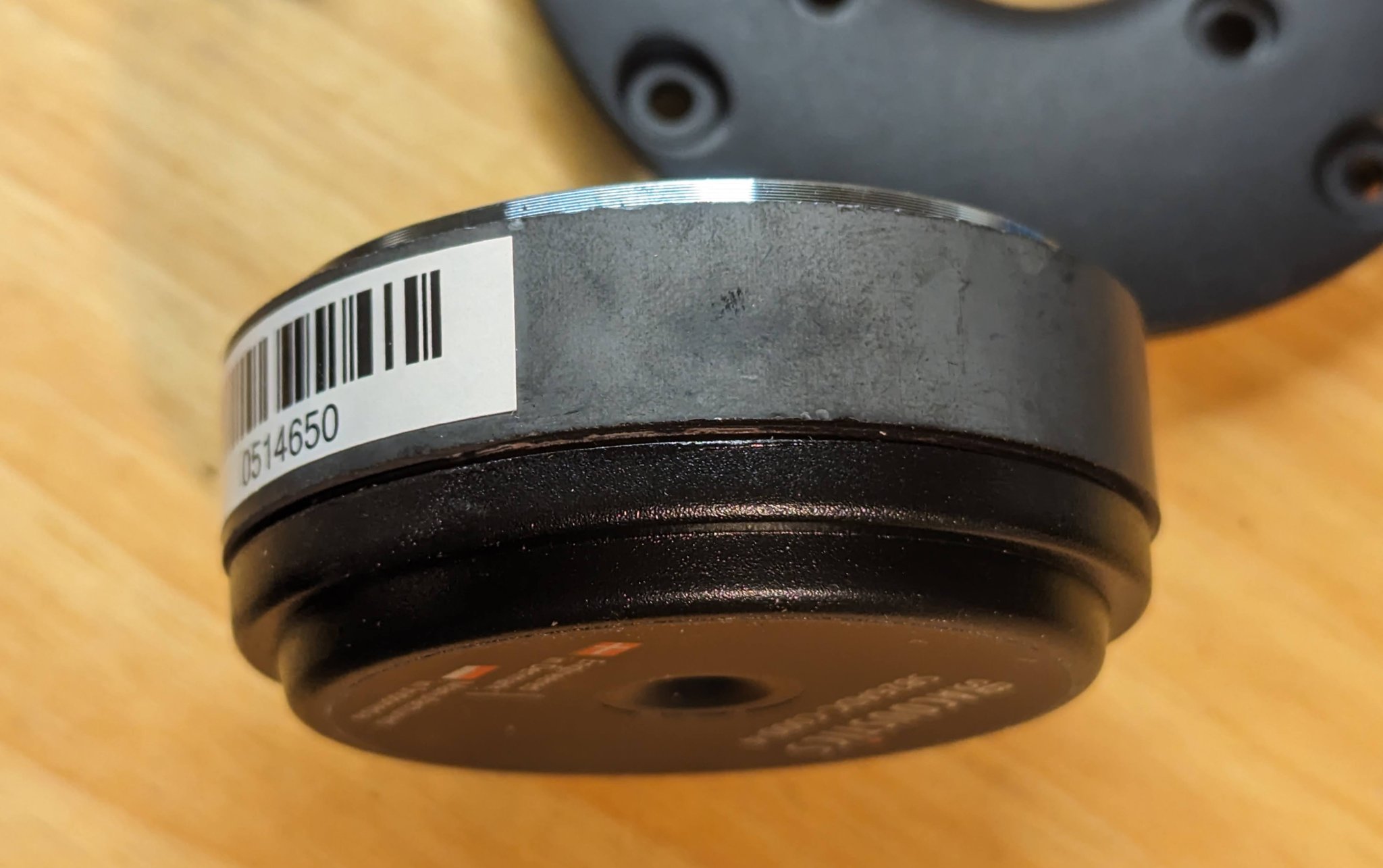

So I did exactly as you suggested & retested with foam + meta-absorber. Virtually no change in DATS result.I would use blue tack putty to seal it, then wrap electric tape around the outside to fasten everything together.
Tried changing the foam to a small ball of wool. Again, virtually no change.
Tried without any back at all -- wide open without foam. This dropped Fs to 350Hz. Foam changed impedance at Fs from 6.56 to 5.37 ohms.
All the post-mod results showed the same small peak at 1.2 kHz about 0.5 Ohms above the stick curve.
Possible reasons for the additional peak:
1. Some subtle damage/change to the dome, VC, former and/or slot?
2. This wrinkle is native to the moving assembly & is compensated by the stock back/wool?
Finally, I took the part that I cut away from the stock back, lined it back up as best as I could, and taped it up back to some semblance of normal: Amazingly, the 1.2 kHz disappeared, and the DATS result ended up being nearly identical to before the mod.
This suggests I should try to replicate the foam lining from the stock back cavity to eliminate that 1.2 kHz peak.
@Patrick Bateman -- Did you test your meta-puck modded SB26? Did you notice this phenomena?
Interesting. That it has the peak even open back should help point to the possible cause.
This suggests I should try to replicate the FELT lining from the stock back cavity to eliminate that 1.2 kHz peak.
Some (Helmholtz?) resonance could be at play here. The hollow pole piece being the duct. You showed that the original chamber has a sort of cone that just might broaden that resonance.
@Patrick Bateman replicated that cone in his mod. The extra resonance doesn't look good, but whether it needs a solution will be clearer after I do some FR runs. I expect I'll be playing with different stuffing if it proves to be problematic.
