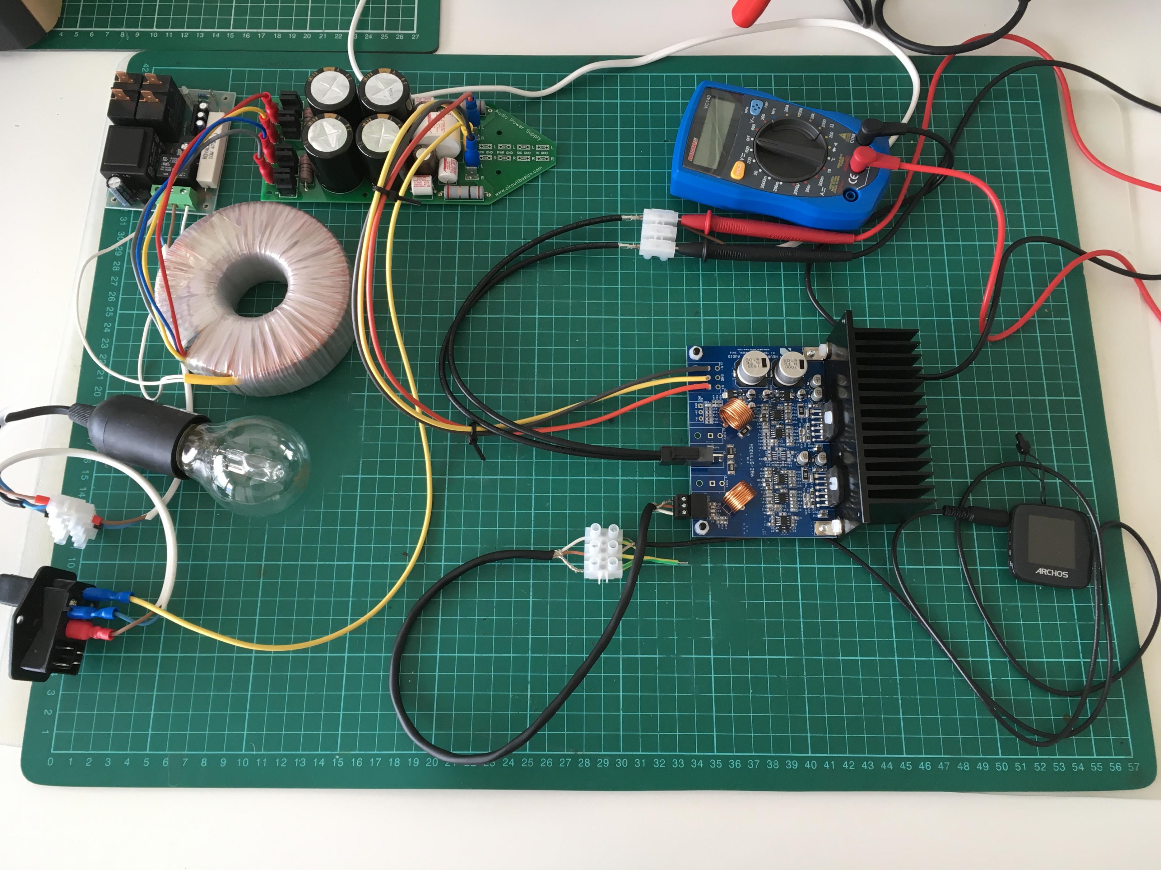

... nothing really exciting happening today as I am laying out the details of the housings ..therefore let's recap some of the experiences over that past week for those how are also new to the diy audio field and want to follow a similar path to a Mod286.
Equipment:
You only need a voltmeter.
No need for an LC-Meter to test the inductors. Just follow the instructions in the from Tom provided description. Also as Andrew and Tom pointed out earlier the values aren't super critical.
Also no need for a function generator either, as the manual give you a link to generate and download a 400Hz test tone, which you then can play from a MP3 player connected to the input. (It might have been a different story if I had run in trouble and would have had to do some error finding).
Soldering:
A decent preferably temp controlled solder iron. I used a 1.6mm chisel tip for the smd work (correction from an earlier post where I mistakenly wrote 0.6mm) and a pencil tip for the diodes and opamps.
LM3886 mounting & heat sinks:
As pointed out above the heatsinks in the pics are too small and for testing only.
Before soldering the two LM3886, I bolted the Mod286 pcb to the heat sink, loosely dropped in the LM3886 (without soldering yet) and also bolted them to the heat sink. Use metal screws (e.g. M4 will work for the metrics guys among you, don't use nylon screws - Tom thanks for the hint). Now the everything is tightened, solder the LM3886s.
Power Supply.
Please find attached a pic of my test setup. It uses both trafo and power supplies from a previous audio project of mine. I also got two boards of the matching Power86, which I will complete later. The manual and Tom describes the selection of power supplies and trafo in detail.
Because it's from an earlier project I'm using a 2x22V, 160VA trafo. Ideal would be a 2x25V, >200VA trafo, which I will get as soon as the amp tests out ok. I am using the Amplimo trafos (from NL) which generally ship cheaper within the EU as the Antek trafos.
Softstart and DC protection:
As you see there is a trafo start up board connector between mains in and trafo. It's most likely not needed for the Trafos of this size. This particular model also serves as a DC protection circuit. However I don't really like it because of the possibly sound affecting two relays and the DC sensing wire running back from the speaker ground. Tom if you can ever design a good circuit for DC protection, I would appreciate the additional insurance for my valuable speakers.
Ah before I forget... use the light bulb as a safety device and current limiter when hooking up everything the first time ... Google if you don't know how to rig it.

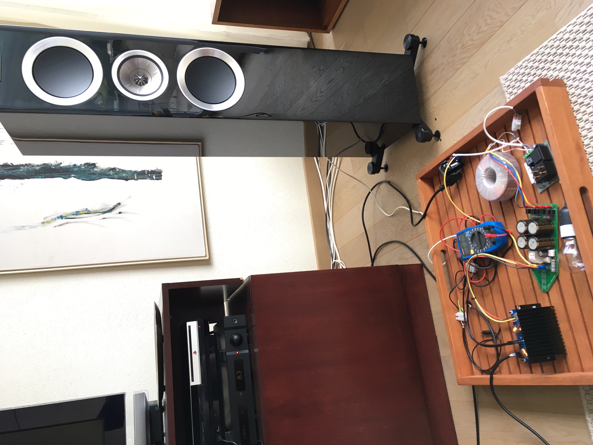

Today I ran a first test with one of the big speakers KEF R700 and not with the old dispensable JBL. I even hooked up the Altair via a XLR connection to check the SPL. I had to crank up the Alttair to about 80% (on an scale from 0 to 100) to get to my maximum desirable listening level. Is that ok?
Remember the test setup still uses the 2x22v trafo per channel and not the maximum possible 2x25v. Also with the Mod286 one can decide very conveniently on the gain of the amp. Several options can be realized by just switching or leaving out two resistors (even only one for the mono Mod286). My two Mod286s are currently built with 20dB gain.
The specs of my Auralic Altair list the max output voltage on the XLR connectors to be 4Vrms at 0dBFS.
The specs for the Mod286 say that for gain option 1) with 20dB gain the input sensitivity is 2V and for option 2) with 26dB gain it is 1V.
Now how do I have to read this information? For example are the 2V input sensitivity for option 1) equivalent to the 4Vrms output, because the 2V input are to be interpreted as +-2V and therefore are 4V peak to peak. Or is 4Vrms the output overdriving the input by a factor two?
Key question: Which gain option is best 1) or 2) for my setup?

I read your words, but sorry I don't understand how to apply your info to my problem.
1) Am I driving the Mod286 with 20dB gain into clipping with the 4Vrms output from the Altair?
2) Or am I driving my amp just optimally as it has a sensitivity of +-2V (in the 20dB version)?
3) If not 20dB, what would be the optimal amp gain for my particular setup?
Sorry for the noob questions.
Thanks a lot.

putting 4Vac into a +20dB (10times gain) amplifier will result in an attempt to produce 40vac (56.5Vpk) at the output.
Clearly the amplifier cannot do that.
Tomchr specifies the sensitivity for maximum output as 2Vac and this will give 20Vac (28.3Vpk) at the output.
You control whether the amplifier replays cleanly or clips by setting the vol pot to a sensible level. That control is the responsibility of the operator.

Oh boy. This is embarrassing. It's that easy. Thanks Andrew for opening my eyes. I guess I will do some measuring to determine the maxi setting for the DAC output knob. I fear though given the test yesterday that the amp will not nearly have enough power for my speakers :-(. It was set yesterday at 80% (although I don't know if it has a linear scale) and I believe I already heard some clipping while the average sound level was at the upper limit of my listening level.
