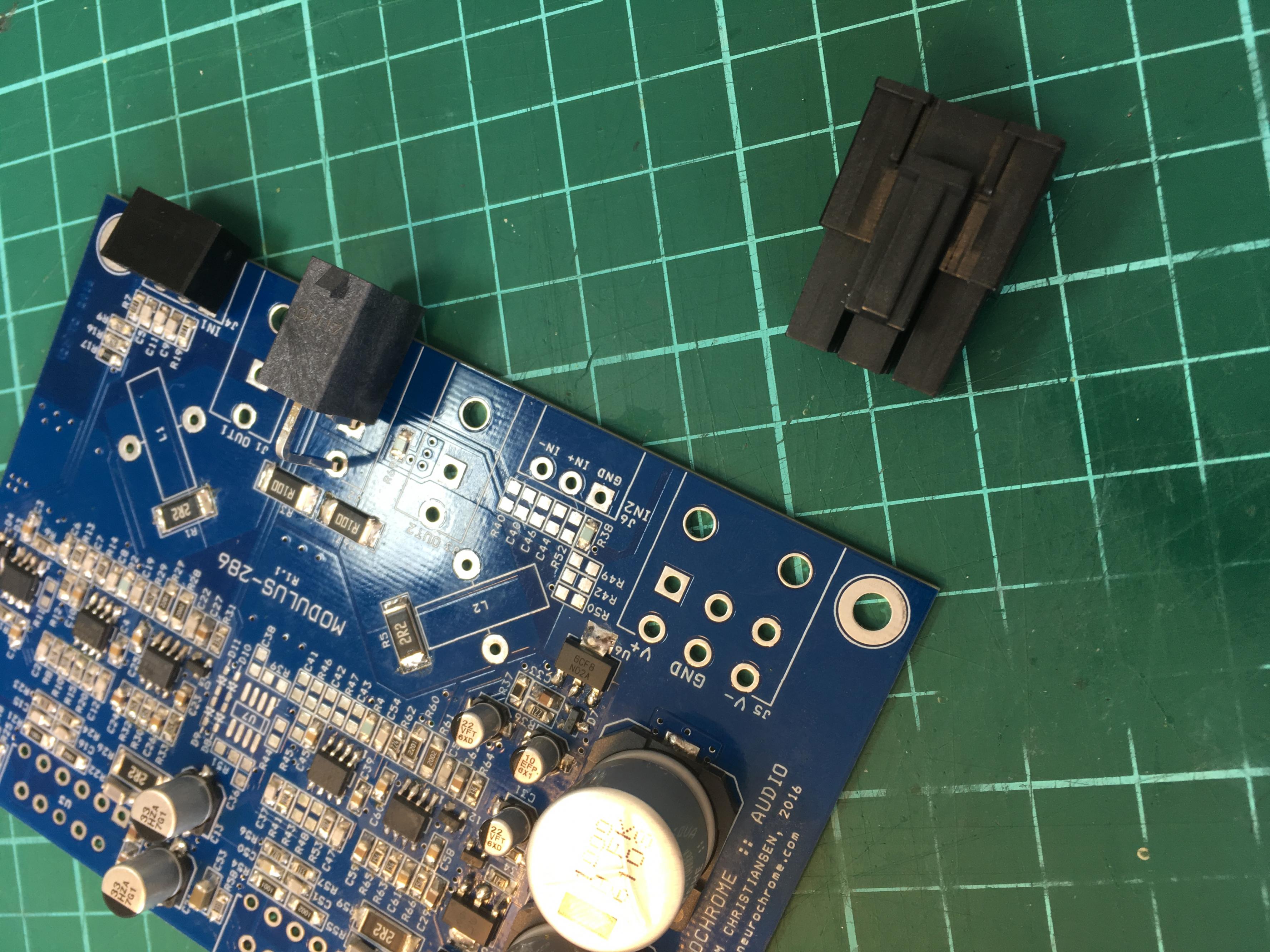

.... almost done just the inductors and the connectors. Mouser has this female connector for the power connection to the board on backorder and didn't deliver the two parts to me. Anyone having an idea for an alternative?
The male connector (see pic) I have.

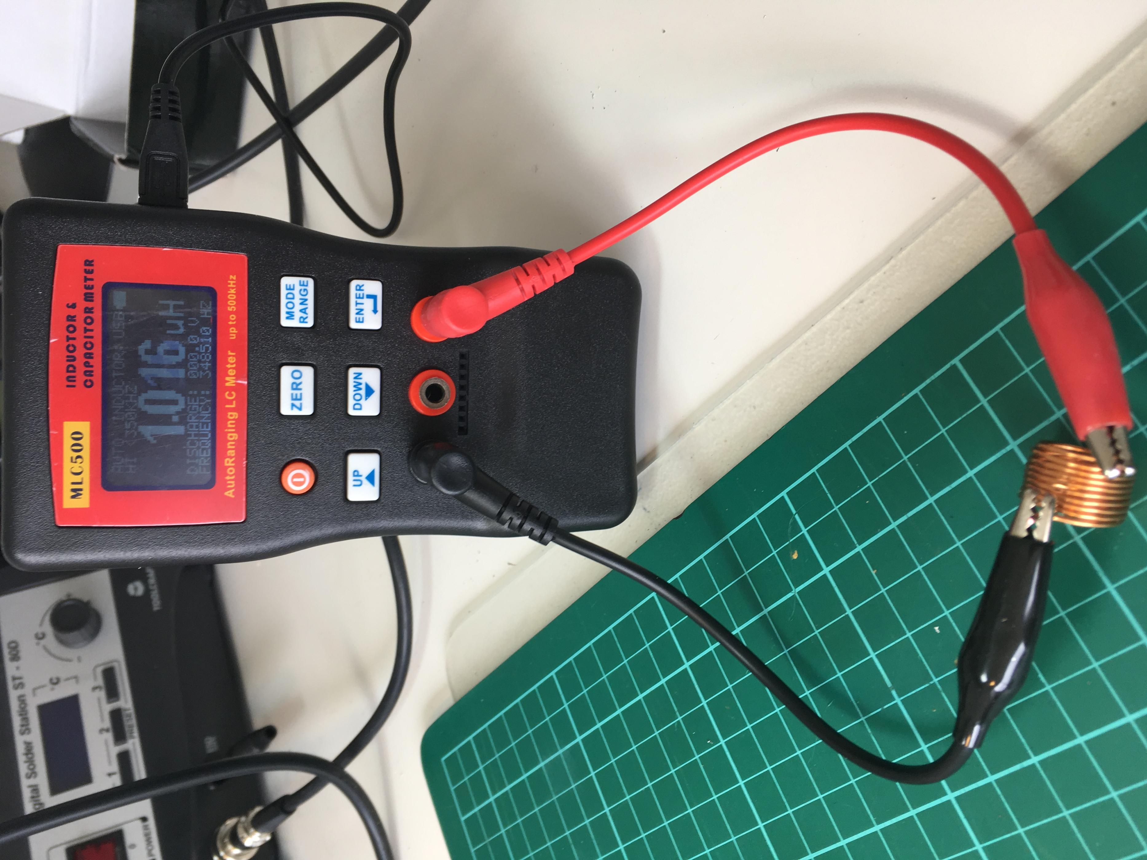

As for the inductors, I didn't hit quite the specified value (ca. 8-9% below). despite following the instructions closely. At least, they were all within 3% of one another. Of course, it could also be that my cheap tester isn't too accurate. What do you guys think - close enough or should I redo them?
Mouser is out of stock with an expected delivery date of August 21st. Digikey has it in stock. I'm about to place an order with Digikey. Let me know via email if you'd like me to get a pair for you and mail them.
You're fine. The value isn't super critical.

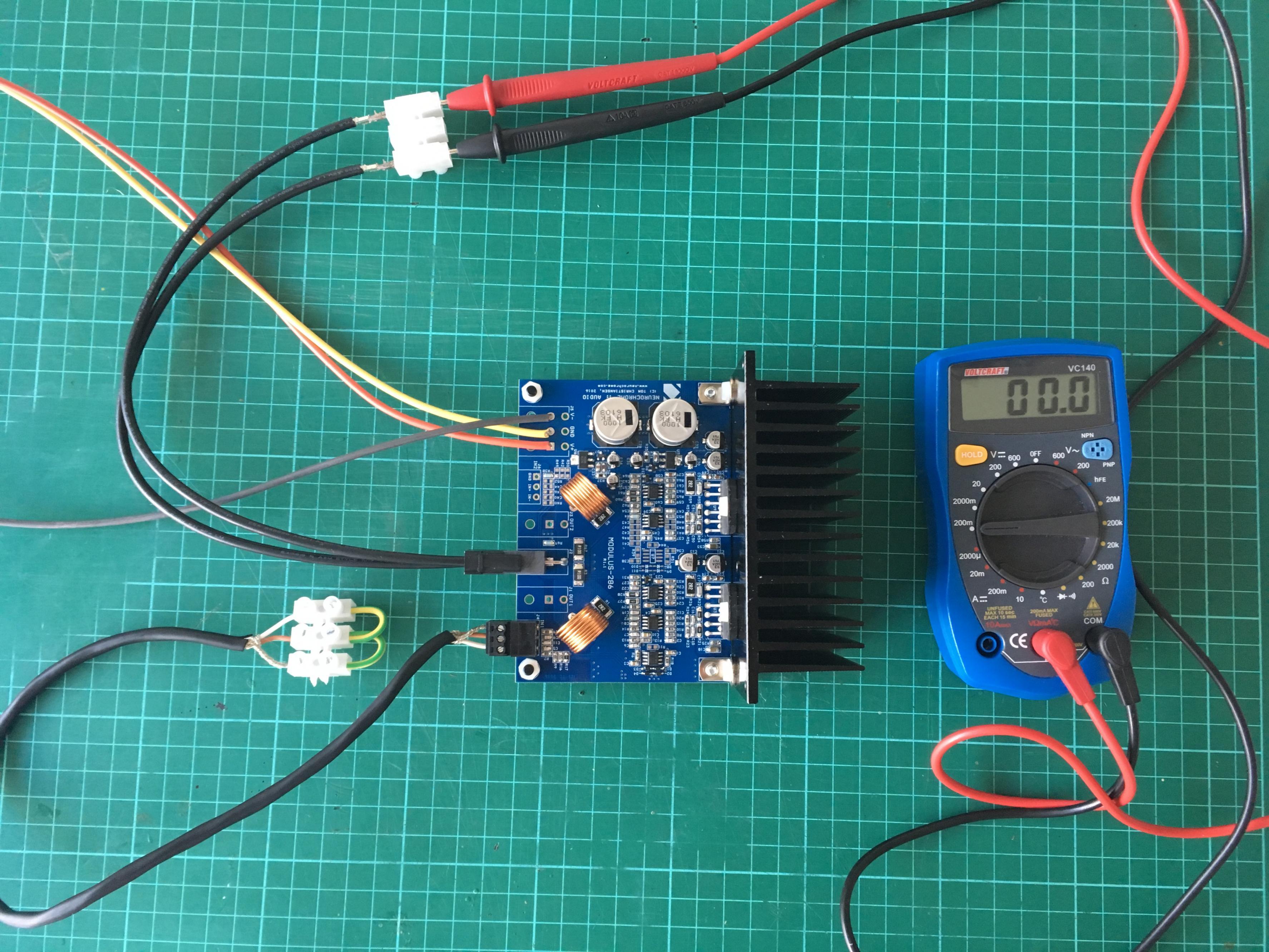

:). First hot test of the first board. Magic smoke still inside. Output offset measured with the shortened input pins. 0.00mV. :).
Now some barbecue... and possibly the 400Hz test later. Wish me luck and certainly a healthy appetite.

Ah. No more 400Hz test today.... I am tired. Besides I am not 100% certain how to hook up the function generator to the input and before I mess something up I better think twice about it.
Do I hook up the minus from the function generator to pin 1 & 3 and the plus to pin 2? Or do I leave pin 1 (gnd) floating?
Tom you got mail. I appreciate it. Thx.
So I see. I'll get with Digikey shortly and keep you posted via email.

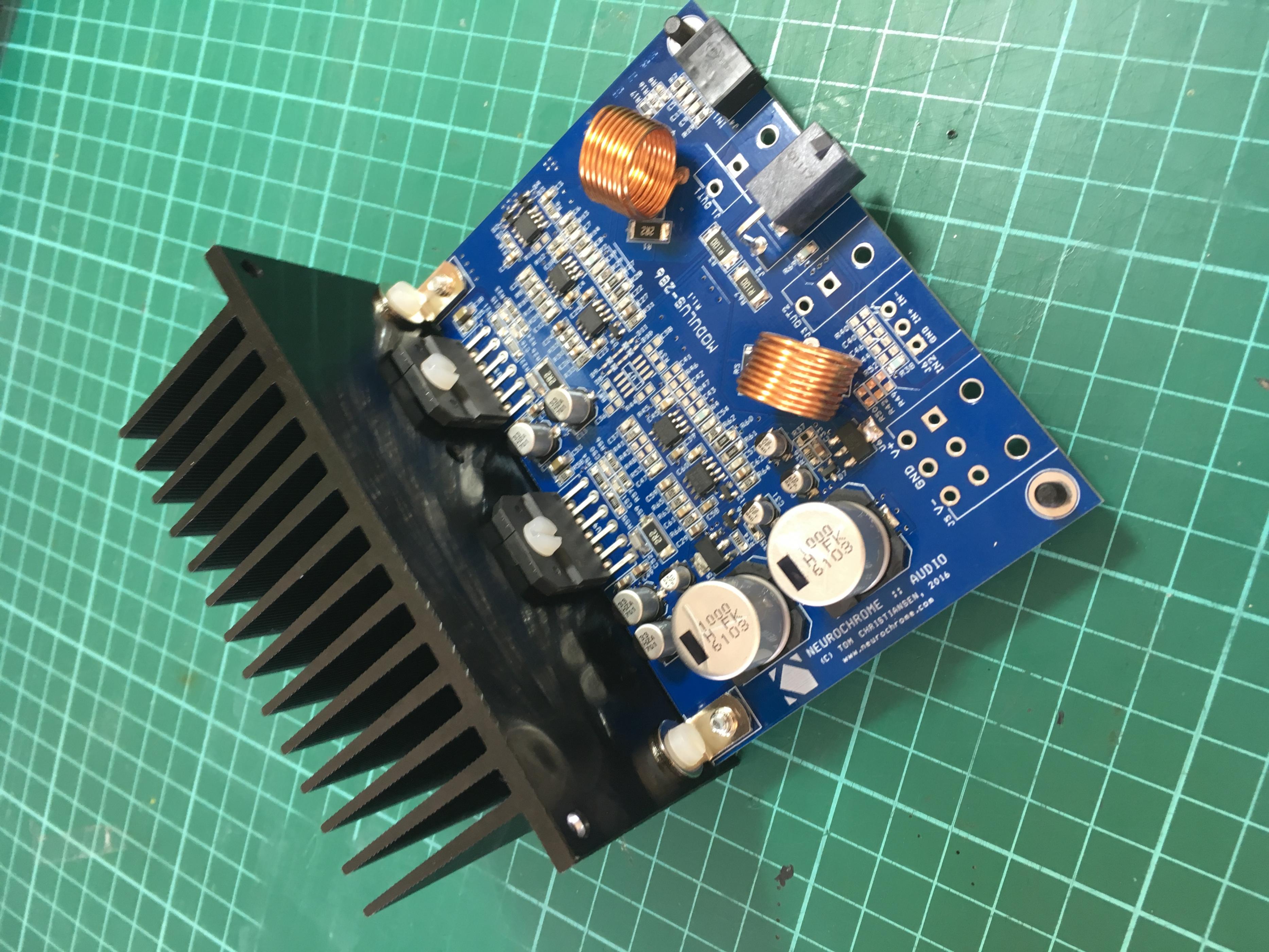

... again some progress.... now mounted some heatsinks for testing only. There probably too small and I haven't applied any thermal paste yet either.
Nice progress. Yeah. The heat sink is too small for actual use but fine for testing. Scrap the nylon screws, though. Nylon will stretch and result in a poor thermal connection between the IC and the heat sink over time. This will cause an increase in THD. Just use regular metal machine screws. The IC package is isolated so you don't have to worry about short circuits there.
Yep. Exactly like that. Unless your function generator has balanced out (which few of them do). If your function generator has a 50 Ω output, I recommend terminating the cable into 50 Ω (so connect 50 Ω - or 49.9 Ω - from pin 1+3 to pin 2 on the MOD286 input). The termination isn't so critical with sine wave testing, but should you decide to try a square wave, you'll need the termination.

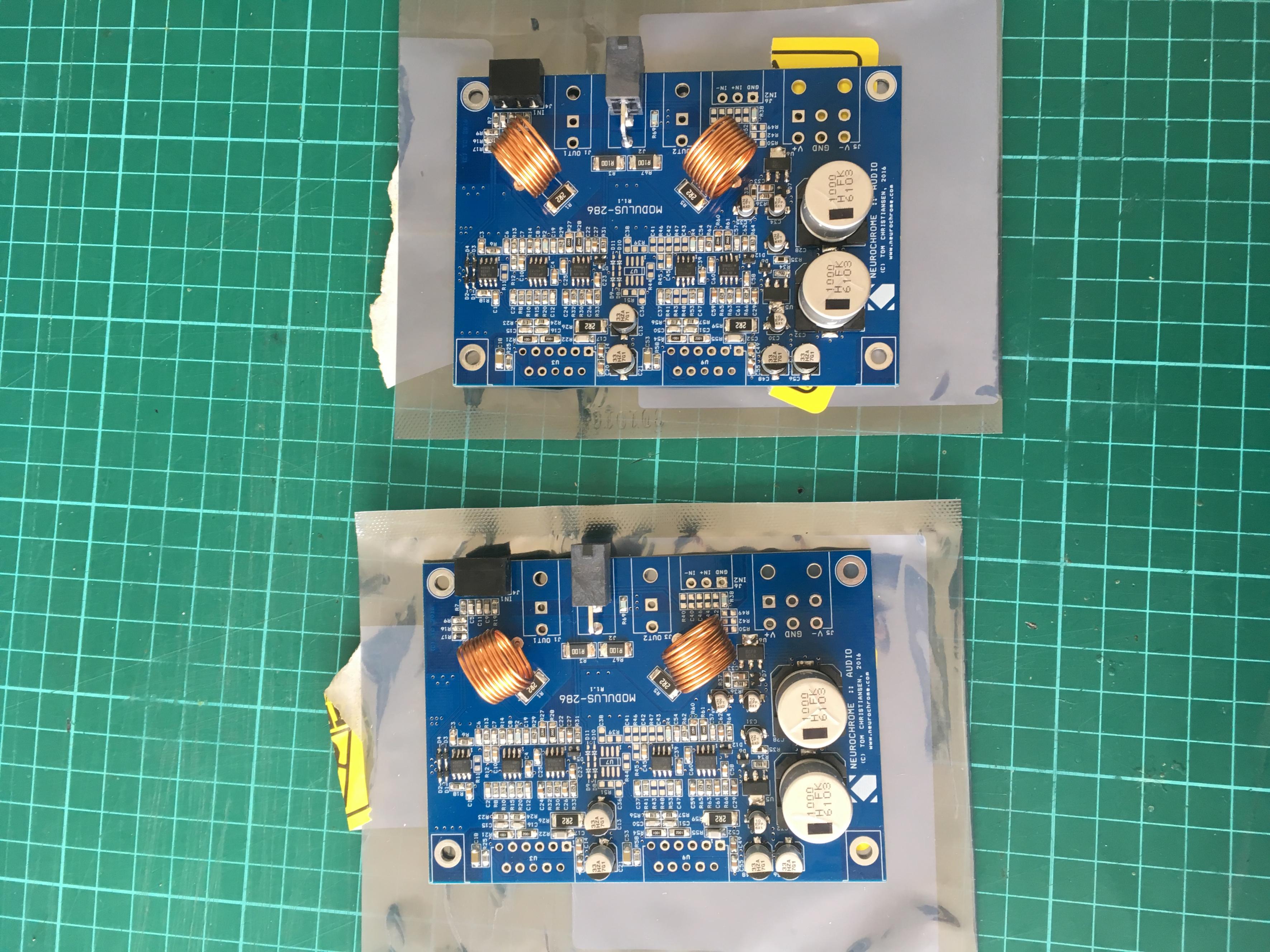

Hey guys. I didn't do these tests, as I am not even sure how to conduct those. I just followed the final checklists in the Mid286 manual and after passing, hooked up the old (dispensable) speaker. And tata it worked. Meanwhile I did the same with the second board and it worked too right of the bat. :))) I am very happy that everything went without a glitch.

If you have assembled the board according to the BOM, measure < 1 mV of output offset, the amp has the expected gain, and it sounds great in your test speaker, I'd say you have a successful build. Enjoy the music.
If you want to admire the technical performance of the amp, press on with the tests that Andrew suggested. They are by no means required, though.
