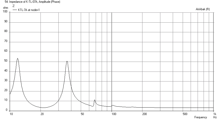

I know you have been waiting for this... the MOAK version 1 with dual TDM15H's does a respectable job as a sub.
I scaled the height and depth by 2.5x, and the width by 1.5x, and enlarged the vent connecting the front and rear chamber by 2.4x.

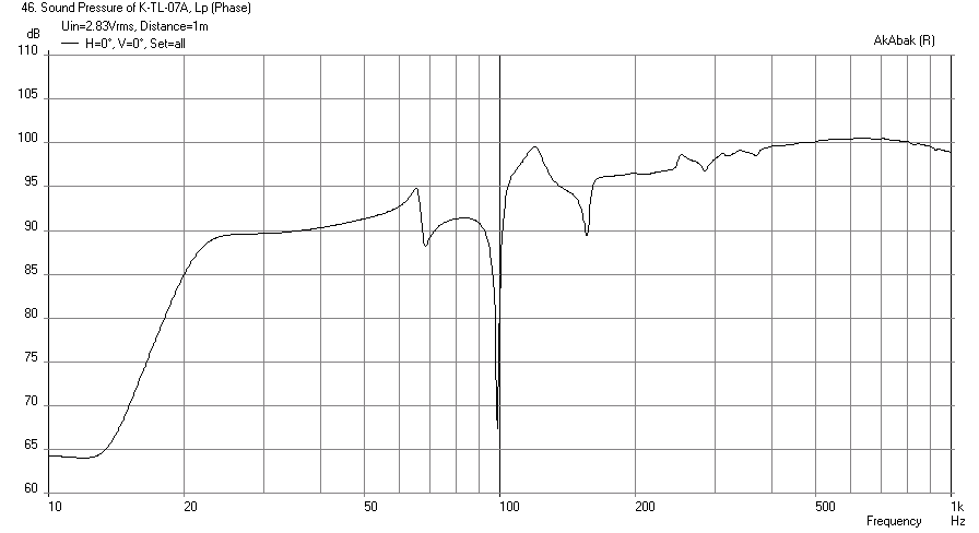

Here is SPL vs Freq for 2.83 volts:
Here is the Impedance:

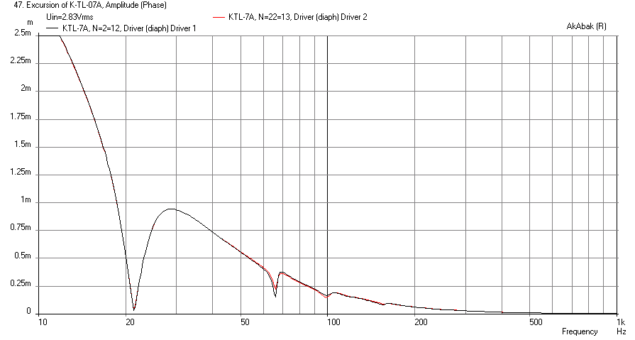

Here is the displacement:

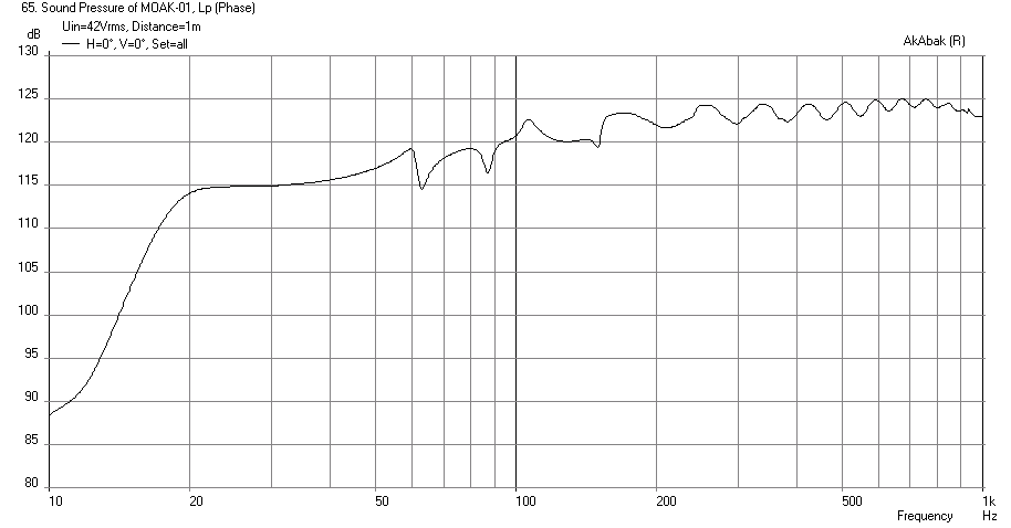

The 14 mm xmax is reached at 42 volts (440 watts into 4 ohm load), the corresponding SPL vs Freq is here:
The bass extension (-3 dB point is 20.5 Hz) - not too bad... 😀 the efficiency could be better as this is not an optimized design by any means.

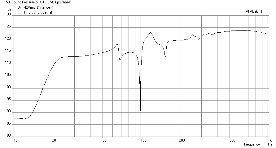

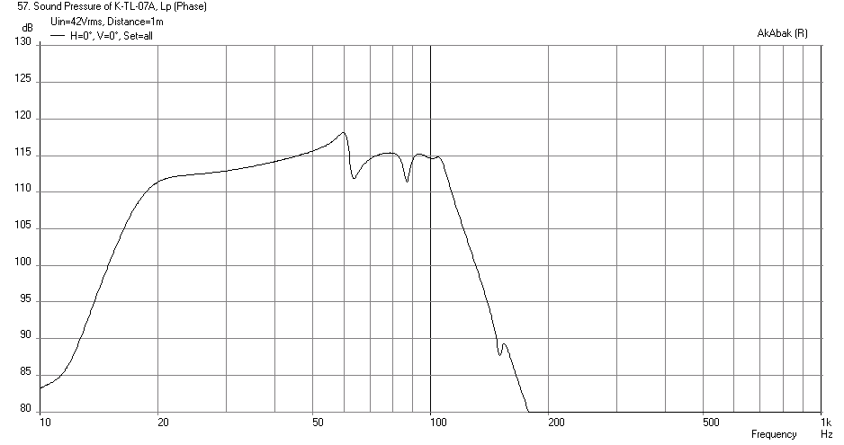

Interestingly, playing with the Karlson aperture and making it go to a zero width cusp vs a finite width, reduces the peaks but efficiency is somewhat reduced:

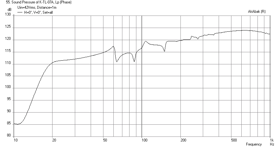

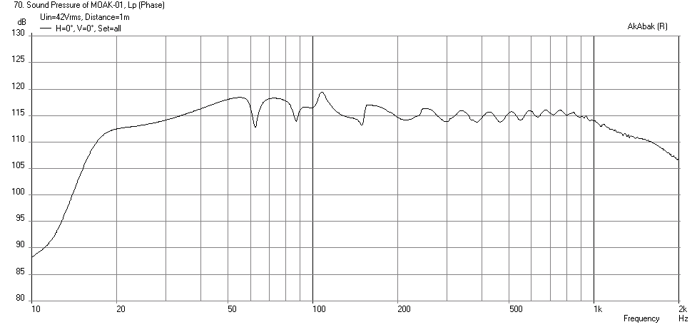

If you apply a -24 dB/oct Butterworth high pass at 10 Hz and a -48d dB/oct Butterworth low pass filter at 100 Hz, here is what you get:

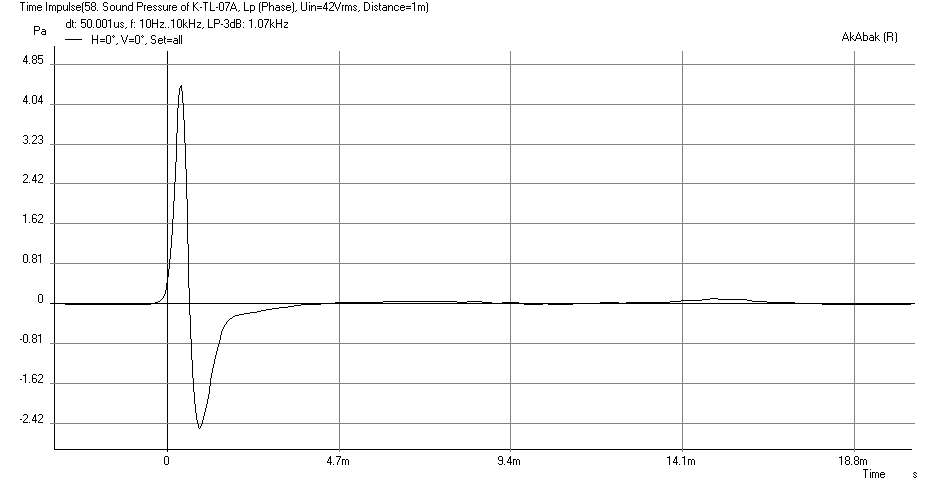

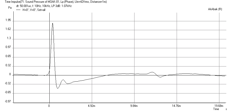

If you were to run this speaker in fullrange, here is the impulse response it is capable of producing - about as good as a sealed box with a 0.47 ms delay:
2.5h_1.5w_2.4vent-Karlsonator-Dual-AETDM15H-Impedance.png26.3 KB · Views: 923
2.5h_1.5w_2.4vent-Karlsonator-Dual-AETDM15H-Freq-1m-at-xmax-42volts.png27.1 KB · Views: 924
2.5h_1.5w_2.4vent-Karlsonator-Dual-AETDM15H-Freq-1m-at-xmax-42volts-zero-point-slit.png26.8 KB · Views: 1,179
2.5h_1.5w_2.4vent-Karlsonator-Dual-AETDM15H-Freq-1m-at-xmax-42volts-zero-point-slit-HPF-LPF.png27.9 KB · Views: 2,651
2.5h_1.5w_2.4vent-Karlsonator-Dual-AETDM15H-Impulse-at-xmax-42volts-zero-point-slit.png18.8 KB · Views: 910

According to your own sims, the Karlson with the cusp aperture goes lower:
Normal:
With cusped end:
Is this correct?
Normal:
With cusped end:
Is this correct?
Yes, it has the same effect as extending the path length because there is less "leakage" at the end.

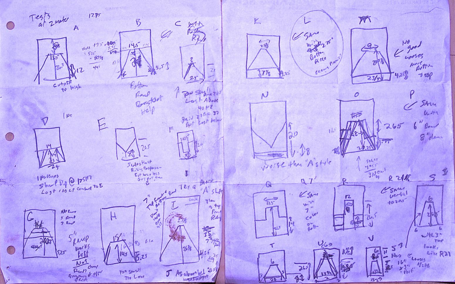

I learned over a decade ago htat the original Karlson K15 of 1951 had virtues and subjectively sounded better than a lot of mediocre Harmon products🙂
hak6.5 build by AmadeusMozart - the design is based on one of Carl's builds
one of Carl's test boxes loaded with an 8

Non-flat because you see ripples and dips and peaks that are +/- 3dB - a very good performer for many speakers and especially given the broad bandwidth. Here is what this speaker can do in a wide band application with the addition of a 6 ohm + 10 mH BSC circuit (or EQ'ing):
Can you find another speaker with high SPL capability that has -3dB point of 18 Hz on the low end and goes up to 1.16 kHz on the high end? That is 6 octaves!
Add a horn loaded CD tweeter and you have a nice 2-way that can rock the house (or stadium).

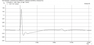

And here is the corresponding Impulse Response for this setup:
